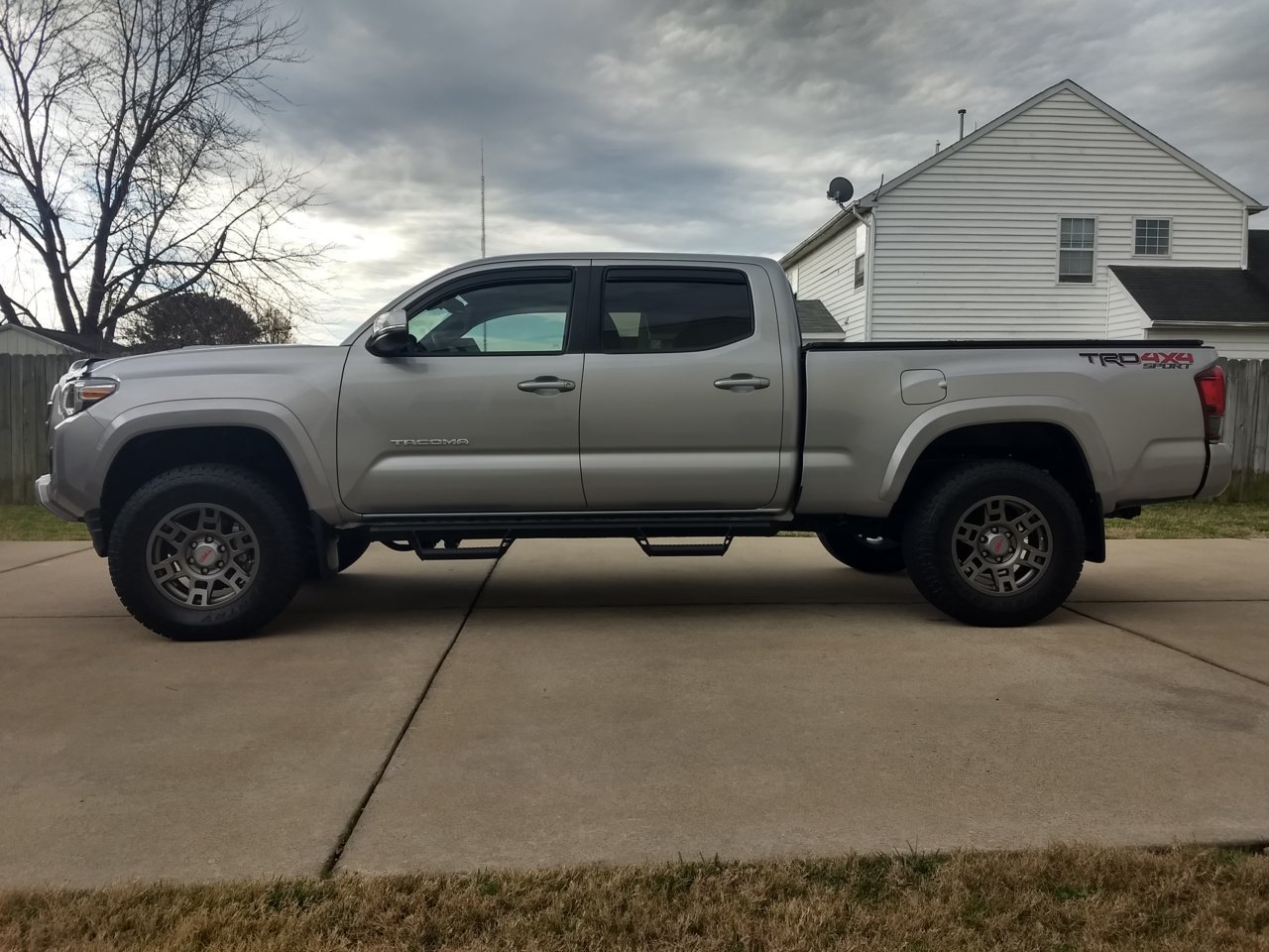

    Bilsteins 5100s on the top setting, 4runner Gray TRD Pro Sema wheels, 285/70/17 Toyo AT3s, Sumo Bump stops, TRD exhaust, ECGS Clamshell bushing, 1/4 shim for the lean and one inch rear block, OEM Pro grill and garnish OEM TRD Skid plate, TRD CAI, Demon Brackets, Rigid Industries Pro fog lights, OEM Trail Rails sidebars, Diode Dynamics LED SL1 high and low beam lights, OEM Roof racks, Clazzio leather heated seats, Remote Start, TRD Pro shift knob, tinted windows, Rockford Fosgate 4 channel amp for the headunit and sub and amp combo, OEM Puddle lights, OEM tailgate lock, OEM bed mat, LED interior lights, OEM blackout kit for letters, JLT catch can, upgraded 27F toyota True Start battery, Vleds led tail light kit with Pro tail lights, OEM Rave4 side mirrors with convex spotters,just to name a few mods.
    4th setting here, one inch block. Looks better imo. Love the stance,ride is smoother than my original spot ride, plus it looks awesome!IMG_20190101_121024134_HDR.jpg

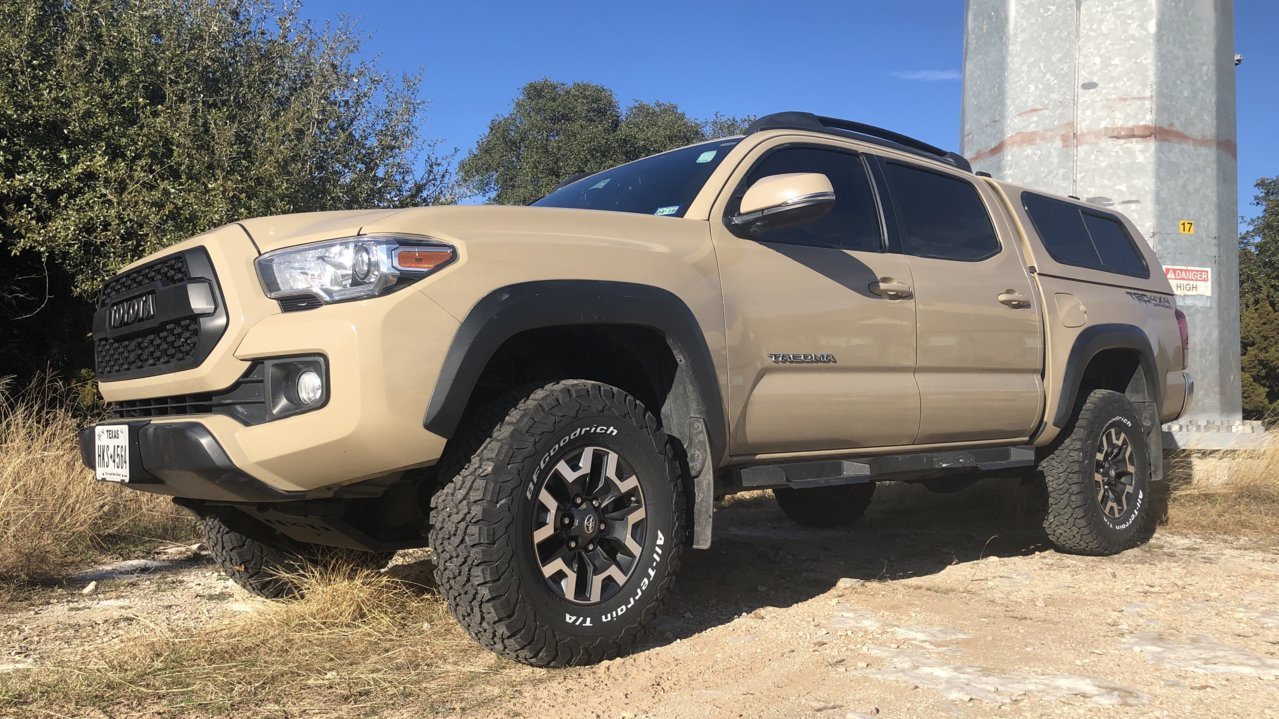

    I bought a set of 5100s when I bought my truck. Waited until the factory tires were gone before I installed them, so I just opted to replace the springs and install add a leaf at the same time. OME 885 Springs in the front and a set of $60 add a leafs for the back. Money well spent in my opinion. Really no negatives to report at all. Going to a larger E rated tire and lifting 2” cost me about .5mpg and the ride is improved on and off road.

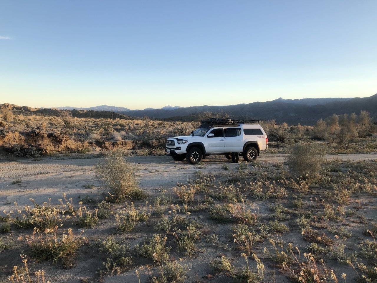

    5100 ‘s 4th clip up and single Deaver AAL with stock coils. Good ride on and offroad too. I tow and haul a lot of weight, so also added airshocks too:
