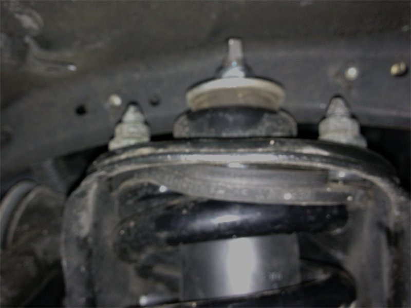

    Just did 5100s up front tonight @ 2.5" with another TW member's assistance. I noticed the clunking immediately and got out at the end of his driveway to realize I didn't tighten the four bolts that hold the middle parts of the sway bar. Everything else in the wheel well including that one sway bar bolt tightened properly.
    Tightened those four bolts and it reduced whatever noise I heard for the first 300 yards driven on the truck. It's still pretty clunky n clanky though.
    +1 for this question, amazed that someone else posted this EXACT same problem about an hour after I first noticed mine. I was worried I'd have to wade through thousands of search results for "5100 noise" and weed out the millions of vibration threads.
    Only thing that doesn't look 100% right is the drivers side rubber top thing that spring goes in to. The passenger side is perfectly level across, the driver side is a little fudgey as seen in pic. While I'm not sure if this is abnormal or acceptable, it doesn't seem to be the culprit as the clanking isn't JUST from this side

    I would def take that off and fix it, could be tweaking the spring

    Hour my passenger spring made the rubber piece look like that as well but wen I put it in place it corrected itself u may want to try to take it back of and reposition it or rotate it and put it back this fixed mine it is even throughout

    Shat. It was getting dark when we re-did that side due to a forgotten washer. Spring was definitely put in right side up (flat side up) so Idunno, must have just kept jacking up LCA to get top shaft through hole and not seen it pinch. This was done with the no-spring-compressor method by the way.
    Anyway, guess I'll take it out tomorrow and reinstall, the drivers side third time going in over a 24 hour time period. After doing the first side (again forgot washer this time), the next side took 20 minutes. Redoing drivers side then took 10 minutes. If it takes me less than an hour alone tomorrow with no air tools this time I'll still be happy.
    Not to thread hijack with that, but since the 'noise' isn't coming from this side necessarily and people who don't have my above problem still have clunking - the quest for answers continues.
