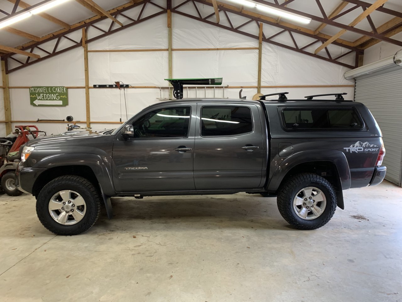

    CC21DAA9-B480-4EE0-B41E-43336C7C571C.jpg I am 2 weeks in on OME 885’s and 5100 set on zero. I got 2 inches in the front and a better ride than stock
