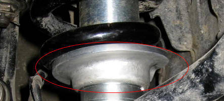

  16. May 6, 2010 at 6:47 AM
    #16
    Simon2150
    Simon2150 Well-Known Member
    Dec 22, 2008
    #11809
    1,044
    Austin, TX
    06 Tacoma DoubleCab V6 SR5
    look up under your truck, this is the spring seat installed upside down

    Checked that- thanks. We found that they are installed correctly and it's just my TSB that didn't add quite as much height as others. At 1.75, the truck was a tad higher on driver's side and .5 inches higher than that on passenger side due to the driver's side lean.
