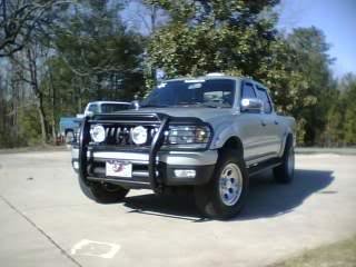

    ok i got to billys put on today....i set them a 2.5. I knew that the rear would sag a bit bit i didnt know that it would sag this much. i likeD the look of the rear sitting lower than the front but not quite this much. Im thinking about doing the AAL. is it an easy install? and a buddy told me about a 1inch shackle?? he drives a jeep so he dosnt know much about tacos but he did help me today. can yall tell me a little about the shackles? Heres a pic of the truck now....and tires to come. looks goofy now:mad:

    Why not re-adjust the 5100's to be a bit lower - and you won't have to spend any more money?

    I had the same "cali rake" when I first did my 2006 Taco, if you put an AAL or body lift, you can level it out pretty easily.

    If you put a body lift it it its not going to level it out.. your lifting the whole body front and back equally.. If your on a budget get a add-a-leaf. Shackles can cause more axle wrap. Dont get a block *Period* if you have the money get an after market leaf pack. If you wheel get deaver or similar of you haul OME has some packs.
    Just FWI your front will sag in a few months to about 1 to 1 1/2 inches over stock. Wait to see how far it settles before getting a rear lift or you might even be sitting ass high.. Just from my experience.

    I got my rear AAls when I bought my lift kit from ToyTech a long time ago. It came with Pro-Comp AALs then (not sure about now) and I think I paid around $250 for front coil spacers, diff drop kit, and AALs. They are real easy to install if you have any sort of mechanical knowledge. If you installed your 5100s on the front, you'll easily be able to put the AALs in. Just remove the 4 spring perch bolts on each side and the alignment bolt in the spring pack and jack up the truck from the rear bumper to get the springs off the axle. Slip in the AAL and install the new spring alignment bolt and you're pretty much done. Bolt everything back down and torque to spec. Note: My kit came with a bracket to raise the brake line that mounts to the rear axle. I don't know how neccessary it is, but you should ask about it when ordering your AALs.
    As for the ride quality, I noticed a little stiffer ride, but nothing too bad. You could do the shackle lift and retain your "stock" spring rate, but with the AALs you are able to haul more stuff in your bed w/o squatting down the rear of the truck as much.

    its a aries grill gaurd i ordered it from a local 4x4 shop. it was like $250 plus the $35 autozone fogs :cool:
