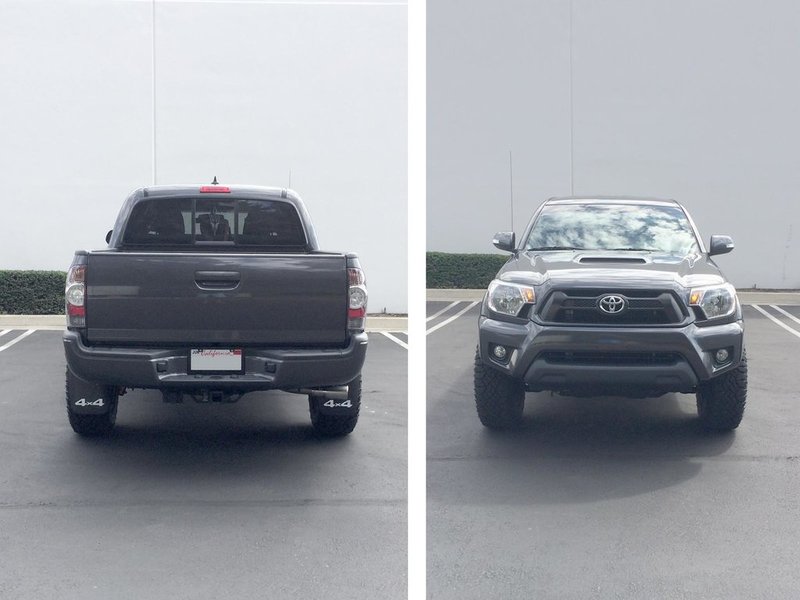

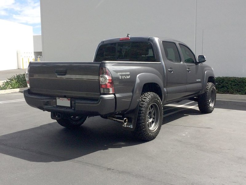

    Here is my original set up.
    2013 DCSB Trd Sport 4x4
    Factory wheels: 17" trd sport wheels
    Factory Tires: 265/70 17 Dunlop grandtrek a/t
    Factory Suspension: Front Trd Bilsteins and 4 Leaf Pack rear
    Leveling Experience:
    After countless hours trolling the boards here, I settled on the new tires, wheels, and shocks; this is my entry step as I'm mostly using the truck as a commuter with the occasional weekend trek out in the southern California deserts or mountains.

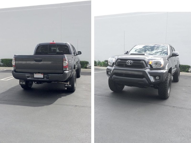

    The truck has a noticeable rake from the factory. Measured from hub centerline to the top of the fender (assuming the fenders are the same height) I got the following:
    Front: 20"
    Rear: 22"
    Bilstein 5100s:
    The product: The Bilsteins have a .85", 1.75" and 2.5" setting and are the recommended solution for leveling as it is configured for the best reliability and won't compromise the rest of the suspension performance.
    Selecting height: This can be a very subjective topic, some folks definition of 'level' can vary. BUT generally, this is what I heard (please take this with a grain of salt, just my 2 cents)....
    If you have the older non TSB 3 leaf pack in the rear - use the .85" setting.
    If you DO have the newer TSB 4 leaf pack in the rear - use the 1.75" setting.
    Also, if you have added weight in the bed, a cover, rack, storage or if you plan on towing, this can effect what setting to use up front. Again, just my 2 cents, you have to do you're hw....
    My setting: I chose to do the 1.75" setting since I have the 4 leaf pack and no extra weight in the bed.
    Supplier: I purchased the shocks through downsouthmotorsport, they we're very responsive and it ship within days. Also had the best price I could find.
    Tires:
    Without getting into tire reviews, the goal for my truck was to get a slightly larger, more aggressive tire that would work with the Bilsteins.
    Size: Seems like the unanimous vote for largest tire size without a lift is 265/70r17...at least for 17" wheels.
    Tires: pick your flavor!
    My choice: 265/70r17 Goodyear Wrangler Duratracs Load Range C, Black Sidewalls
    Wheels:
    Again, pick your flavor...My choice was Stealth Custom Series, Stealth 6 Matte Gunmetal.
    Backspacing: 4.3"
    Excellent wheels, excellent company and customer service, would highly recommend.
    RESULTS:

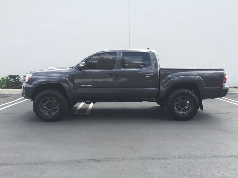

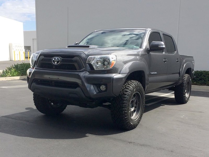

    In my opinion the truck is freaking level. Others may argue but I everything turned out exactly how I had envisioned. Overall its not a dramatic mechanical change but if you're like me...the devil is in the details.
    Level: The truck now measures level from hub to fender, both front and back. Depending on the ground and horizon sometimes it looks higher and sometimes lower in front; all depends on the environment, but on average it appears level, and others who see it for the first time see it as level.
    Front: 22" (again, this is with the 1.75" setting, so I may have gotten actually 2" out of it)
    Rear: 22"

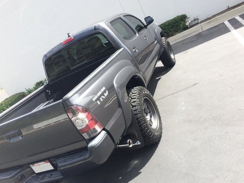

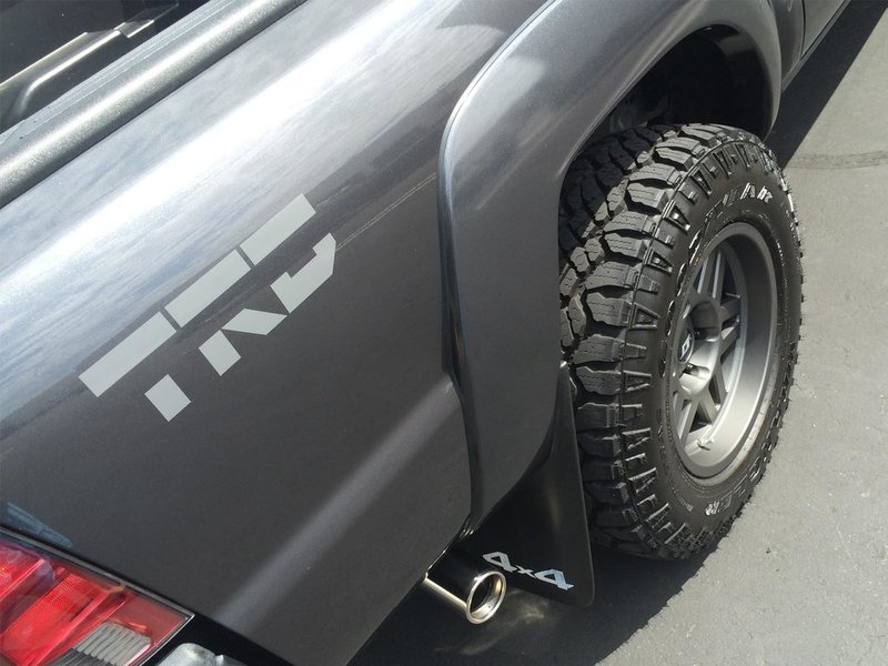

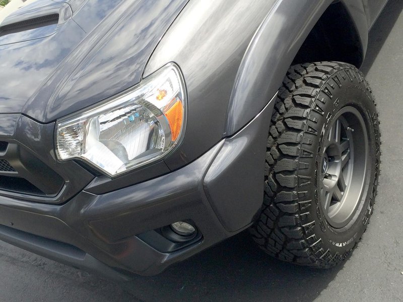

    Tire Clearance: The duratracs are wider at the shoulder so I did have to remove the front mud flaps. It rubbed pretty bad when cranked full, but with some light trimming I could put them back on. Once I removed them there is no rubbing at all.
    Wheels: The wheels are designed to bring the tire out just slightly and give the truck a nice wide stance...they've done a good job.
    In the end each case is unique but hopefully some of you can find this helpful.

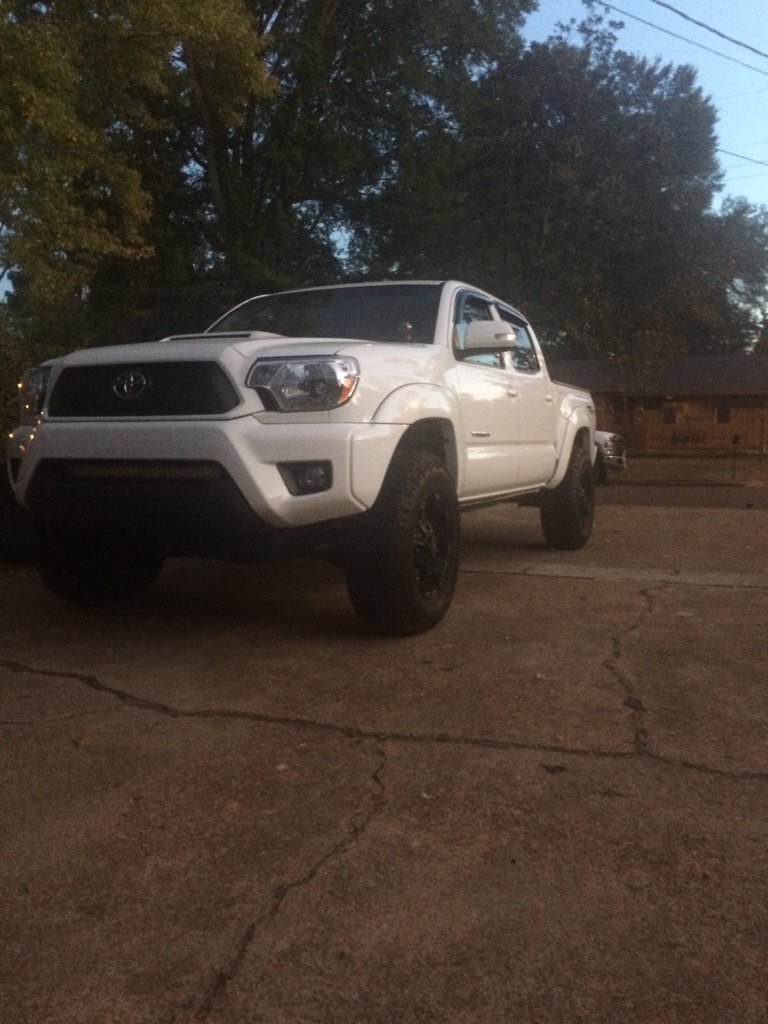

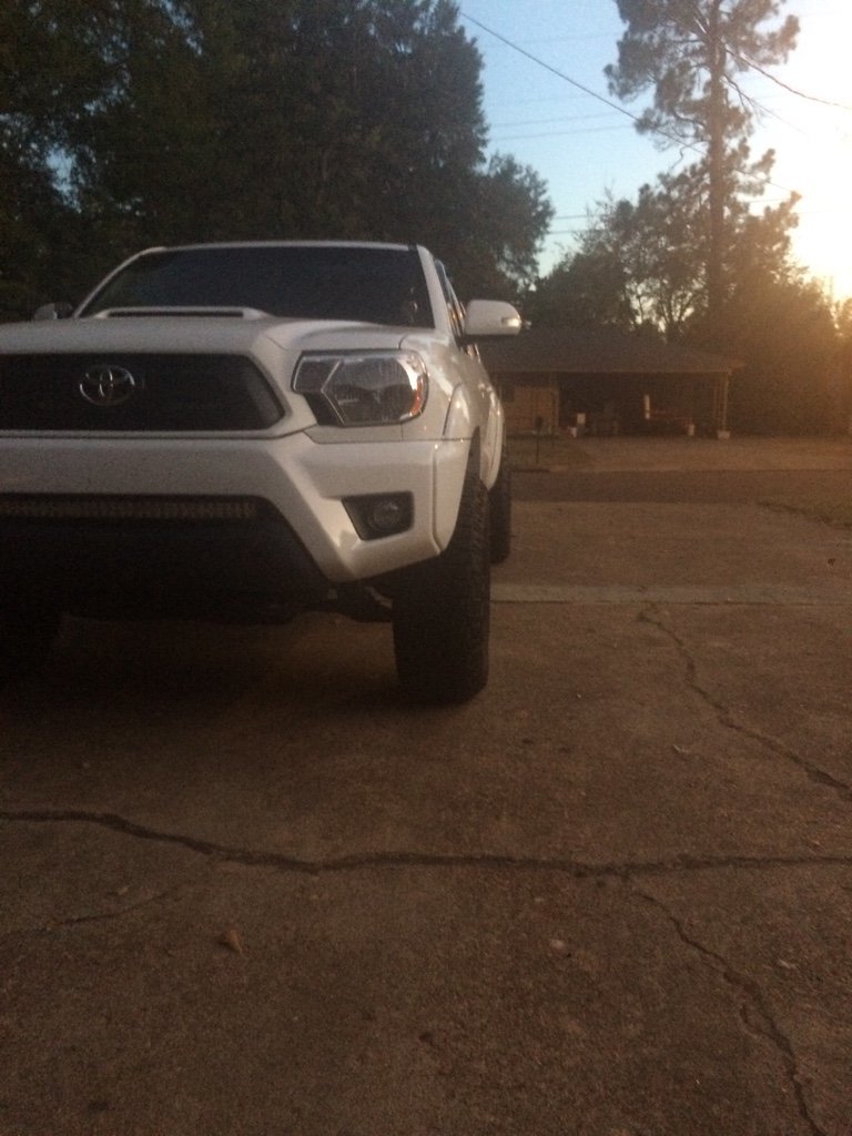

    Like the OP I Just added 5100's set at 1.75 with duratracs 265-70-17 on ballistic 17-9" on my 2014 sport 4x4 leveled it perfect as far as I'm concerned as I had a good rub before the instal. rubs gone now and love the look. Ride is comparable to stock. Stock coils no change to the rear.
