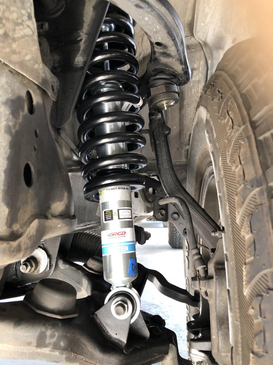

    BB5DC5D9-F8F9-4508-B12A-E105B580D4D7.jpg Hey TW my 5100's n 881's got me over 4"inch lift my rig is V62WD prerunner i have a 1/2 spacer on driver side an 3/8 on passg side guy at wheeler told me i wont get more them 3" inch lift :annoyed: is been a month an still not seatle a bit is this normal ?

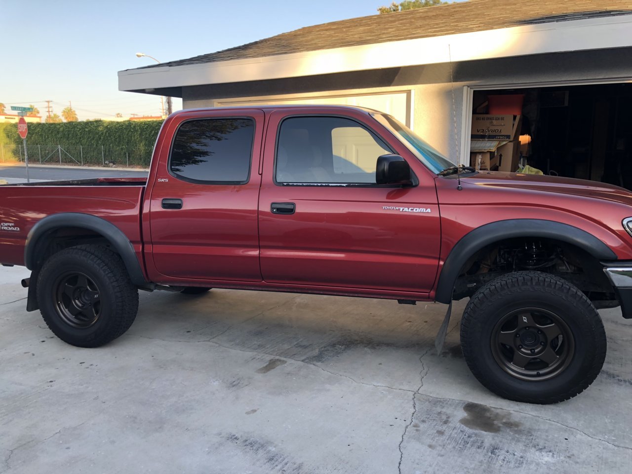

    Picture about now . I like it the ride is firm no stiff no UCA'S yet! Spring is at the bottom pirch got them assemble at wheelers .

    Make sure the coil seat on the struts are sitting the correct way and that is it on the very bottom notch (lowest setting 0). When I installed my 5100s, the driver side spring seat was installed upside down so the driver side was waaaay taller than the passenger. Once it was flipped It dropped a lot and was even to the other side.

    this is guaranteed the issue, the perch is either upside down or not at 0

    Ha!!! It looks good :)

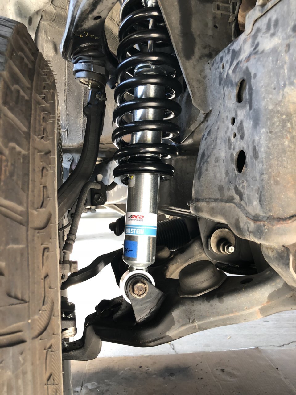

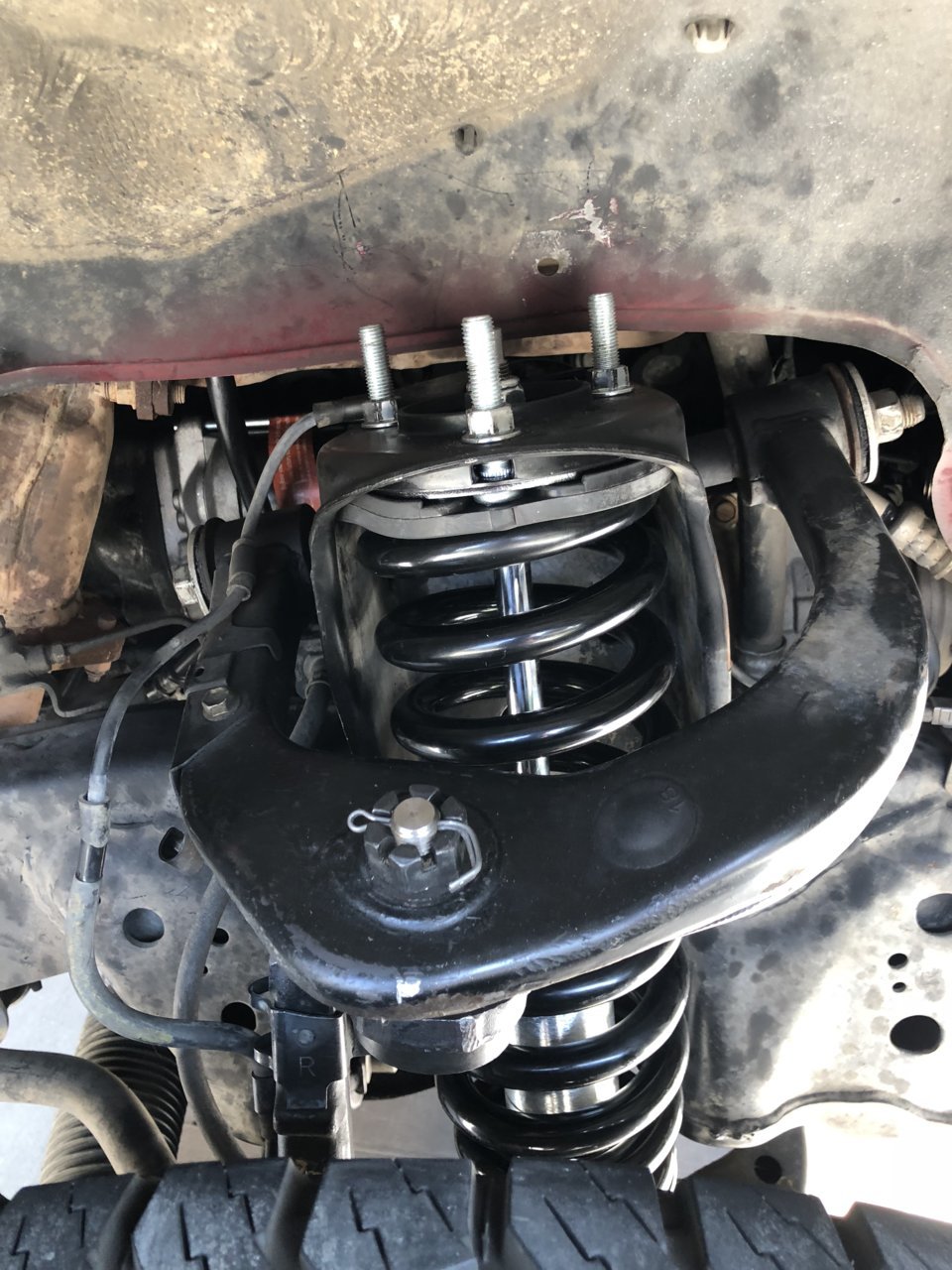

    E9F96E24-E848-4D35-A7A9-D690128955F1.jpg 5D38915C-A27E-41EE-9E4B-1DCF90E2E7B3.jpg 0152A1B2-0803-4633-AAE4-6E5708A0D4DF.jpg Thanks tacomike this came assemble from wheelers i check the noch is for sure at the bottom i think i got pictures ill loaded them i a few mins here .
    So this is not normal them to get this much lift on 881's ? No aim concern :(

    More pictures loaded

    Well damn now im confused, perch looks right notch appears bottom, im out

    That looks like everything is cool!! Hmmmmm

    Hey guys so yesturday got home an took some measurements an it went down 1 inch :thumbsup:
    Before the install
    Hub to fender was 21 1/4 front but passenger side was 20 sagging original suspension .
    Now hub to fender is 24" inch even as of yesturday .
    So now aim a bit over 3 " inch lift

    You have to account for sag when measuring stock. On a new truck not so much, but 15 year old stock suspension for sure. So like you’re experiencing, a 3” lift is over stock height - not stock sagged height. If you were having an inch of sag on the original suspension, all of a sudden you’re going to have a 4” lift with 3” coils.

    You have a 1/2" spacer added that's why...1/2" spacers provide 1" of lift. Doesn't look like you got 4" to me, looks more like a true 3" lift with small tires which means you got 2" out of the 881s (normal for a 2wd) and another inch out of the spacers. Remove the spacers to lower it down some. Also keep in mind it's going to settle some, maybe a 1/4 inch or so after a few days
