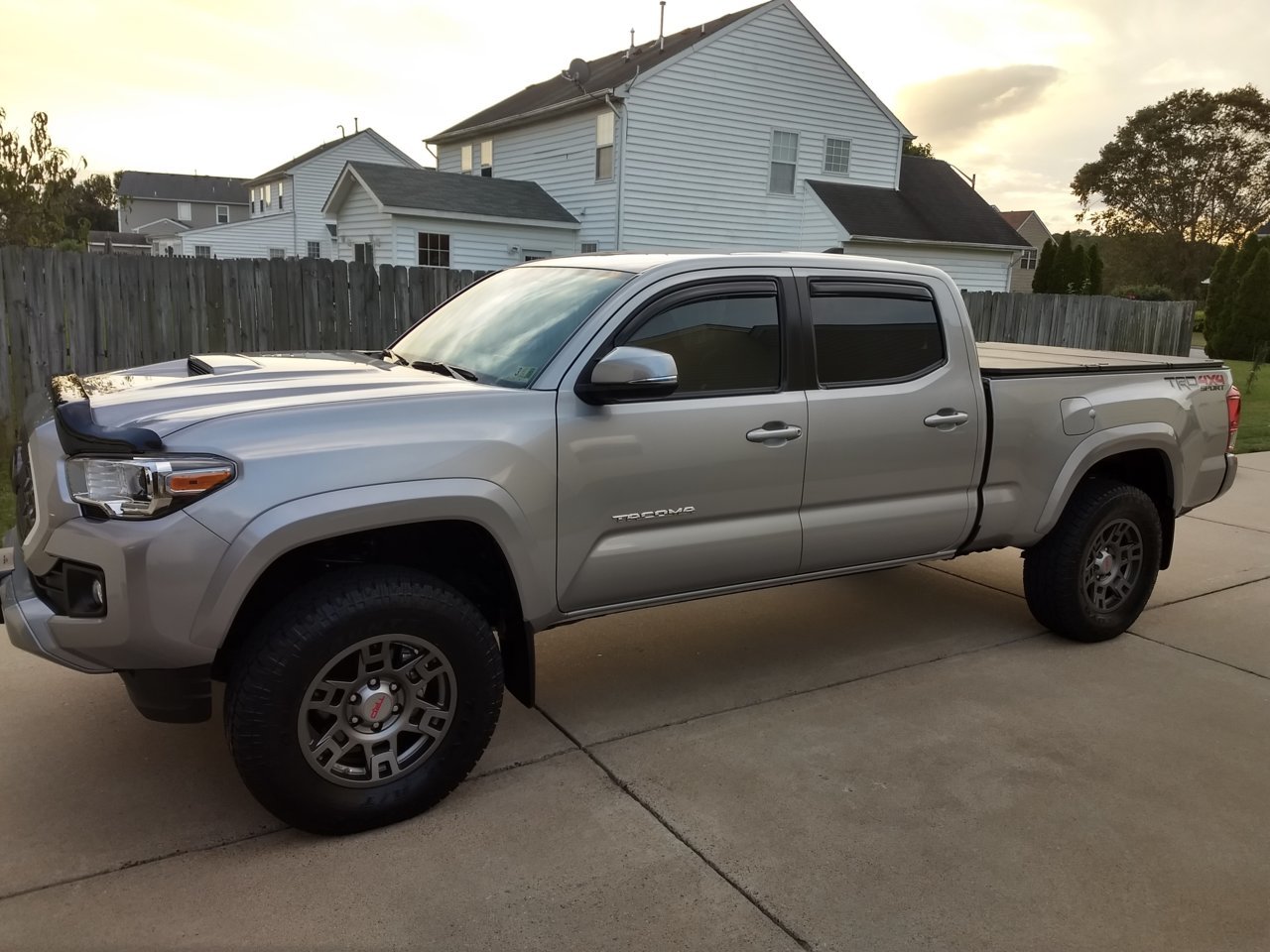

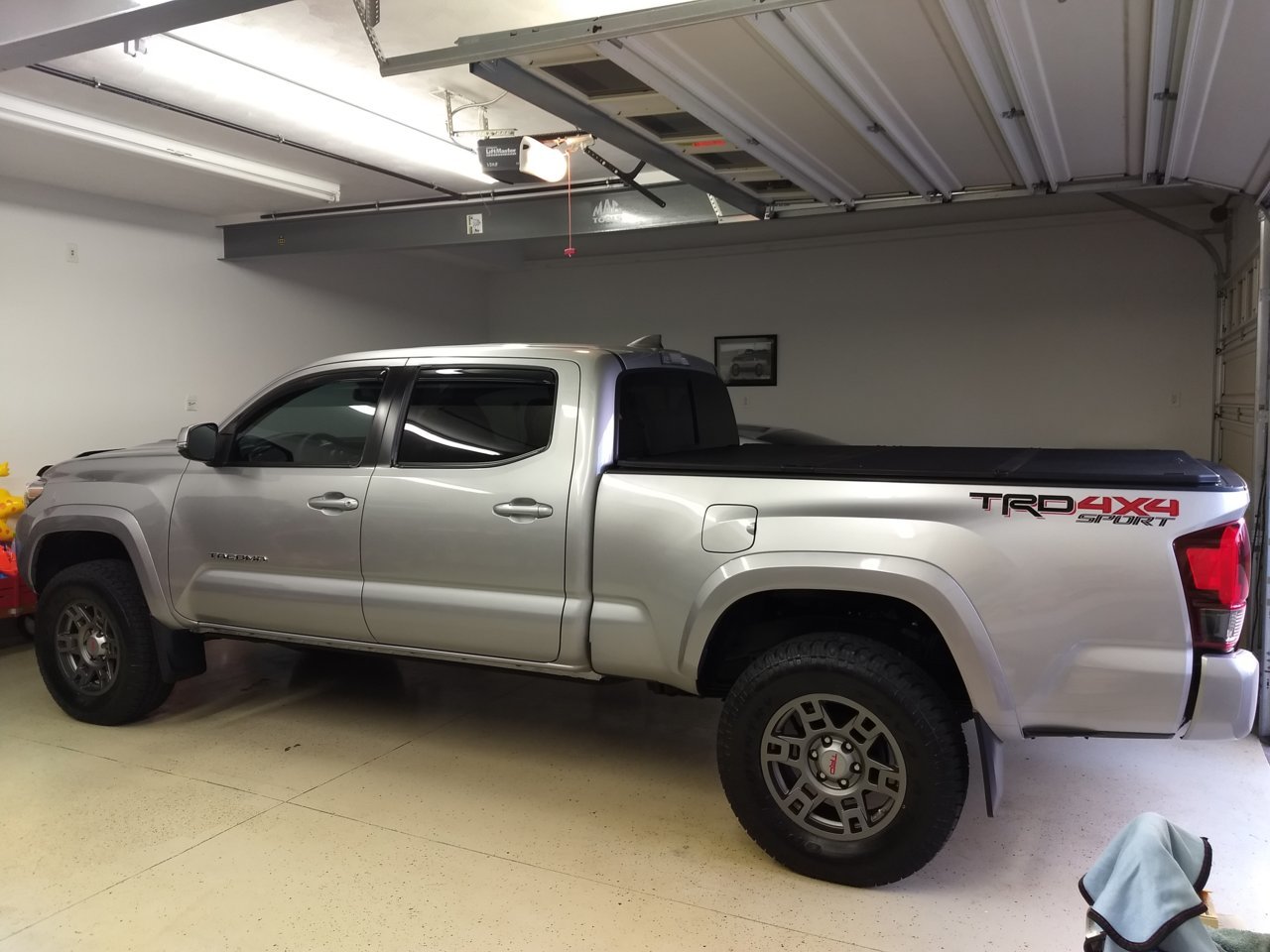

    Bilsteins 5100s on the top setting, 4runner Gray TRD Pro Sema wheels, 285/70/17 Toyo AT3s, Sumo Bump stops, TRD exhaust, ECGS Clamshell bushing, 1/4 shim for the lean and one inch rear block, OEM Pro grill and garnish OEM TRD Skid plate, TRD CAI, Demon Brackets, Rigid Industries Pro fog lights, OEM Trail Rails sidebars, Diode Dynamics LED SL1 high and low beam lights, OEM Roof racks, Clazzio leather heated seats, Remote Start, TRD Pro shift knob, tinted windows, Rockford Fosgate 4 channel amp for the headunit and sub and amp combo, OEM Puddle lights, OEM tailgate lock, OEM bed mat, LED interior lights, OEM blackout kit for letters, JLT catch can, upgraded 27F toyota True Start battery, Vleds led tail light kit with Pro tail lights, OEM Rave4 side mirrors with convex spotters,just to name a few mods.
    I hope this helps. All though I'm set on the 4th setting it rides so much better than the stock Sport ride. Alignment was perfect, used stock UCA. Got 2 3/4 in the front and a 1 inch block in the rear, making it almost level or the slightest rake. I didn't want to go on the highest setting because I would be slightly higher in the front. Also I didn't want a 2 inch block in the rear. Didn't want to much of a gap in the wheel wells which might look un-proportionate with the new wheels and tires. The Off Road shop says they have had some vibrations when a 2 in block in the rear and they said that the settings on the highest would ride the same if set on the 1st or 2nd setting. This shop has been in business for many years, amazing reputation and a stunning showroom and work center. Something you would see on tv. Mine rides and handles so much better.
