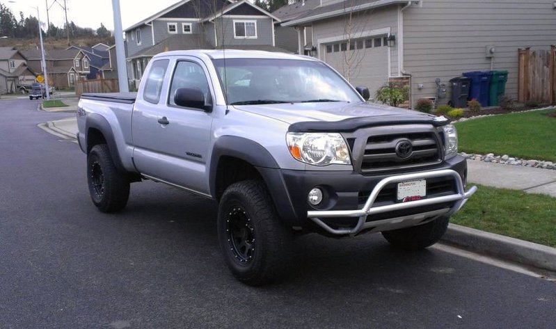

    Secondary air filter removal, K&N drop in, Removed front mud flaps, Toyota all weather matts, skid plate, bug guard. Bilstein 5100's all around fronts set at 2.5", OME add a leaf, Goodyear Wrangler Authority 265/70/17, stubby 6.5" antenna, smoked tail lights, blacked out badges.
    Or you can do Bilstein 5100's for half that and have 2.5inches of lift up front. Not to mention improve your ride quality. My favorite mod i have done, and I easily clear 265/75/16's
