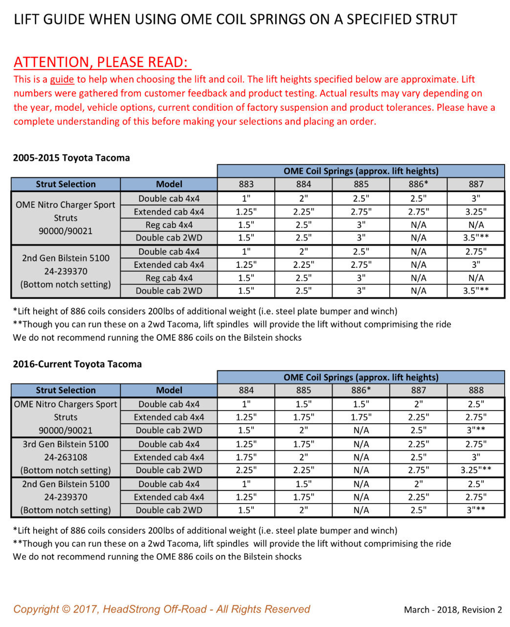

    Probably need to give the guys at Headstrong Offroad a call. According to their chart they dont recommend 886 coils with 5100s but there are a number of people that run them on TW and it seems to give about 2 inches of lift with 200lbs of extra weight. 2 inches up front would make you nose high on a stock rear end.

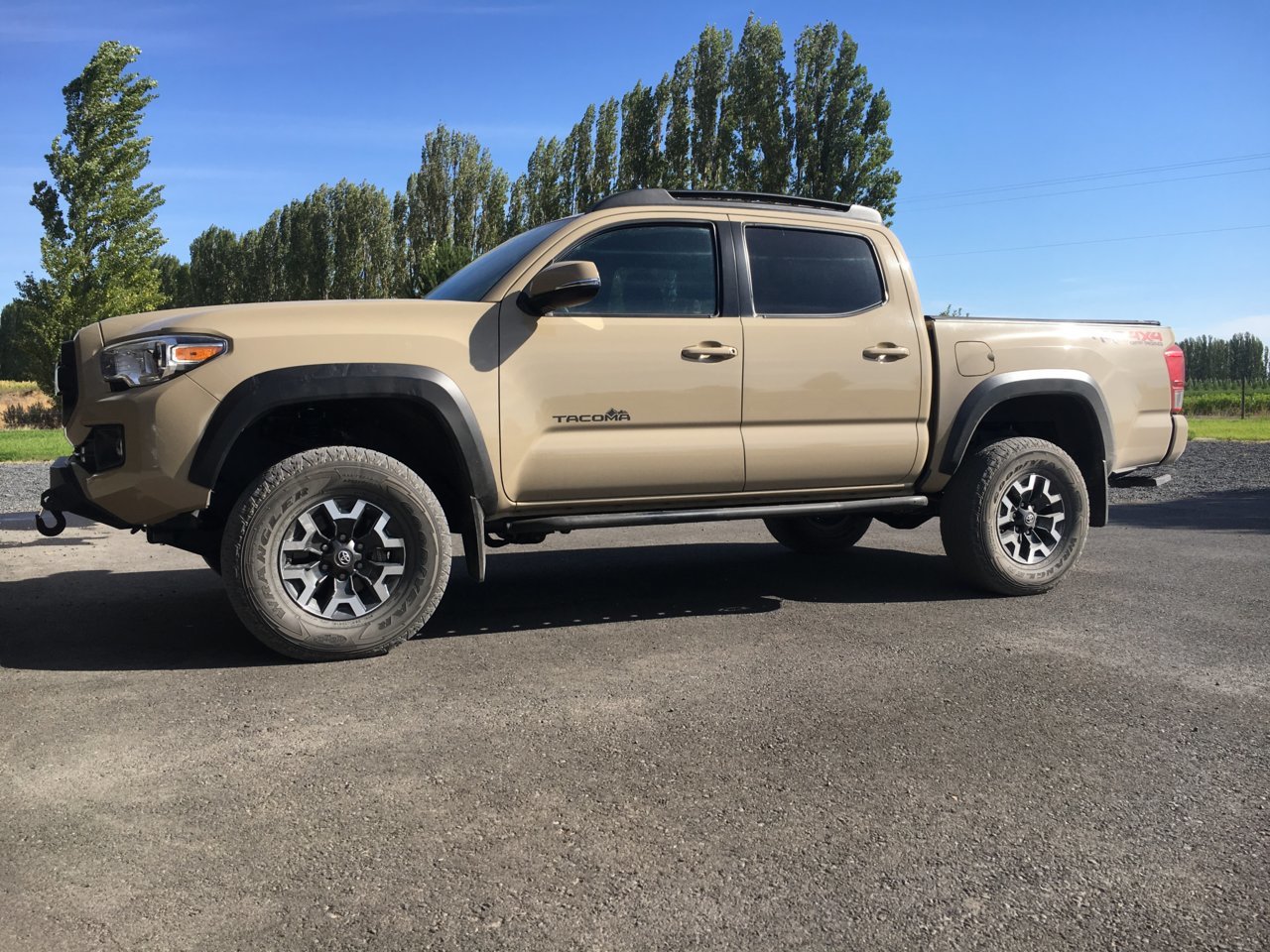

    I also have the OME 888 front springs and sport shocks and full Medium Dakar rear springs. Purchased from Headstrong Off Road. Have a SSO slimline bumper, with winch and ALL-Pro sliders. Sitting a little over 2" in front and 2" inches in the rear. Ride is much better over stock. @SpeySquatch did you have problems with the lower rear shock mount? Mine did not fit and I had to hammer and bend the lower factory bracket to get the shocks to fit. Otherwise everything went smoothly.IMG_0298.jpg

    No issues mounting. Everything sits right I’m just surprised the shocks angle so close to the leafs. The leafs will actually touch wider shock bodies and you can hear it when articulating or going over whoop see doos quickly

    Thanks, I’ll contact Headstrong see what they have to say. I have just over an inch clearance from the rear spring
