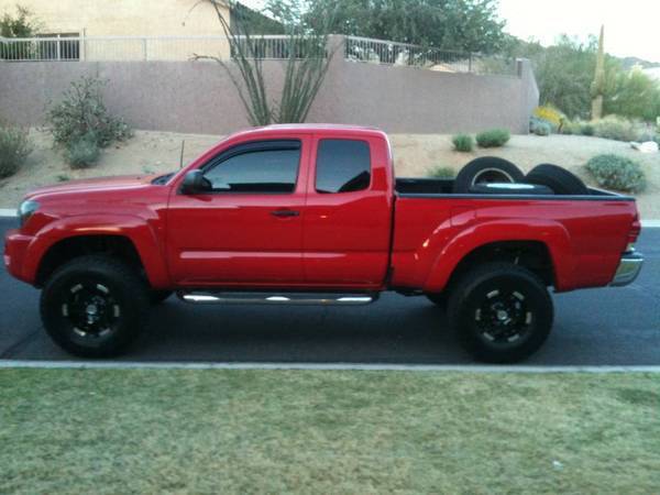

    Just got my ProComp lift installed wednesday. Got it Shipped to my door for $414 at truckaddons.com. I would totally recommend it for the price
