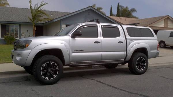

    set mine at 1.75, then measured...went back in and maxed them out. I'm level measuring off the sliders.[​IMG]

    why on earth it never occurred to me to measure that way is beyond me lol. Good idea.
