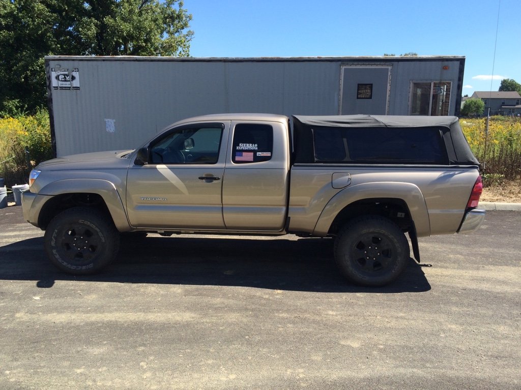

    5100 front and back. 2" AAL. OME 884 set at .85 up front. Raised front 3", rear 2". New wheels & tires soon then LR UCAs. That or im bringing the front down to .0 setting. I'm pulling to the right and getting a little wheel chatter on bumps at highway speed.

    Nice. Looks great!
    OP - How far much lower is the front vs rear, an inch?
  10. Sep 14, 2015 at 8:01 PM
    MadDaddy
    MadDaddy Pork Rind Extraordinaire
    Jan 1, 2015
    #145405
    6,819
    53 Miles West of Venus
    Many & varied
    Stock: Fronts: 20” Rears: 21.5”
    With Lift: Fronts: 23” Rears: 23.5"

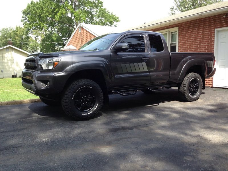

    I'm running stock springs up front with 2" AAL in rear. 5100's are set at 2.5" up front. As far as I can tell the truck is level. My friend did the same and achieved the same result.

    looks great! love the retro decals !

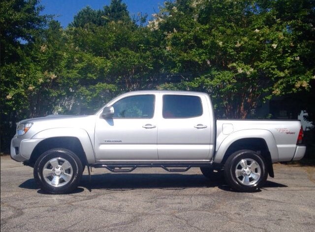

    This was on 5100 all around with eibachs set at .85 and wheelers progressive leaf pack on 285/70/17

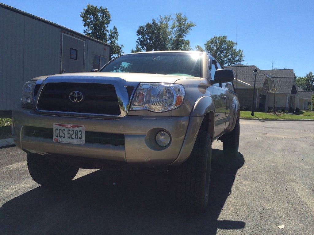

    I just got done with mine this past weekend. 5100s all around, OME 884 springs with the front 5100s set at 0, and a wheelers 3 lead aal in the rear. Rides really nice..just need to get an alignment ASAP
