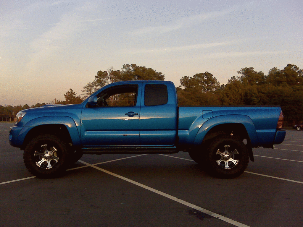

    Here is your answer: F: 5100's @ 2.5", R: TSB + AAL matched with 5125's. Slight rake, should be leveled once the rear sets...

    Yup, thats complete... Rear AAL is from Toytech, which was designed for the TSB 4 leaf pack. Truck rides great. Only reason I will change is if I go to a 4.5 or 6" lift. But thats a whole different ball game.

    What spacers you running?
    I had the Ready lift spacers up front prior to the 5100's, and even after the TSB it looked like this:
