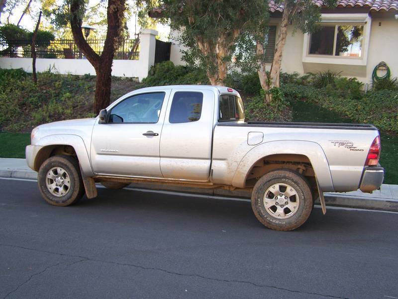

    Is it possible to just level the front of my 06 TRD w/ 5100's and leave the rear stock? Does anybody have any pics?

    Definitely possible...

    5100s at 1.75" with stock rear.

    thanks, it will level it out right?

    Most definitely.

    There is no way the rear is stock, maybe TSB springs, but not the original 3 leaf pack. It is at least 1 inch higher than stock.

    I have 5100s just up front set at 1.75" and a completely stock rear. The front is ever so slightly higher than the rear.

    Yeah, I think you're right. I don't remember when I had the TSB done but after looking at that picture closer it was definitely before then.
