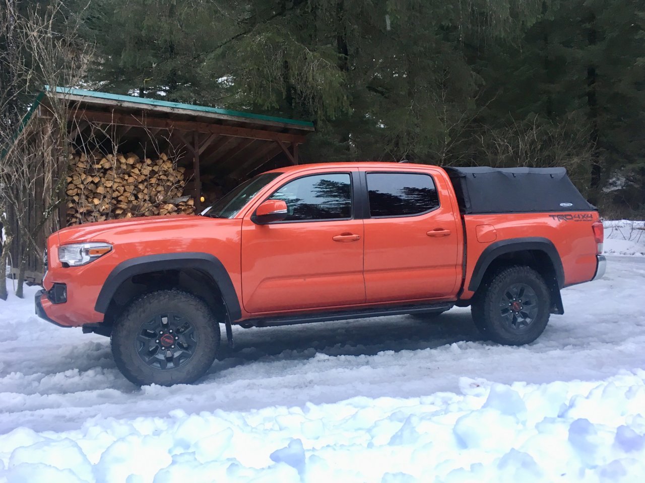

    I installed a Dobinson lift last week. I went with the 2” springs up front and opted for the HS 3leaf AAL in the rear for a 1.5” rear lift. So far I am really liking it. Def. a firmer more controlled ride over the OR suspension. Pic is a bit off looks higher in the front but it’s actually about 1/2 higher in rear. 607BB37B-57BD-43C0-8B6A-72691FC97B1C.jpg

    Any alignment issues or vibrations? Did u need to shim rear ?

    No shims in the rear. I took the OL leaf out to keep it at 1.5 in the rear. I don’t haul that much so should be fine. No vibes so far but haven’t driven that much. Nice and smooth so far up to 55 mph. Haven’t gotten out on the main roads yet. Had it aligned yesterday and all is green however I feel like the alighnment guy didn’t really know what to set it at as he went with factory specs and it’s now 2” over that. I will probably take it somewhere else but that means a 2.5 hr drive for me. When all said and done I like the lift and look but almost wished I would have gone with the medium load for a 2.5 inch up front. All good though.

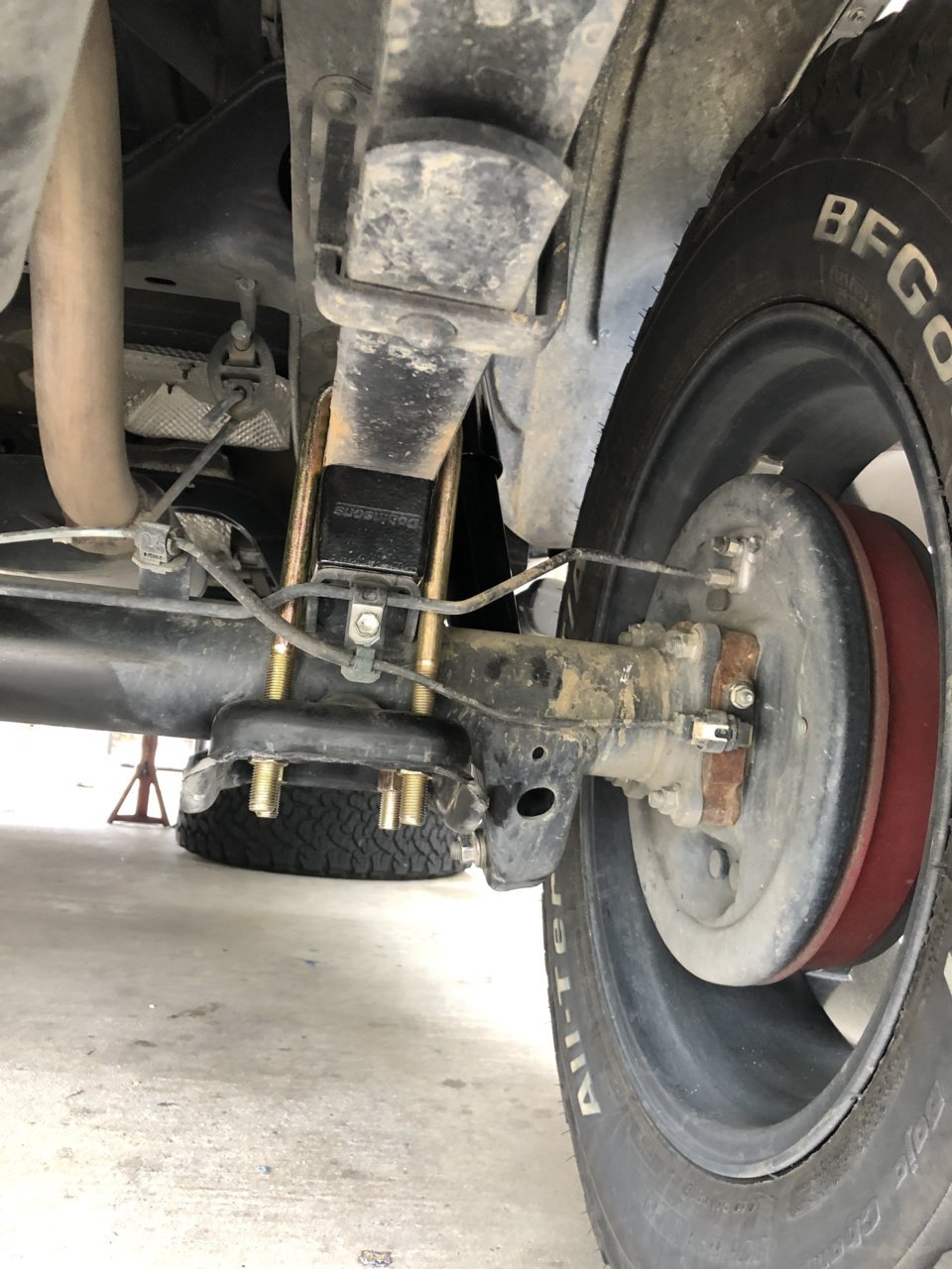

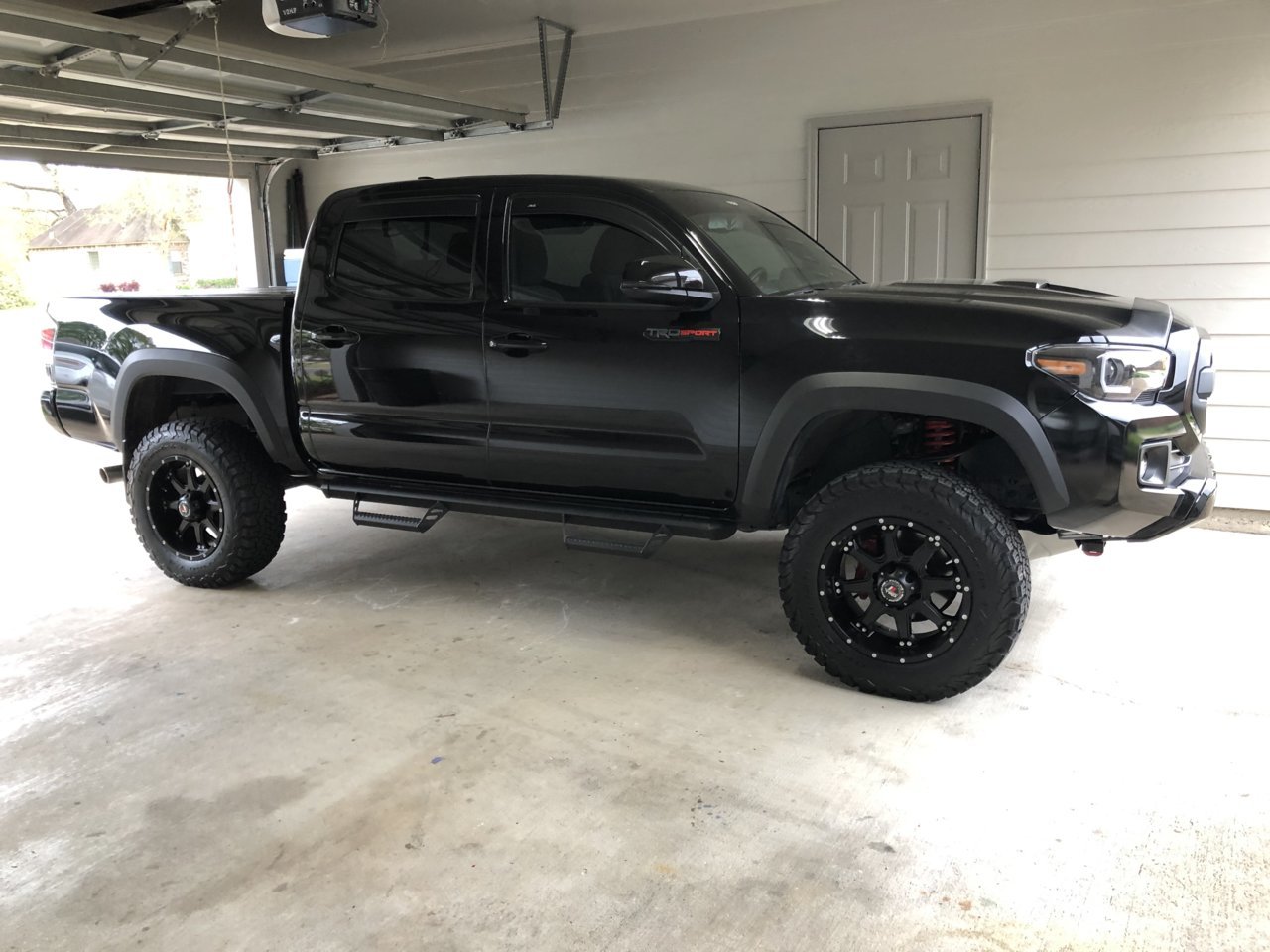

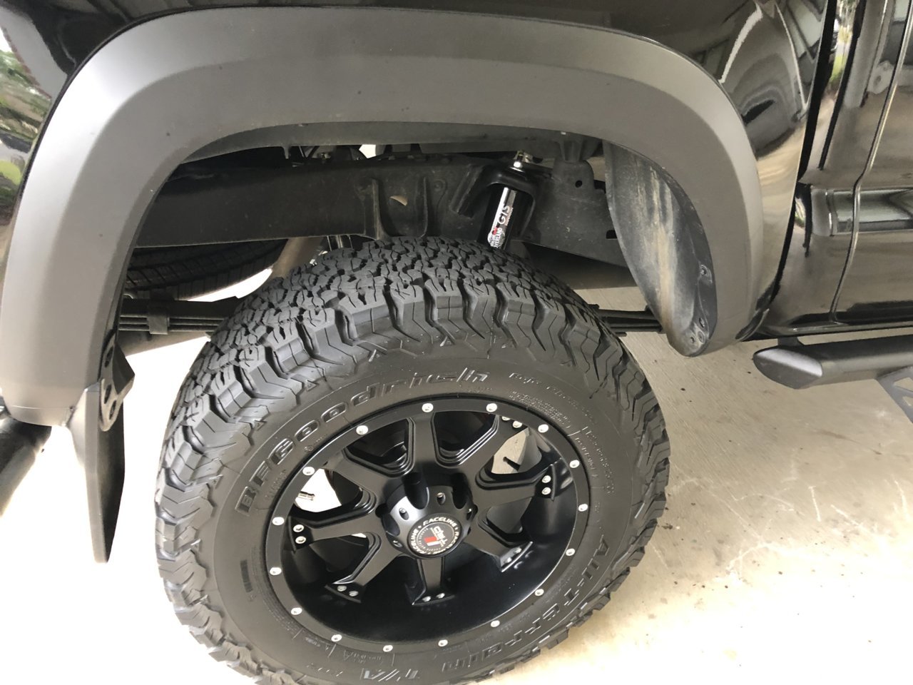

    I did the medium load springs and got 2.75”-front, 2”-rear. Still have .5-.75” of rake. Tapered blocks in rear. Here’s some pics.
