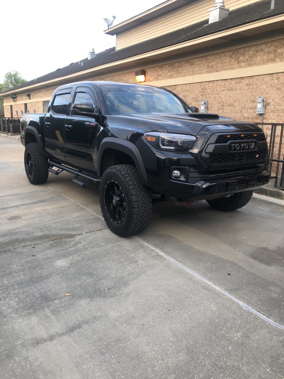

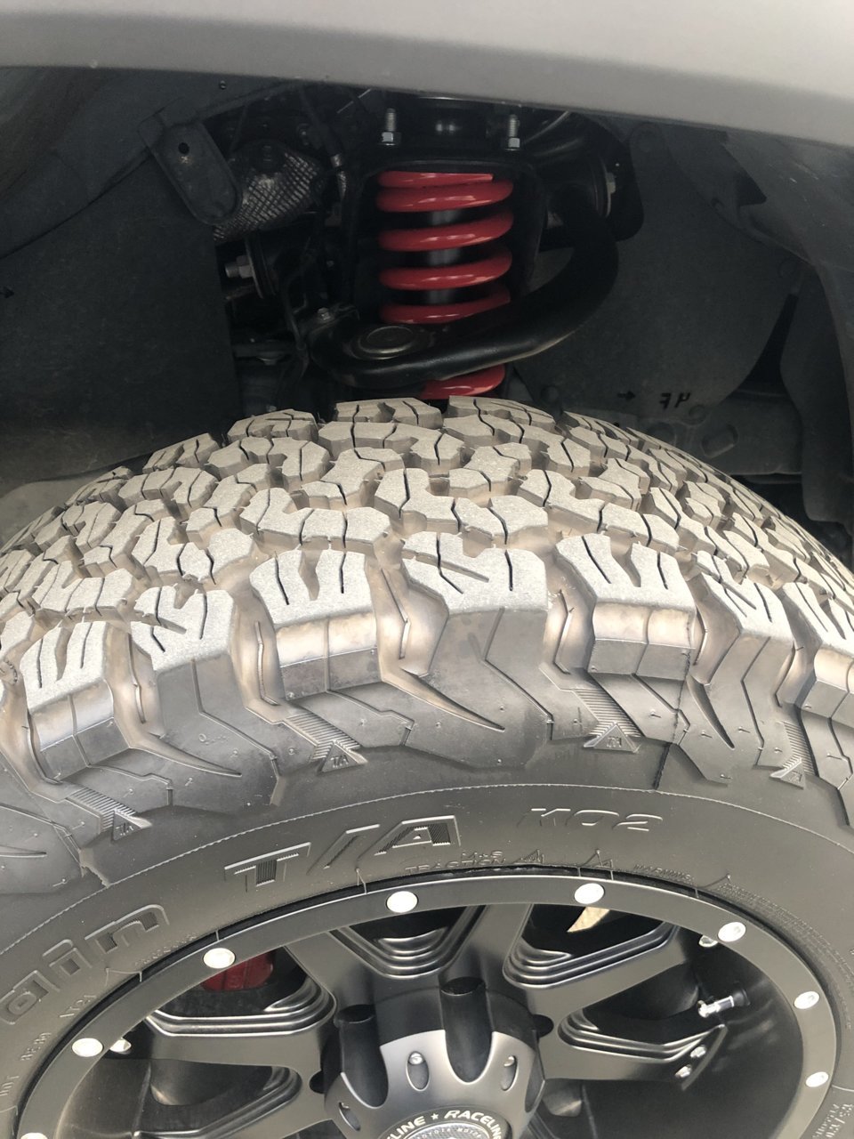

    BFG K02’s 275/65/18.
    Ground to fender— front driver’s side- 38”, front passenger’s side- 38.25”, rear driver’s side- 39”, rear passenger’s side- 39”. Yes on stock UCA’s.

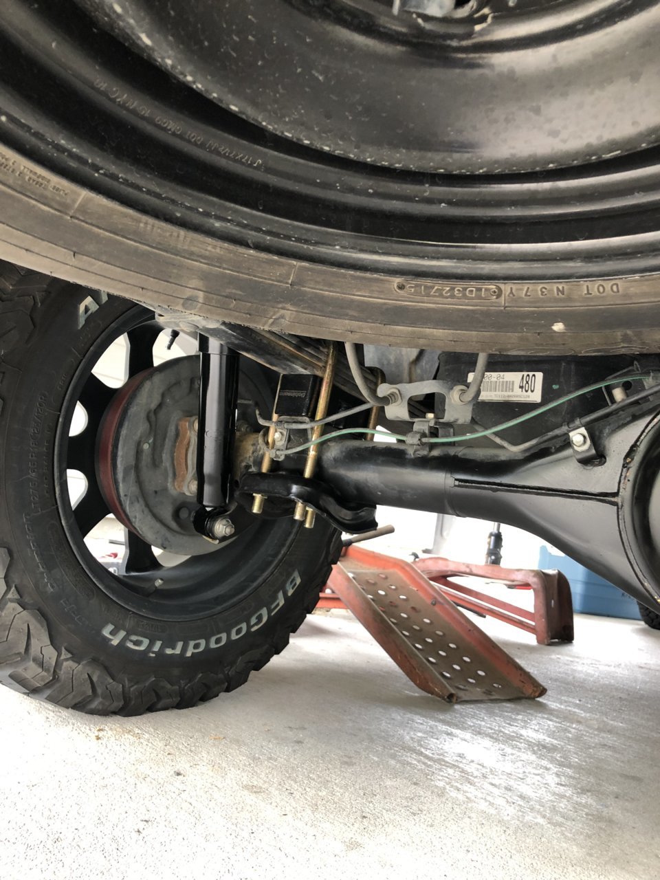

    I am running 265/75/16. So my tire is about half inch shorter. forgot to get hub to fender and only went with ground to fender. I am at 36” in front. I have the 314 medium loads on the way. I put a 3leaf AAL in the rear and took the OL leaf out for a 1.5 lift in rear. I sit at 37.5 in the rear. Do u have a 2” block to gain a two in. Rear lift?

    Yes. I used the 2” tapered blocks.
