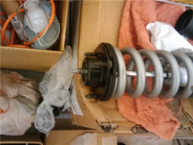

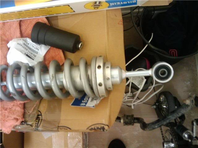

    so i got my eibach springs and my 5100 billys. the ring is on the 2.5 on the billys. i put my collars on the shocks, then put the springs just to see what they looked like.
    on the collars the adjustable part was all the way down and the billys were set at 2.5".
    i was able to screw the top plate on the assembly without a spring compressor...
    thats doesnt seem right does it?

    no no no, you dont want the c-clip at the 2.5 setting.....you want one of the lower 2 settings. with the higher rate and that much preload you could bust the shock.
    on second hand run it at 2.5 for a while and give us an update.:D

    Ill post a picture up soon also, but if that's the case what do I need to put between the springs and the top plate in order close that huge gap that I would have?

    Nothing should go between the springs and the top plate. Post a pic of what they look like so we can further help.

    should that screw on the top just go right on? i dont think so i thought that the spring needed to be compressed in order to get that top screw on.

    i wanna run these at no lift so idk how high the collar needs to go up, maybe thats the problem??
