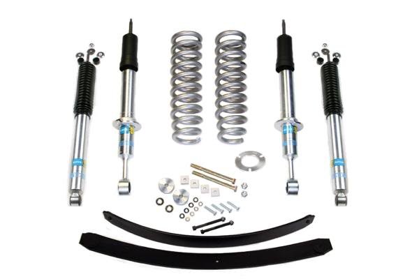

    I have this set up (non-tsb)... 1.6" Eibach coils, Bilstein 5100's set @ "0" and the add-a-leaf( 1.75" I think). Purchased through Toytec.com during a group buy about 3-4 months ago.
    But if you're looking for 3", maybe consider the OME set up @ Toytec.com.

    "How is the ride with this compareds to stock?
    ...and issues after an alignment?"
    The ride is great. It's a little firmer than stock... not as "squishy".
    I can't find the alignment printout but all settings were in spec.
    "wmb do you have new uca's?"
    I do not have new uca's. Though I may purchase them in the future. Alignment was put into spec range. The shop couldn't get them to the "ideal" setting, but safely into spec range. I wish I could find the alignment printout #'s and quote you some real numbers.
    Like I mentioned above, I may pic up ucas in the future, even if I don't truly "need" them, because I would prefer the specs be set a the "ideal" settings.
    I do have a slight shudder/vibration@ ~3-6 mph and ~24-28 mph. I just have not had the time or the weather to really diagnose/solve the vibe.
    Overall, I'm very happy with this set up.
