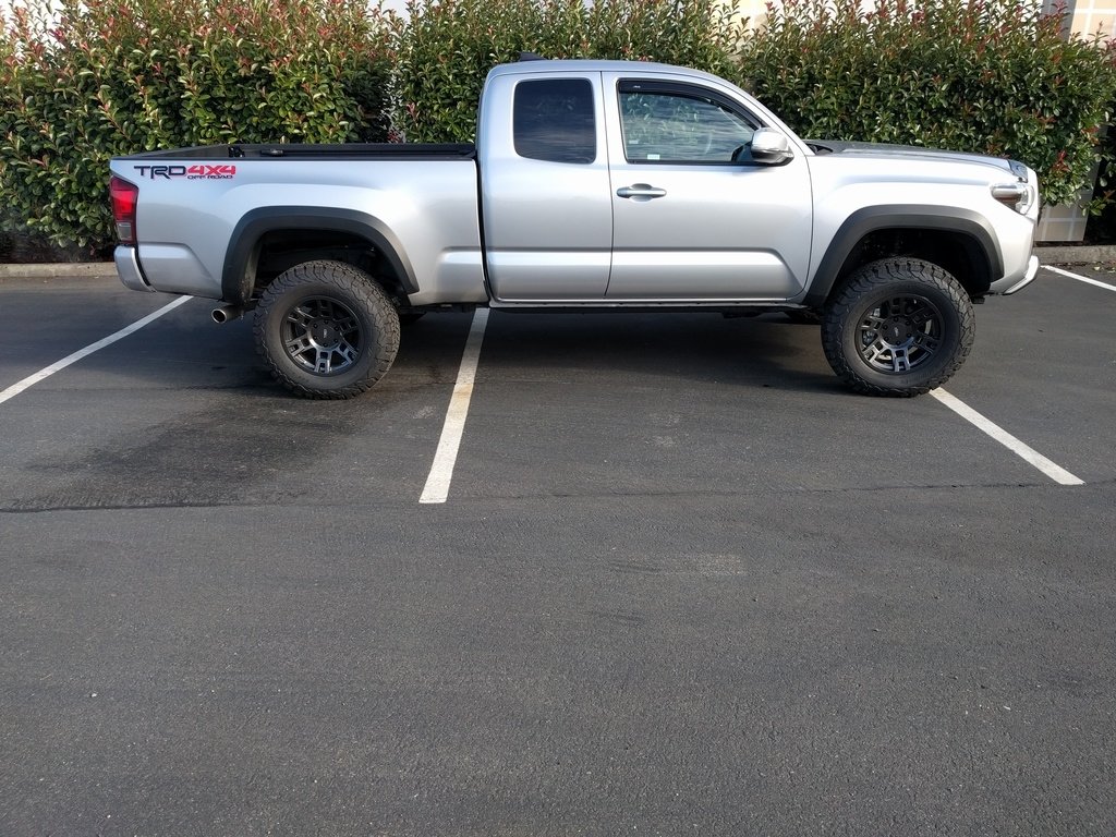

    I just installed the HS 2" coils on my 2015 dcsb 4x4 and got about 2 1/4". Paired with a 1.5" in the rear. 5100's on all corners. Rides great, looks even better. I now look for potholes just for kicks :). Thanks @Headstrong !

    Looks good man! I think I may get the 2.5" outta them being a 4cyl then. Did you include the 1/4" lean spacer on the driver side?

    They are the Headstrong Off Road in house brand. Listed as a 2" lift coil. I also did the 1/4 spacer on drivers side.
    These are 265/70/17 Duratracs on TSS wheels.

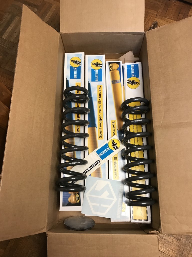

    IMG_0490.jpg Look what just showed up. Just need the AAL and new top hats now, next paycheck.

    Just about 1/4" higher in the rear

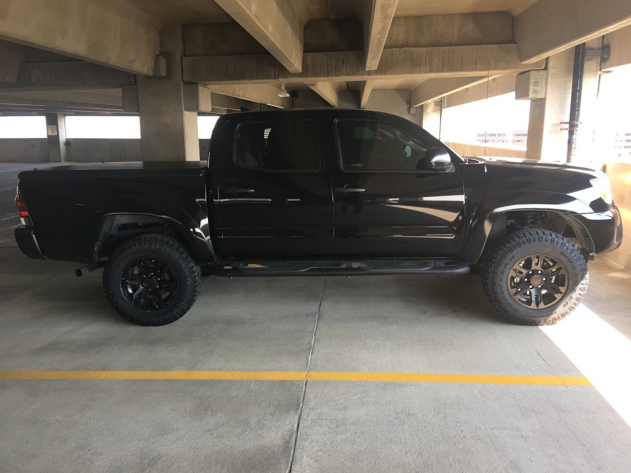

    Ome 887 coils ,Bilsteins, Headstrong progressive 3 leaf aal, driver 1/4" top plate spacer ...i would say probably the best bang for the buck. Thanks Headstrong Offroad.

    Great lookin truck man, what size tires and wheels?

    265/70/17's....do i wish i would have tried to fit bigger ? Yes , i do. They look better in person.
