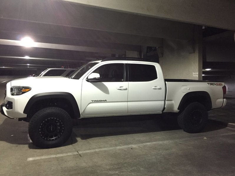

    Thanks again everyone. After 4 hours we got it done. Had to cut passenger side UCA bolt and put a new one in backwards to make it easier to repeat next time. Drivers UCA bolt we got out by prying fender well out. Had to cut rear leaf containment bracket. Didn't have to touch the front Leaf pack bracket but angle ground off the rear bracket and stubs so aal would sit flush and aal pack bracket could both through. Don't over torque the center pins. Only needed one clamp on very end of leaf pack.
    Up front didn't really need to take abs bracket off to bend fender well but we did. Just pushing the loom tabs through would prolly work. When replacing the UCA's you don't need to mess with the lowers. Had to undo the sway bar links.
    My setup is
    Method NV's 17x8.5
    Toyo AT2 SL 285/70/17
    OME 887 Springs
    Taco Lean Spacer on Front Driver coilover
    5100's at .85 up front
    51xx in rear
    Headstrong Staunch-Conservative AAL
    24" in front hub to fender
    23 1/4 driver rear
    24 1/4 pax rear
    Trying to figure out what happened now.

    24" in front
    Something is wrong in back
    23 1/4 driver side
    24 1/4 pax side
    Not sure what to think. Driver side wheel is an inch inside well and pax side is further out than it should be. We have a center pin that broke on drivers side leaf pack and need to replace when I get it in the mail but the pack is compacted it looks like. Everything looks normal to me except the lop sided bro lean. I hope I can get driver side up to 24 1/4 or 241/2 on both sides. Liberal bias out of the progressive aal pack. Did come from Left coast haha
