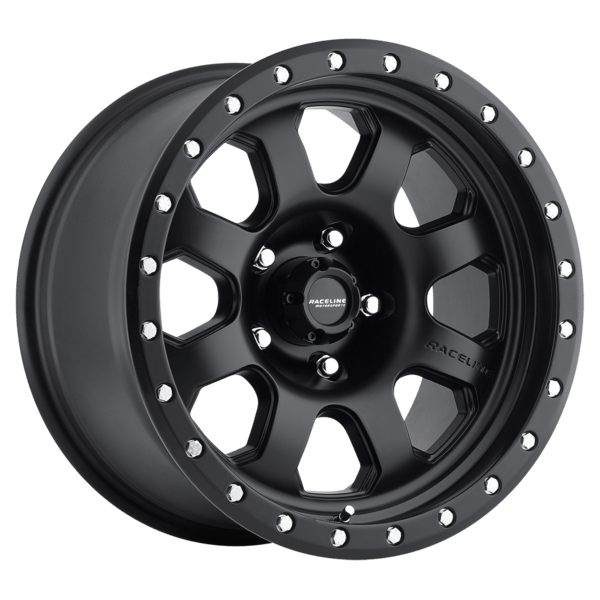

    Ok, so heres a general question, i just ordered my wheels and now looking for tires, i got these from Raceline, their 17x9 and im lifting my 16 tacoma with the bilstein 5100's. i was thinking about only going 2" higher since the 16's already come an inch highter than previous models...i really want the KO2 tires from BFG but the 285's are expensive and i was slightly worried about rubbing. i was thinking about using the 275x70x17, anyone think that would be a good fit/look? This is my first mid size truck i've gotten tire/rims for...so unsure how it will look, i've usually got 35" tires on my other full size trucks.

    That'd look great, IMO.
    Cool wheels.

    damn, nevermind, i guess they're saying this wheel will require a 285 size tire due to it's width. Looks like my budget just went back up!
