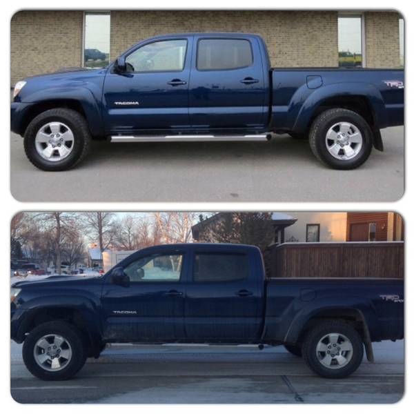

    Here's mine before and after installing 5100s and 885x coils. Haven't done the back yet, but measurements on the front tell me I got almost exactly 2.5" lift on the front. I think I measured 2 3/8" on one side.
