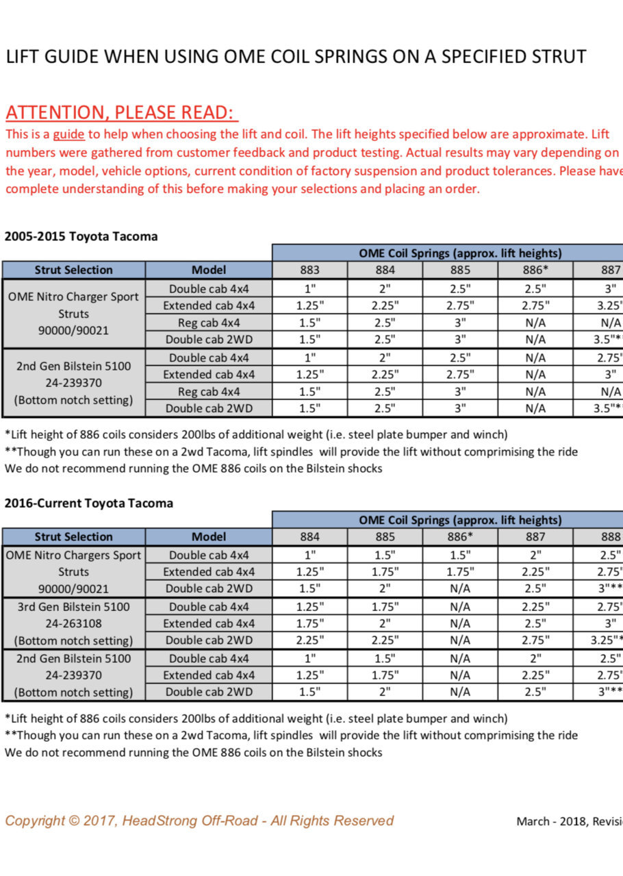

    2011 Toyota Tacoma and 2019 4Runner
    Now we have seen some slight changes with lift heights from the OME coils and I speculate a lot of the changes we are seeing are the result of the running change made to the 885, 887 and 888 coils. With new test data in addition to data received from our customers we are now indicating the 887 coils will provide 2.5" of lift (after settling) on a 2nd Gen double cab 4x4 V6 Auto. We also have a new chart we released vs. the one provided within this thread. The chart can be provided upon request and is no longer listed on our site.

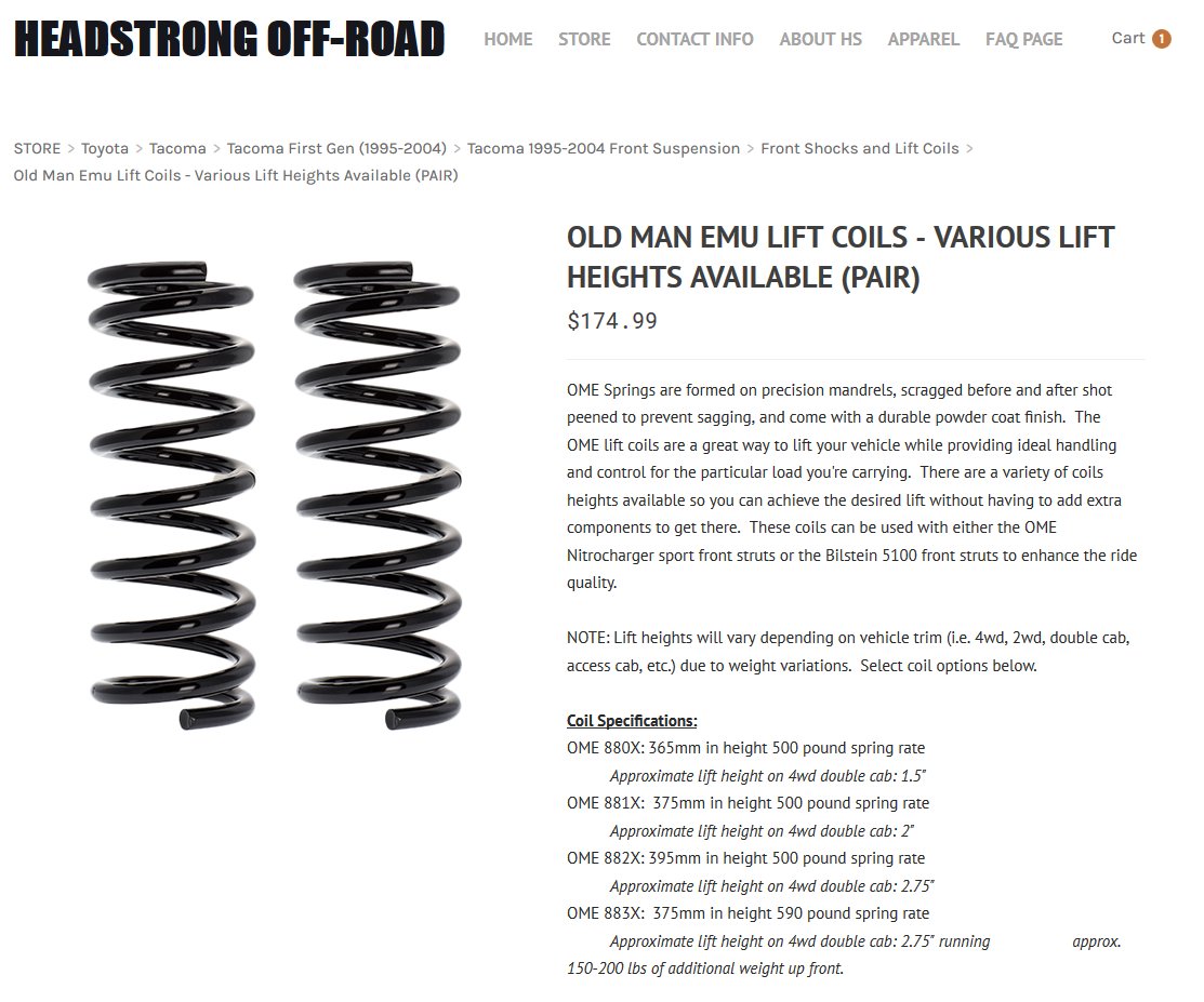

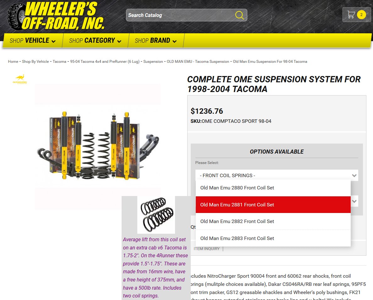

    I get to answer my own question!!! :bananadance:
    This 1st gen OME coil information is available on HeadStrong's Old Man Emu Lift Coils - Varios Lift Heights Available (PAIR) shown below and at Wheeler's OffRoad web page where the information will be displayed in a popup window if you click your mouse on the --Front Coil Springs-- dropdown menu and then mouse over the different options also shown below.
    Headstrong Offroad web page:
    Wheeler's Offroad web page:

    I am glad i got the old 887s on my taco. I went off your chart to get a soft 2-2.25ish" of lift with some weight with 5100s and 887s
