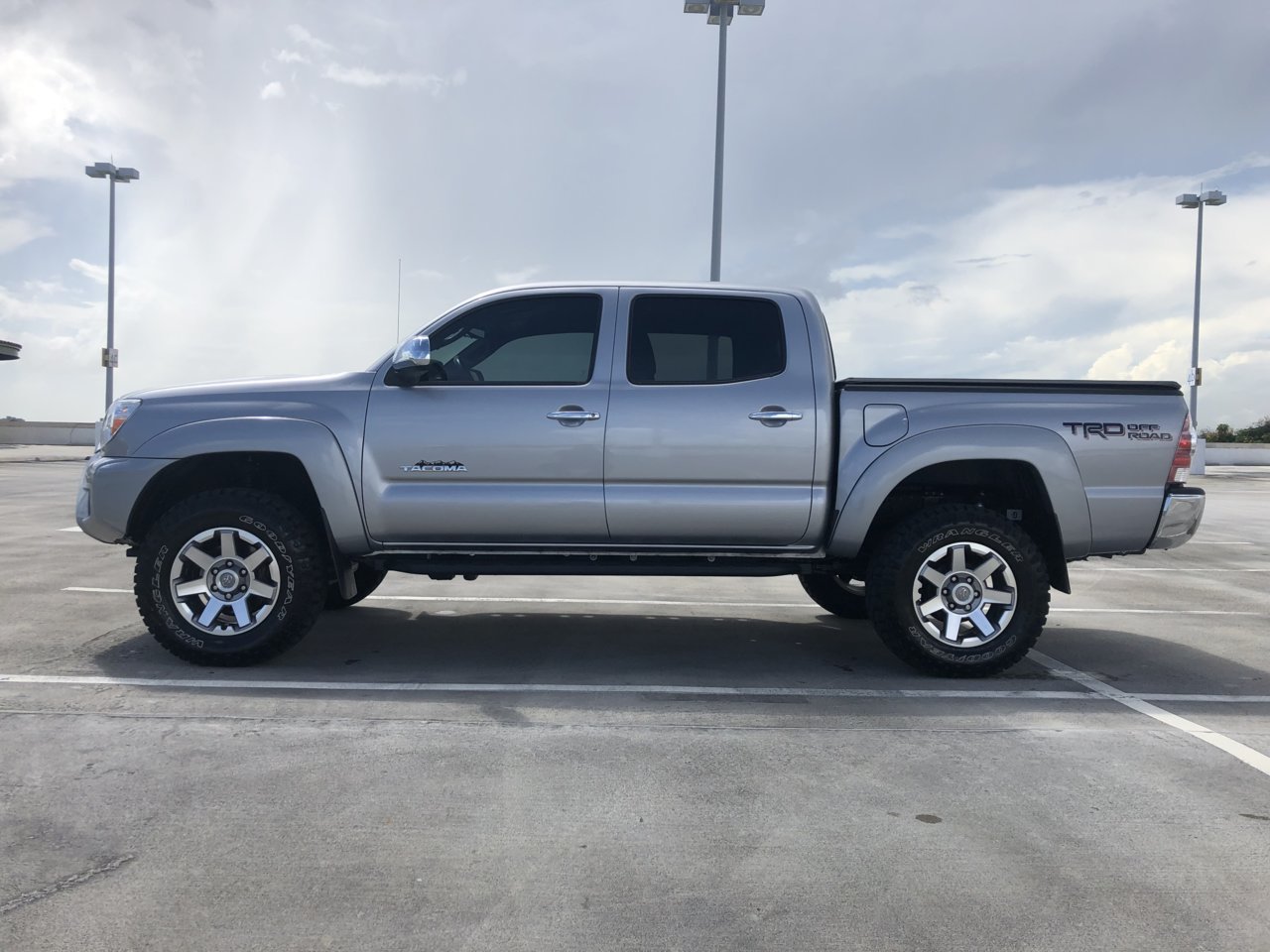

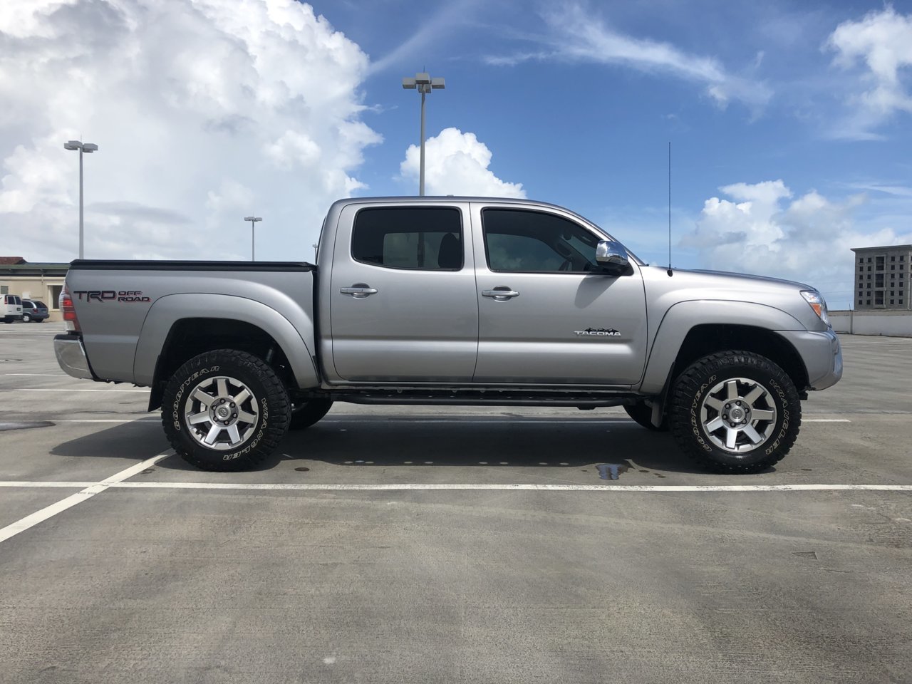

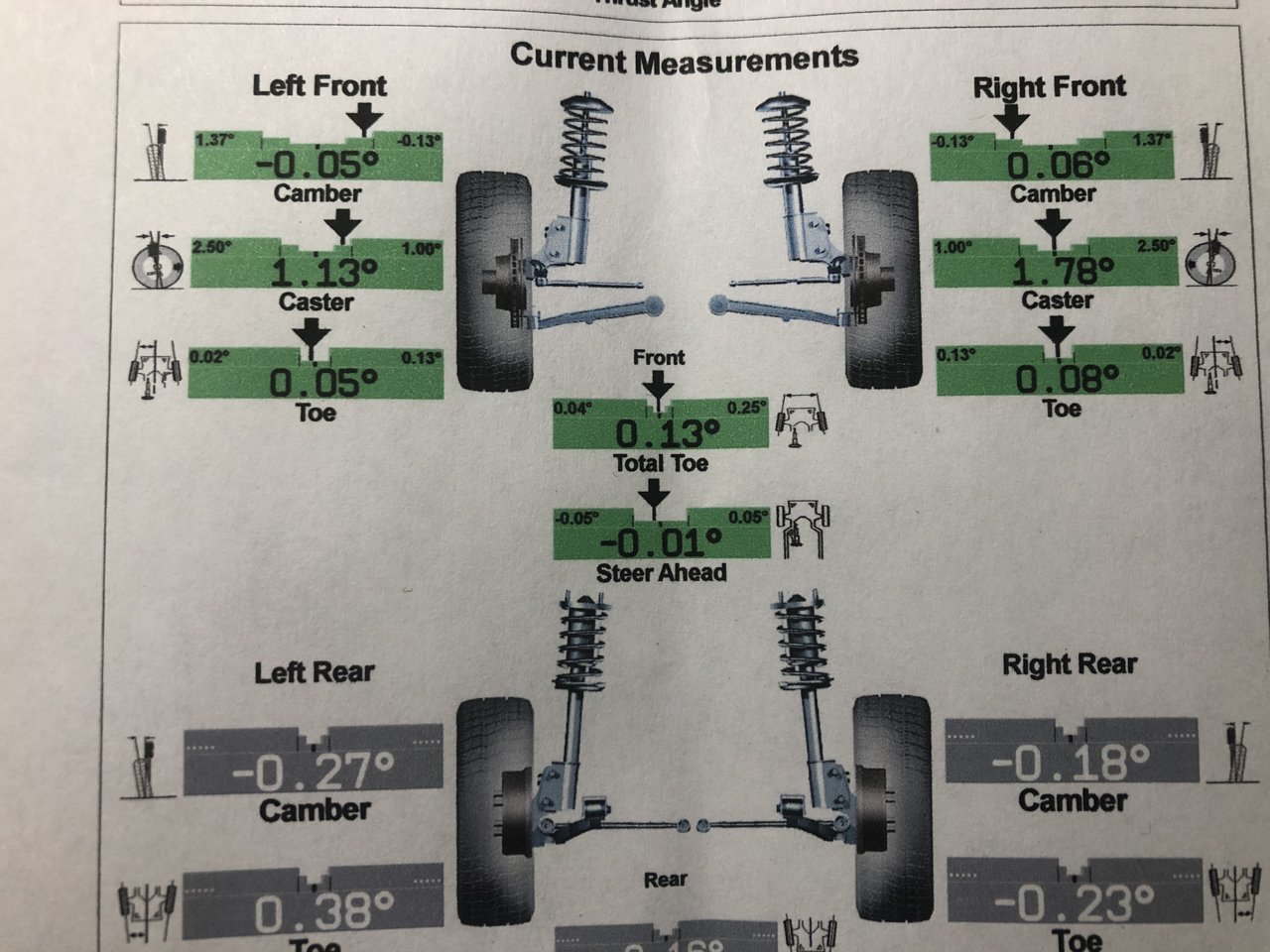

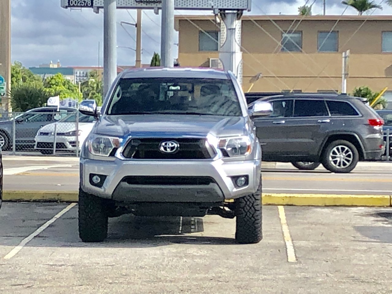

  17. Sep 20, 2019 at 1:50 PM
    #57
    TAC1
    TAC1 Well-Known Member
    May 13, 2011
    #56594
    2,863
    Tac1
    Miami, FL
    2015 DCSB O/R 4WD
    C37CEE79-CA2B-48F2-B8C2-3762D3685EAF.jpg 88A348C7-29D1-42EB-A615-578CFB9A87D5.jpg 52E3CB2E-6206-4863-88C9-5A05F925AC76.jpg 2C189D59-6B73-4DBD-ACE6-84E8AA441582.jpg FFDAAEE4-8C8F-4D0F-A2A5-6545D4477863.jpg 8818EA62-D4DB-49F9-A50B-A57CE920614A.jpg
    Hello,
    My '15 DCSB TRD O/R 4WD has 5100s @ "0" with 885 coils & a 1/2" drivers side taco lean spacer on top of new KYB top hats. They have longer studs so it was no issue adding the 1/2" spacer. Only armor the truck has is SOS Offroad Concepts bolt-on rock sliders. Ride height with full tank of fuel is as follows:
    * HUB to FENDER
    LF 22.25 / RF 22.50
    LR 24.00 / RR 24.00
    * GROUND to FENDER
    LF 36.75 / RF 37.00
    LR 38.75 / RR 38.75.
    The suspension has about 1,000 miles on it. I'm OCD so the initial 1/2 inch "left to right' difference was annoying me. Now that it settled to only a 1/4" it's more tolerable. It's not noticeable at all but honestly I wish it were higher on the drivers side than the passenger. At one point I considered removing the 1/2" driver lean spacer from the drivers side & bumping up that 5100 to .85 but that may provide too much lift. My other idea was to buy a set of 887 coils & just use one on the drivers side but it's less than 1/2" taller so it may not even be noticeable & I still may have to use the drivers side 1/2" spacer.
    For those with the 5100s & 887 coils would you mind posting your ride height specs?
    Thank you
    BTW, I may go with JBA UCA's
    71tattooguy likes this.
