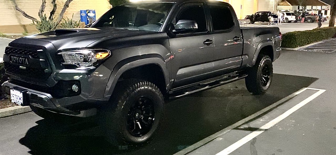

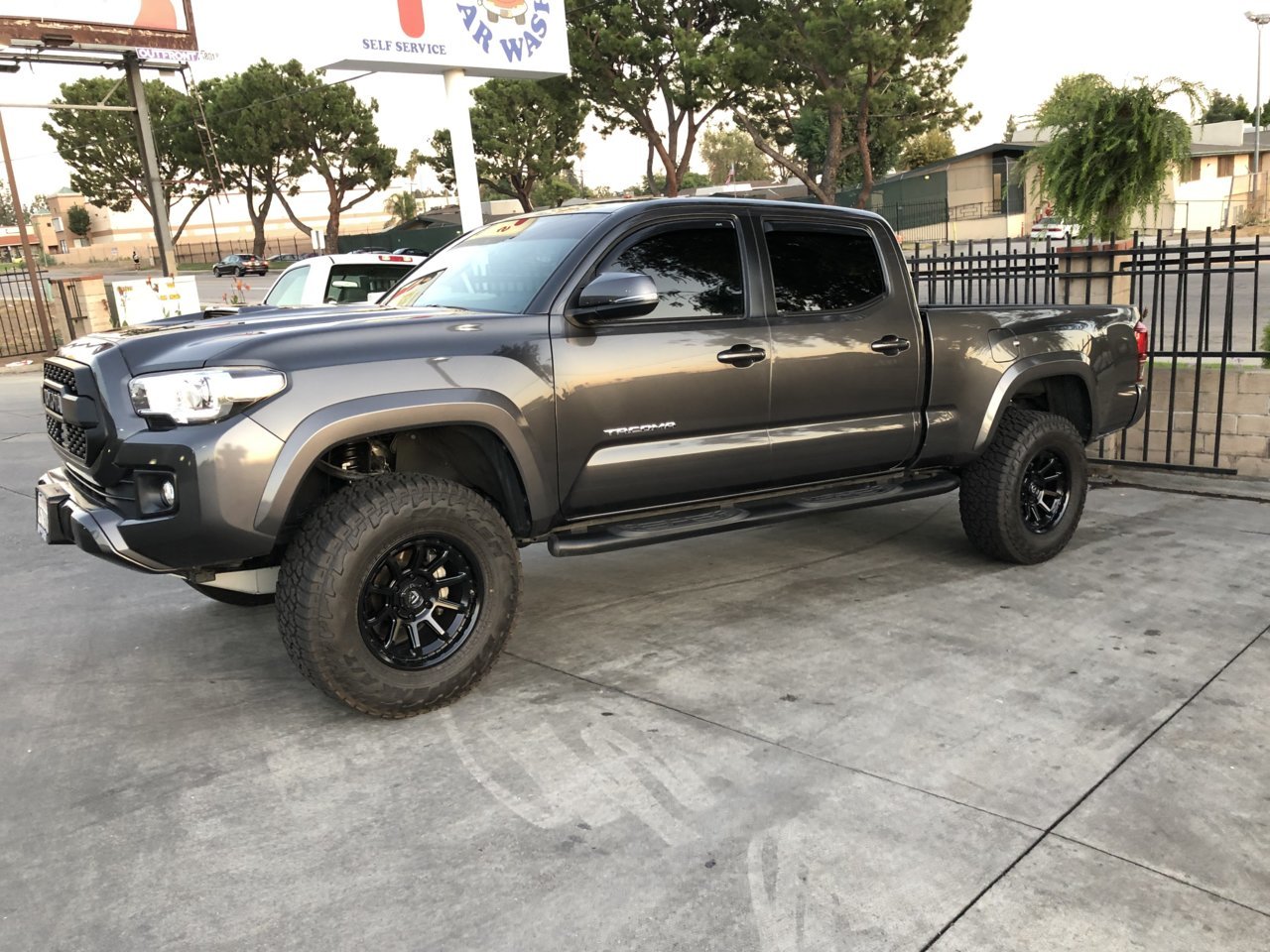

    887/5100 setting is 0. w AAL. I have an honest 1” difference between front and rear. But I did get my 2.5” of lift. I’m torn. Sometimes I want to add a 1” spacer to the front but then I think about the CV angle exceeding the 2.5 threshold ( 2.5” is the sweet/safe spot for 3rd gen ). I like the level look which happens when I through stuff in the bed, but I hate the BRO look when the front is pitch even a hair higher in the front. I get compliments at the site daily on how the truck looks, even the stance so eh... 7E5B7453-4419-444D-B8F9-52D3B04D260A.jpg

    Looks good to me. I wouldn't change anything. What size tires do you have?

    285/70/17 Falken wild peaks
