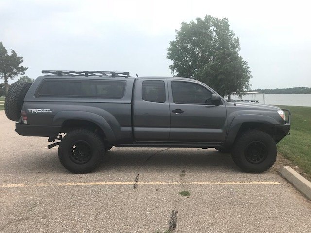

  6. Nov 23, 2018 at 8:05 PM
    BraskaTaco
    BraskaTaco Well-Known Member
    Jan 11, 2016
    #174711
    2,153
    Midwest
    2013 Tacoma TRD OR
    Not exactly apples to apples but here is my aluminum + winch which weighs in fairly close to the steel hybrid (with 887):
    sikTacos[OP] likes this.
