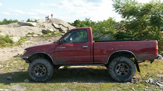

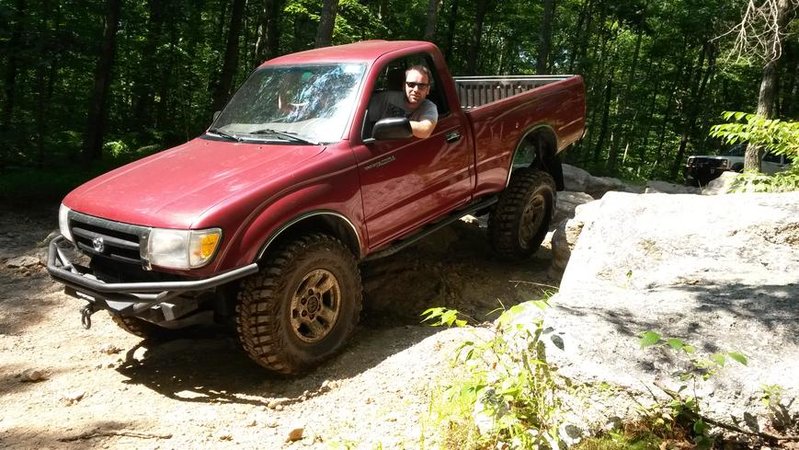

    Since my truck is a regular cab I got a lot more lift than an extended or double cab. I have the stock rear shackles and OME Dakars. Have the front coil overs cranked all the way up to match the rear. The Dakars advertise about 2.25" of lift but I got over 3". I didn't put any axle shims in either. No vibrations but for how cheap they are I would reccommend it.
    I am running 32x11.5 tires. The fronts were rubbing at full turn. Put in 1" wheel spacers and corrected the problem. As Teehext said about the exhaust, just cut it off. Exhaust relocation kit is a waste of money. Buy a new set of isolator pads for the
    Extended bump stops would also be a good idea. I took my sway bar off and if I really flex the rear my tires will rub a little in the rear.
