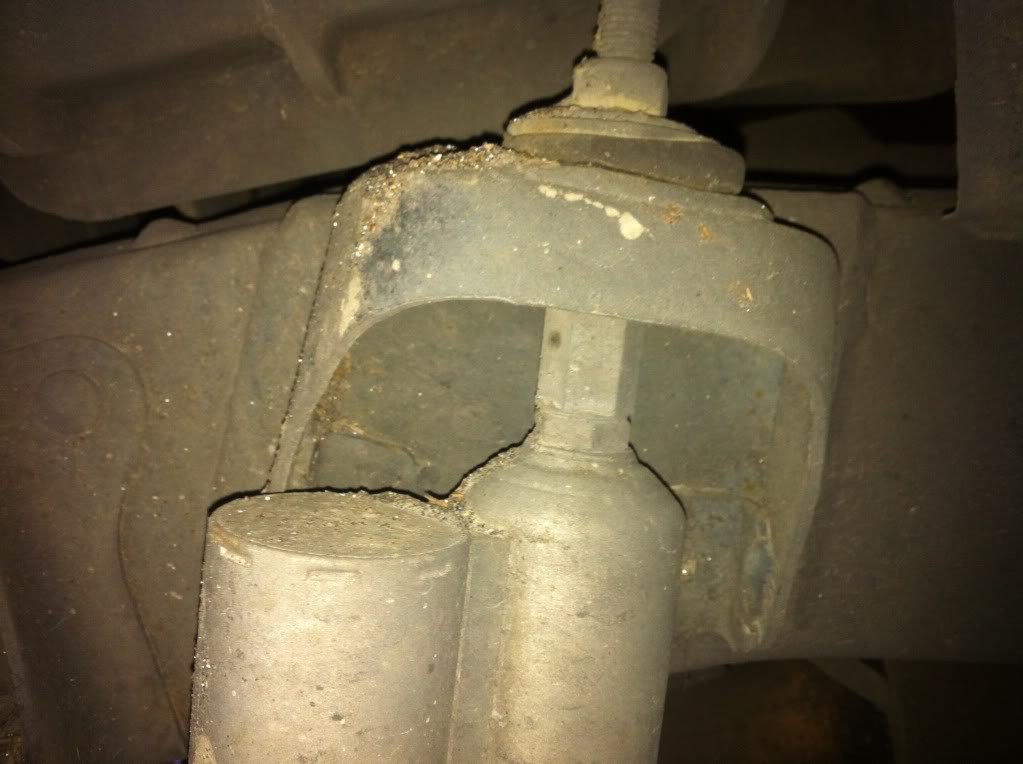

    Bull Bar, Side Steps, Tonneau Cover, Custom heated Black Leather Seats, W/ TRD Emblem, Dual Exhaust, Tacoma Box Mat, Weathertech Floor mats. Toytec Ultimate Lift Kit w/ bilstein 5160's and dakar springs, Goliath 18x9 Rims, and 285/65/18 Nitto Trail Grapplers
    Hey I was wondering if you could post some pics of the 5160s on your truck, I just installed toytec ulitmat lift kit. 3 inch, but seems that the 5160s are too short?!? I put stock shocks in for now, and parked truck till I hear back from toytec. anxious to figure this out as im booked for an alignment on tuesday and finally get my rims and tires on. only difference from you, I have the dakar leaf pack, didnt go with the AAL. any help would be greatly appreciated :)
