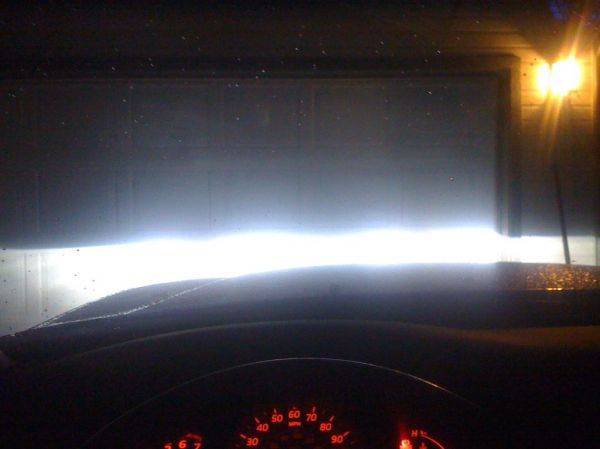

    A 55w outside of a projector style housing WILL provide too much glare, leading to oncoming being blinded and also harrassment from the cops. I would not buy 55W HIDs for a stock headlight housing, i'd do the 35's. If you do a projector light, then the 55's are awesome. I've got them and love them! :)
    Cut off line with projectors:

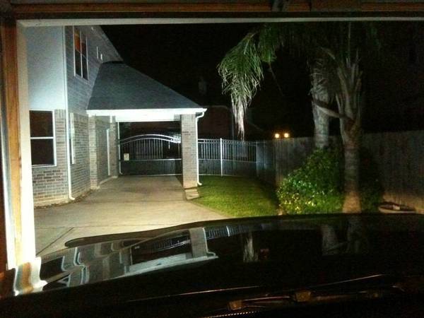

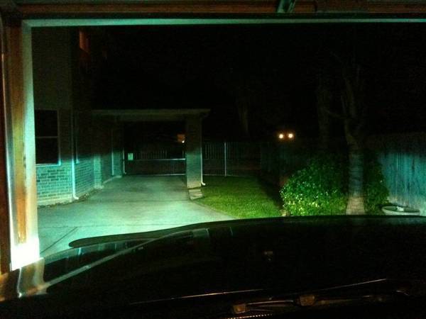

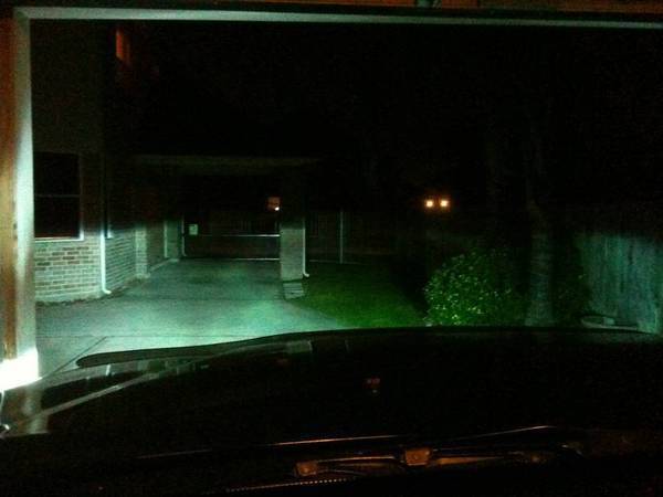

    for whoever was askin..
    35w lows
    35w lows w/ fog
    55w high w/ fog
