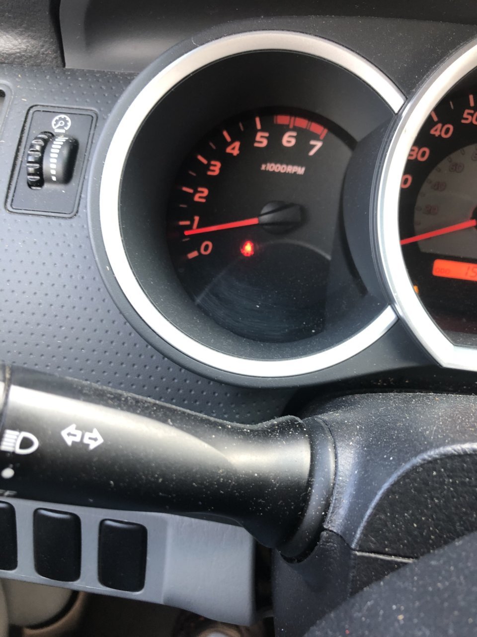

    As for idle. Here is what mine is
    (You aren’t the first to ask about a low idle)
    Dm93 likes this.

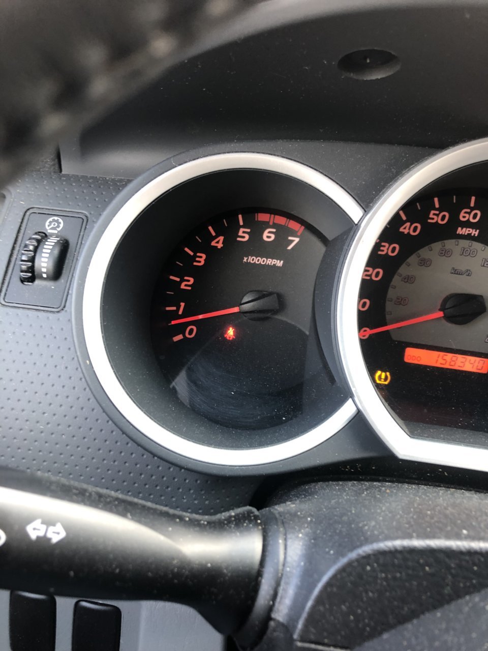

    I say the RPM is normal.
    That is based off my truck.
    Engine is warm.
    Park
    Drive
    Dm93 likes this.
