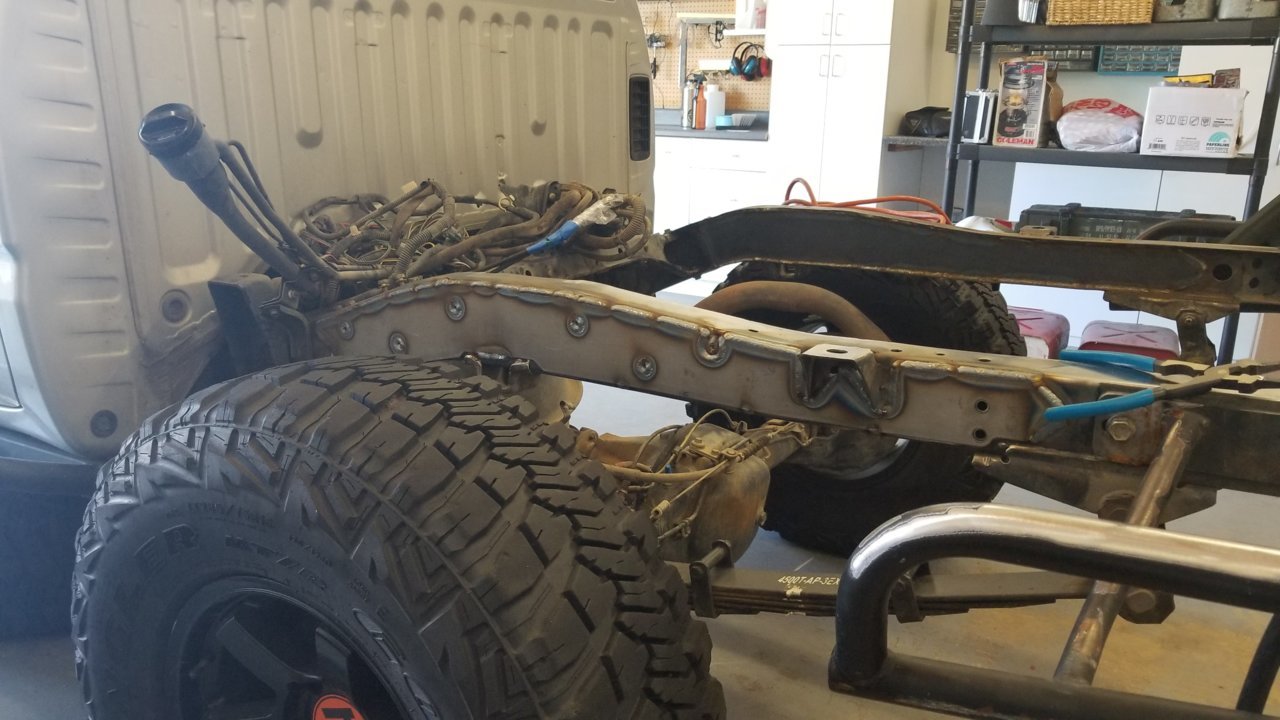

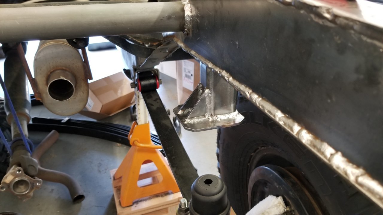

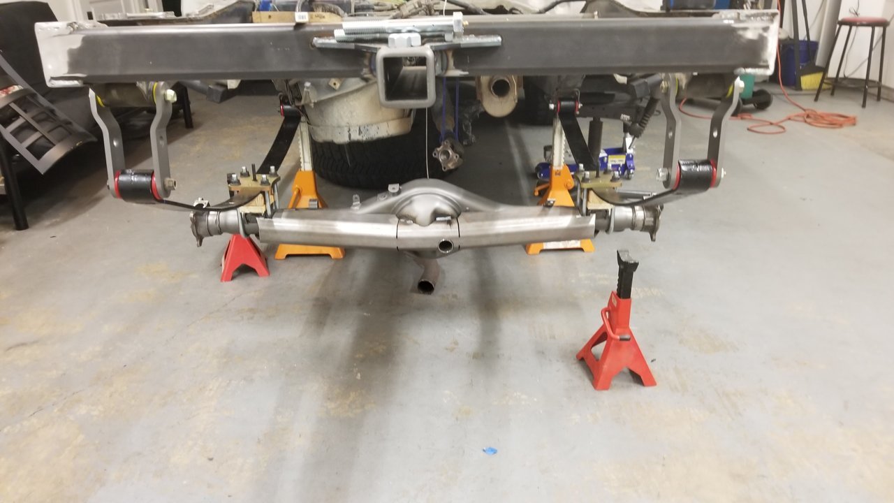

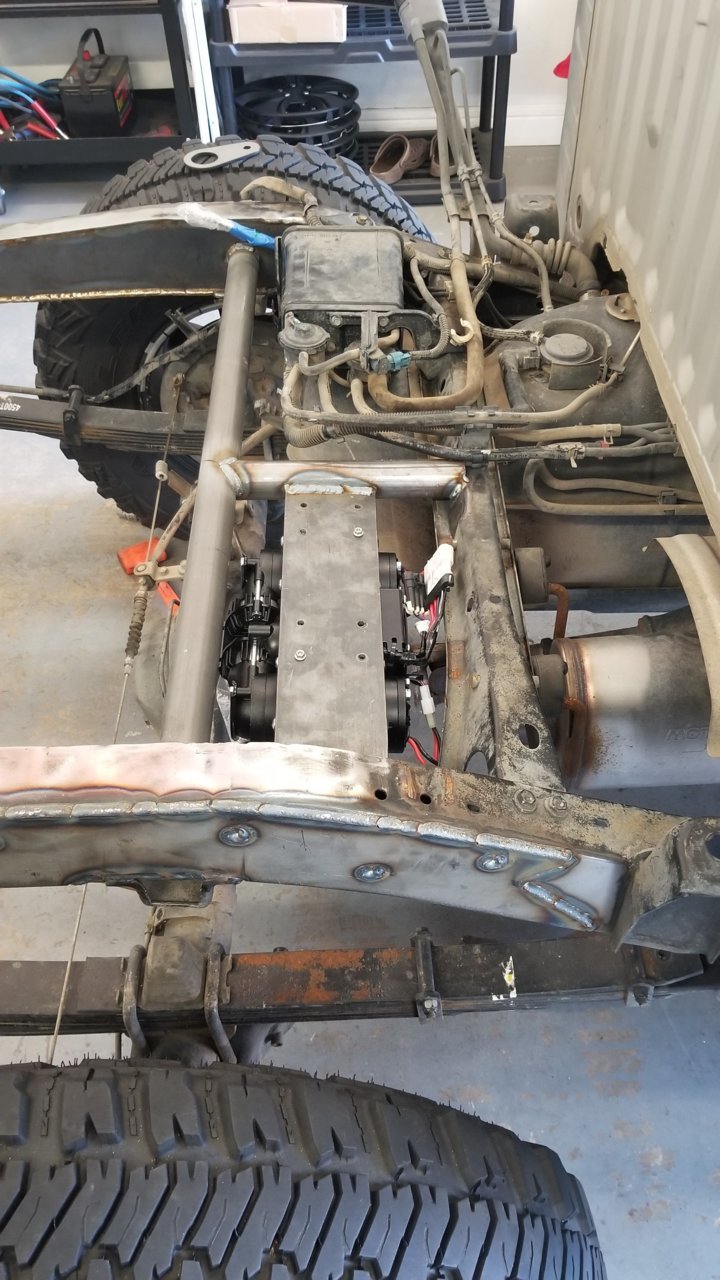

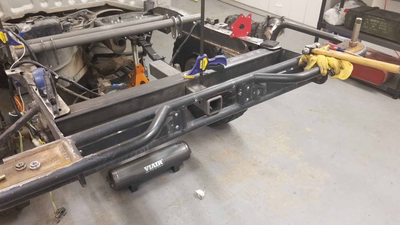

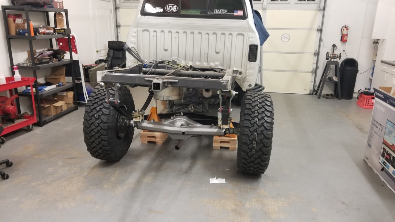

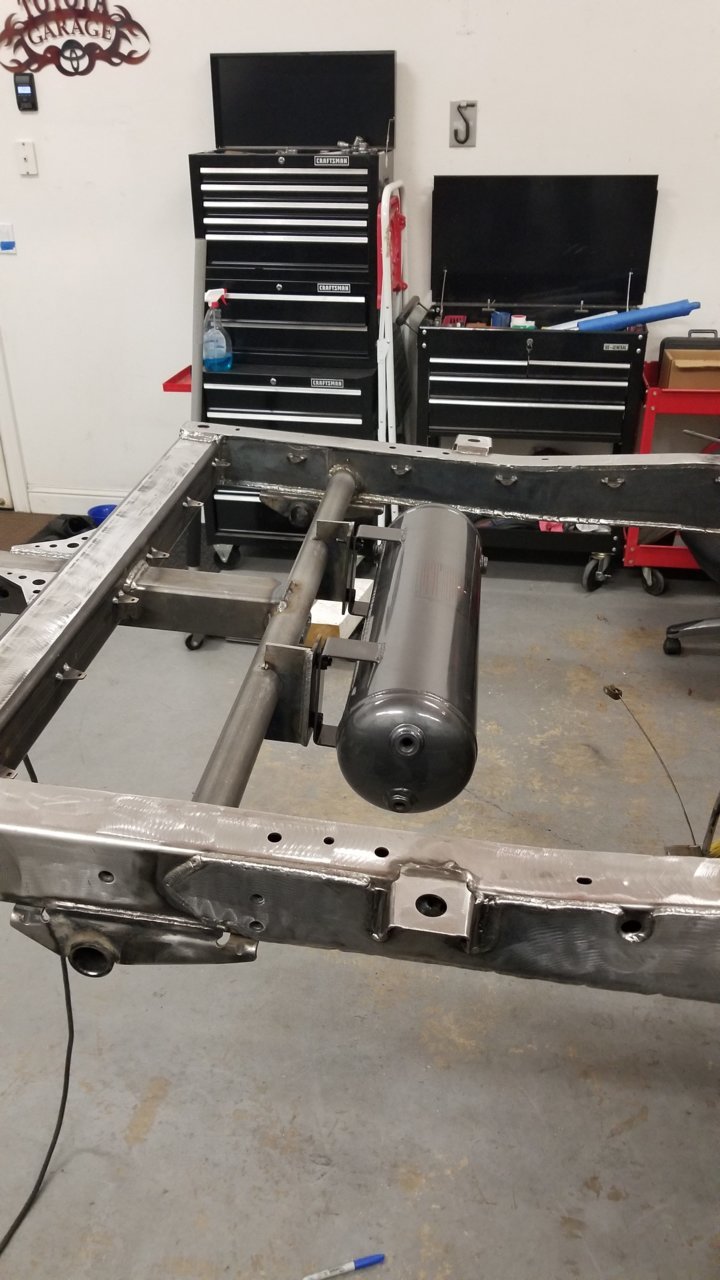

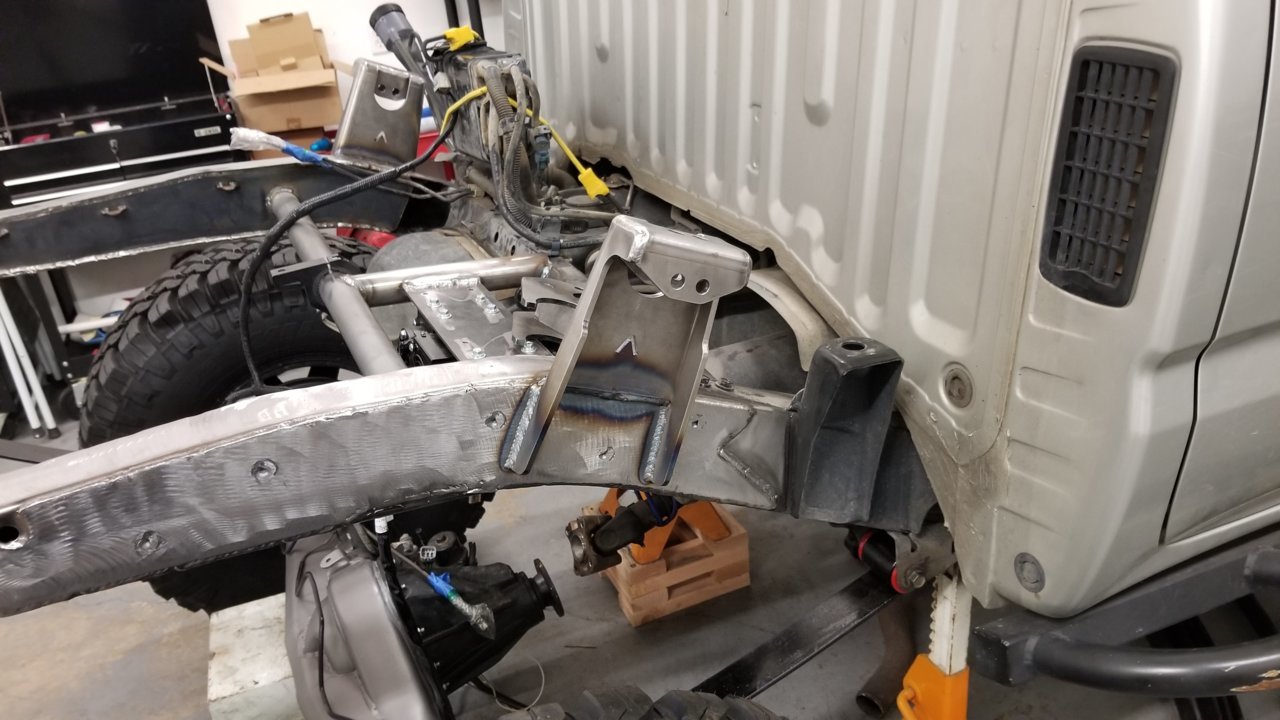

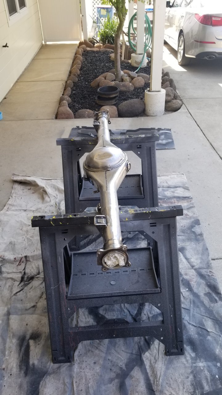

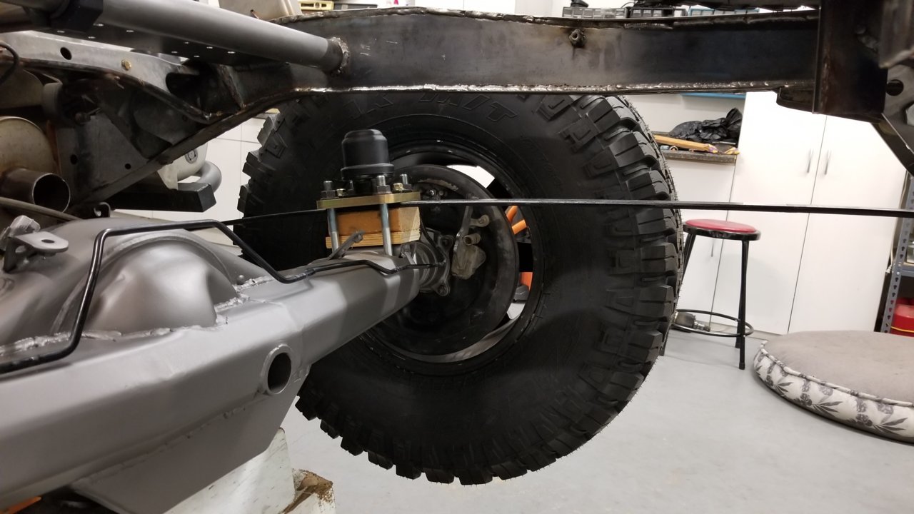

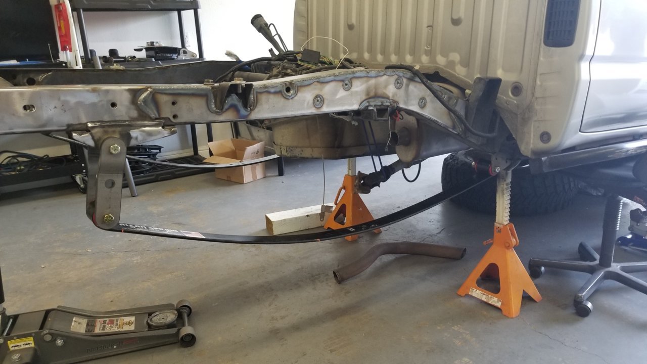

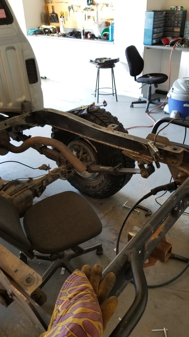

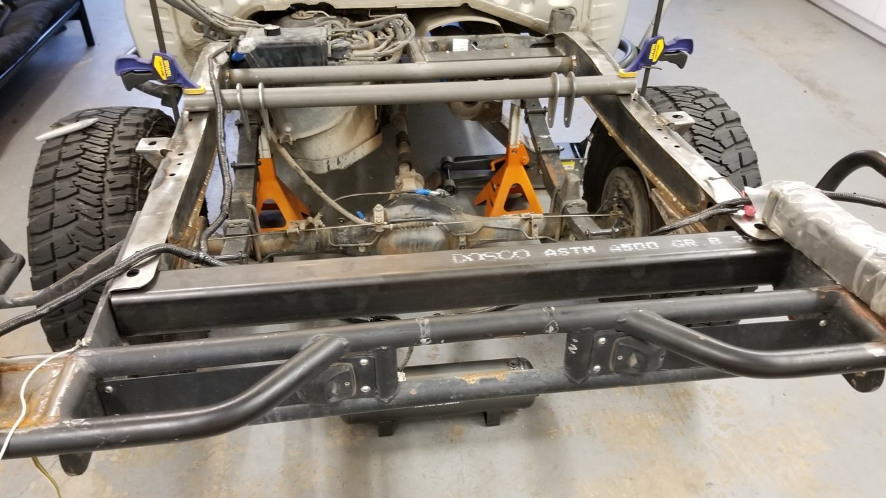

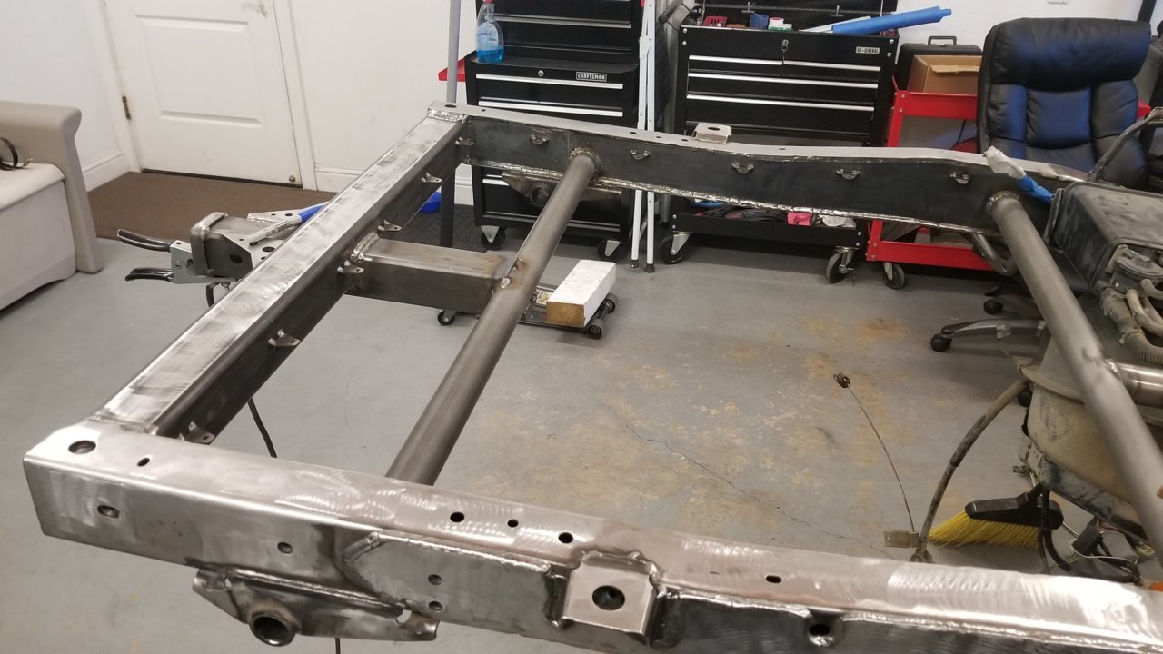

    Probably should update this thread more often. Current project I've been working on:
    Boxing and reinforcing the rear section of the frame
    Arb compressor mount and air tank mount. This should save a little weight with this setup vs my previous 20lb co2 setup.
    Also decided to build a rear hitch into the frame. My last All Poo hitch hung so low I constantly got hung up on rocks
    Also doing new leafs, a shock relocation, u bolt flip and new bump stops and longer shackles.
    I also swapped out my stock 8.4" rear axle for an elocker rear end. I decided to add an axle truss and some diff armor while I had it out and then coated it some steel it.
    On top of all that I'm deleting my abs as well as the lspv.

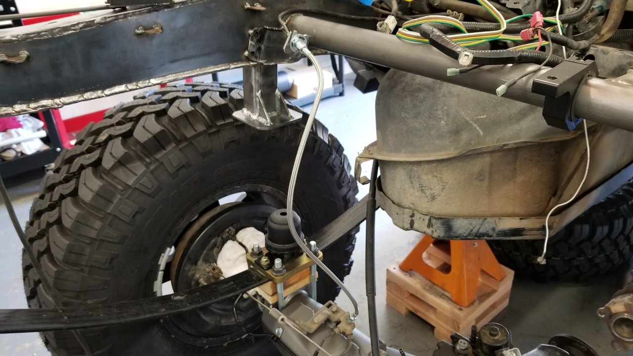

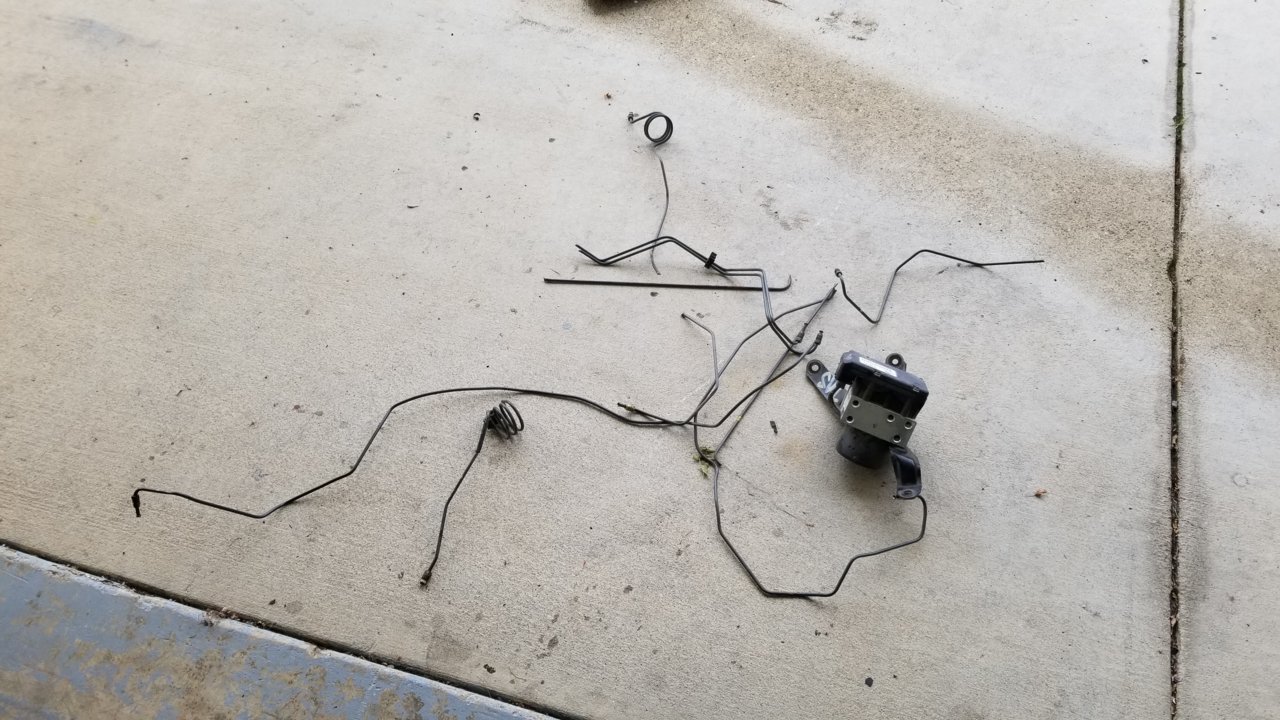

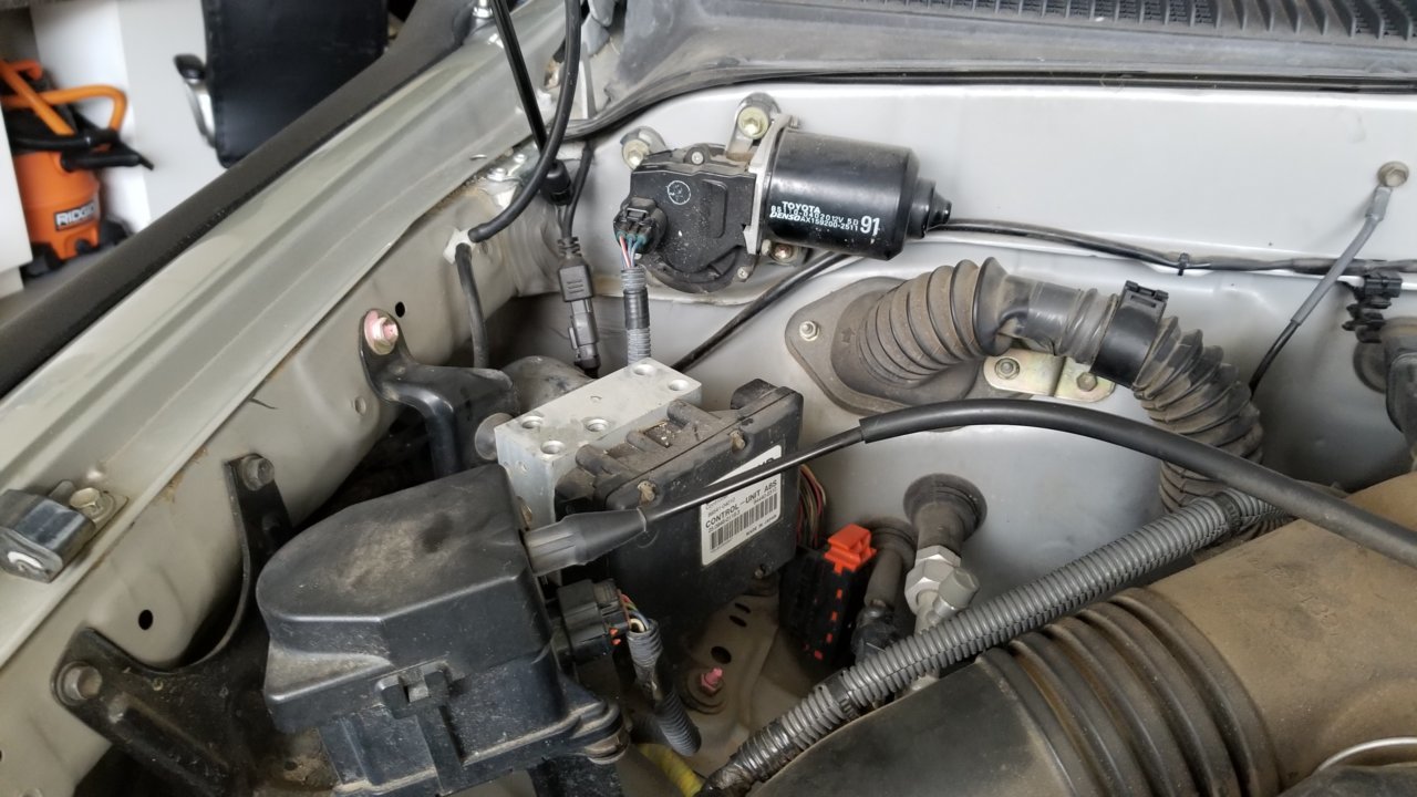

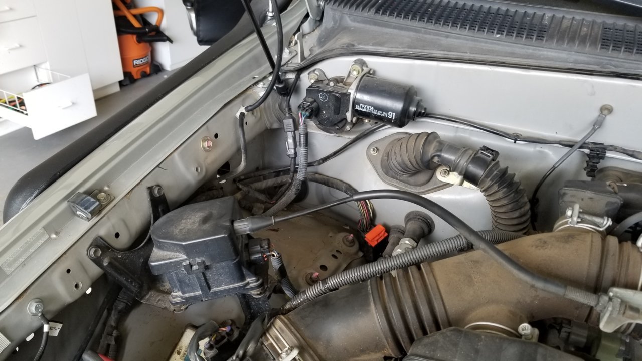

    Got the ABS delete partially done today. Just waiting on the non abs hard lines to arrive and a longer rear break line.

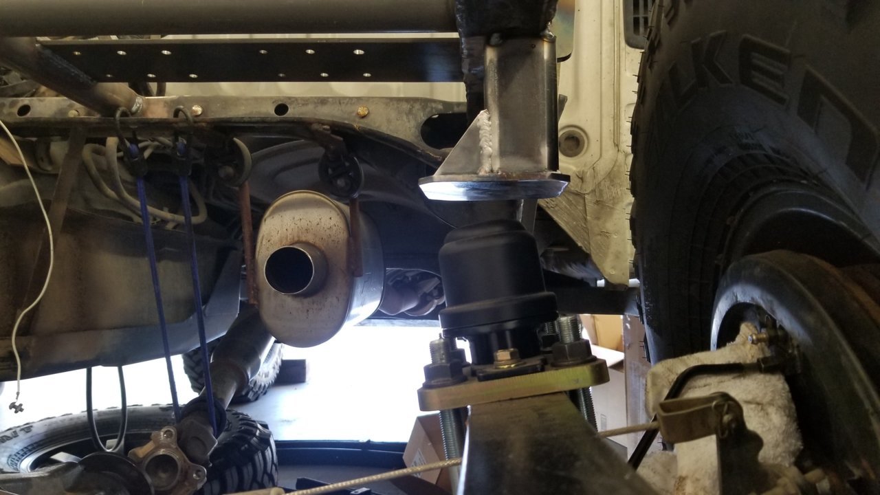

    Got the Front Range brake line and front non abs lines installed and the brakes bled.
    Also got the new bump stop strike pads made and tacked on. I made them a little wider towards the inside so when one side is at full droop and full stuff the bump will still properly contact.
