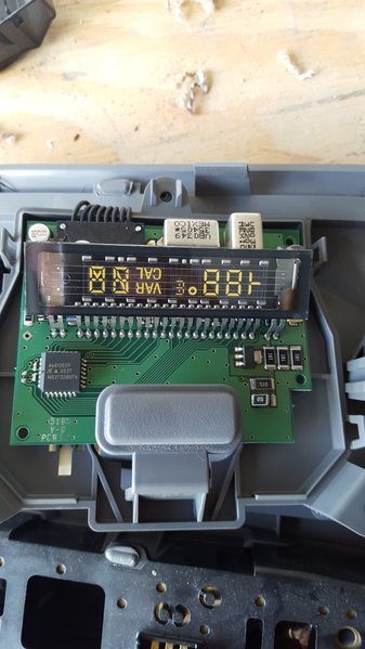

    Finally got around to fixing my temperature gauge and compass.
    Disassembly of console.
    Removal.
    As with many temperature gauges in Tacomas it was the crappy soldering on the 510 resistors.
    (soon to be replaced with my crappy soldering.)
    Don't judge I had never touched a soldering gun before today and I watched 1 youtube video on how to use it.
    Took about 5 minutes for the compass to calibrate and say the true direction my truck was facing.. (north)
    All done, took about 30 minutes or so.

    Oh I would suggest that you open up that thing and run your hot ion couple time at each end of that resistor to remove excessive solders what you done there was pretty much cold solder. Cold solder will fail you in the future when that unit is getting hot, just trying to help

    thanks! ill definitely do that.
