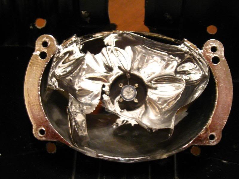

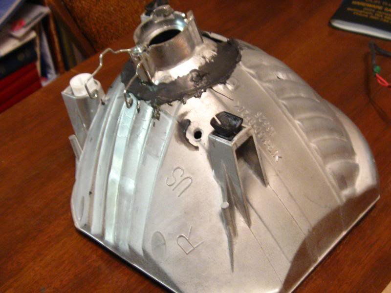

    Dangit... This is getting really, really old.
    Finally found the time to pull my headlights apart; I suppose this is the reason why the out put has been around the brightness of a fart for the last 6 months...
    What really sucks is that TRS told me that I wouldn't have any issues with running the FX-Rs and 55 Watt Ballasts. In fact, they pointed me in that direction after having the same exact problem with the Mini Morimotos.
    What really really sucks is that the reflector bowls are JB-Weld'd to the headlight housings.
    Composing an email to TRS soon. All of my dealings with them have been positive thus far; and I'm sure that they will make good on the situation. I know it's an acceptable risk when altering ANYTHING from OEM state... But, come on guys???

    "Sorry to hear of the issues you're having. The 50w ballasts to sometimes cause reliability issues with some parts over the long haul.
    If you're looking to do another retrofit, you could certainly keep your working 50w ballasts, but I would recommend going to an OEM projector which have a lower failure rate than aftermarket projectors, most notable when using 50w ballasts. The RX-350, which we have on sale, would be both a solid upgrade and solve your issues I think.
    Again we could also extend a discount on the new FX-R's if that's something you'd like to do.
    Let us know and we'd be happy to help!"
