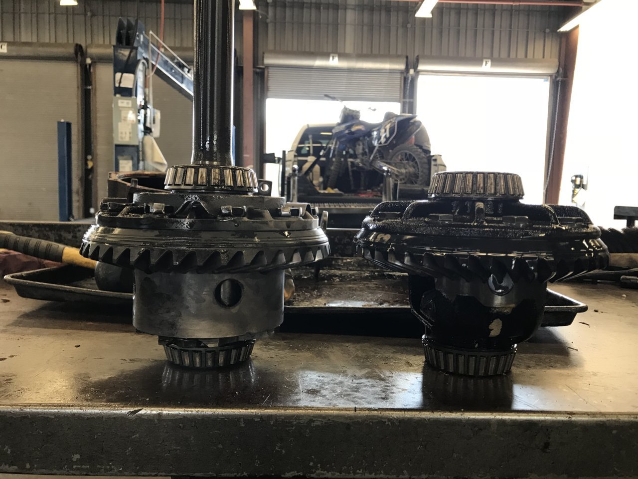

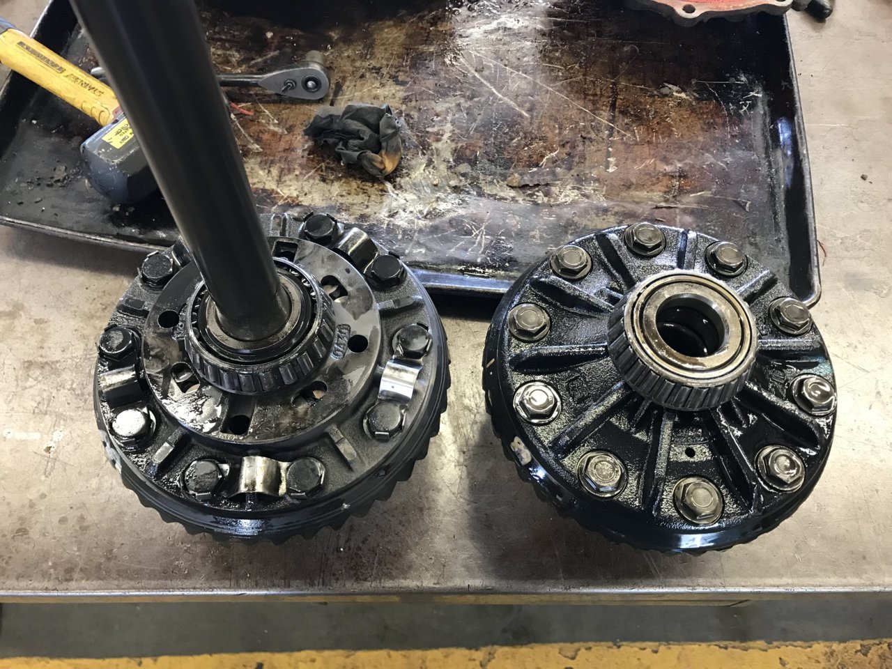

    Here are a couple money shots to hopefully makedo in the interim. The FRS torsen unit is on the left with the non-ADD intermediate shaft seated nicely inside.

    I am not sure I follow what you are doing with the two diffs in your picture. Are you trying to mount the ring gear on the right diff onto the left diff? it's difficult to be sure from your picture, but the ring gears look to be opposite rotation. Is that an issue, or is that what you are trying to accomplish?

    Yes the ring gear from the right diff does fit on the left diff, aside from the bolt holes being too small for the bolts to secure the ring gear. The diff on the left is a rear diff from a Scion FRS, the diff on the right is a front diff from an FJ Cruiser and yes the rotation is reverse because of this.

    I have not completed the swap and closed everything up yet, but everything appears to line up as necessary. The key pieces being:
    1. The carriers having the same dimensions, which you can see from the picture they do.
    2. The carrier bearings fit into the clamshell; which isn't pictured, but I assure you they do and can be verified from documented bearing dimensions.
    3. The axle shafts fit into the carrier, which you can also see in the pictures above.
    I'm going to pack up the diff and send it off to be rebuilt, and once it is there will be plenty more pictures to confirm all of this. I'm feeling 99.5% confident at this point.
