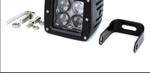

    Can someone measure the U-shaped bracket that most LED pods come with? I need the outside to outside measurement of this bracket at the mounting holes:

    I can get you a measurement later today. FYI though, many of these brackets are actually slightly wider than the internal mount, so the bracket needs to be ‘squeezed’ to fit the mounts of the pod.

    I’m wondering if my PIAA LP270’s will fit the CaliRaised pod mounts. CaliRaised said they wouldn’t work, but didn’t give me the measurements.
  9. Feb 6, 2018 at 5:20 PM
    #29
    crashnburn80
    crashnburn80 Vehicle Design Engineer
    Jun 6, 2015
    #156893
    14,772
    Kirkland, WA
    2003 DCSB TRD OR
    Pods mount from inside the pod, looking at the fins on the back, it is the inside of the outermost fin. Those PIAAs mount on the outside of the body. They are not going to fit. If wanting to run PIAA fogs the LP530 would be much easier as they are a direct bolt on with the PIAA Tacoma fog mount kit. You could see if the PIAA Tacoma fog mount kit is compatible with the LP270.

    59.4mm when installed.

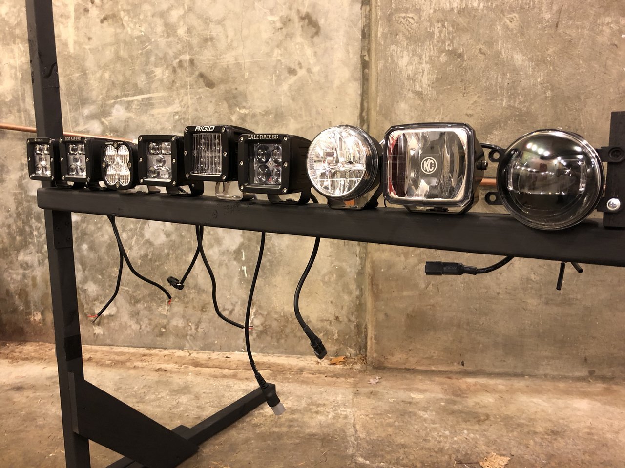

  14. Jun 11, 2018 at 2:27 PM
    #34
    unlewser
    unlewser Well-Known Member
    Jul 19, 2013
    #108617
    627
    Tempe, AZ
  15. Jun 11, 2018 at 5:05 PM
    #35
    crashnburn80
    Jun 6, 2015
    #156893
    14,772
    Kirkland, WA
    2003 DCSB TRD OR
    Yep, I have all the data and pictures and am working on putting together the writeup. Just haven't had nearly as much time as I would like to work on it. There is a ton of info to present. If you have any specific questions I'm happy to help you out, you can shoot me a PM.
