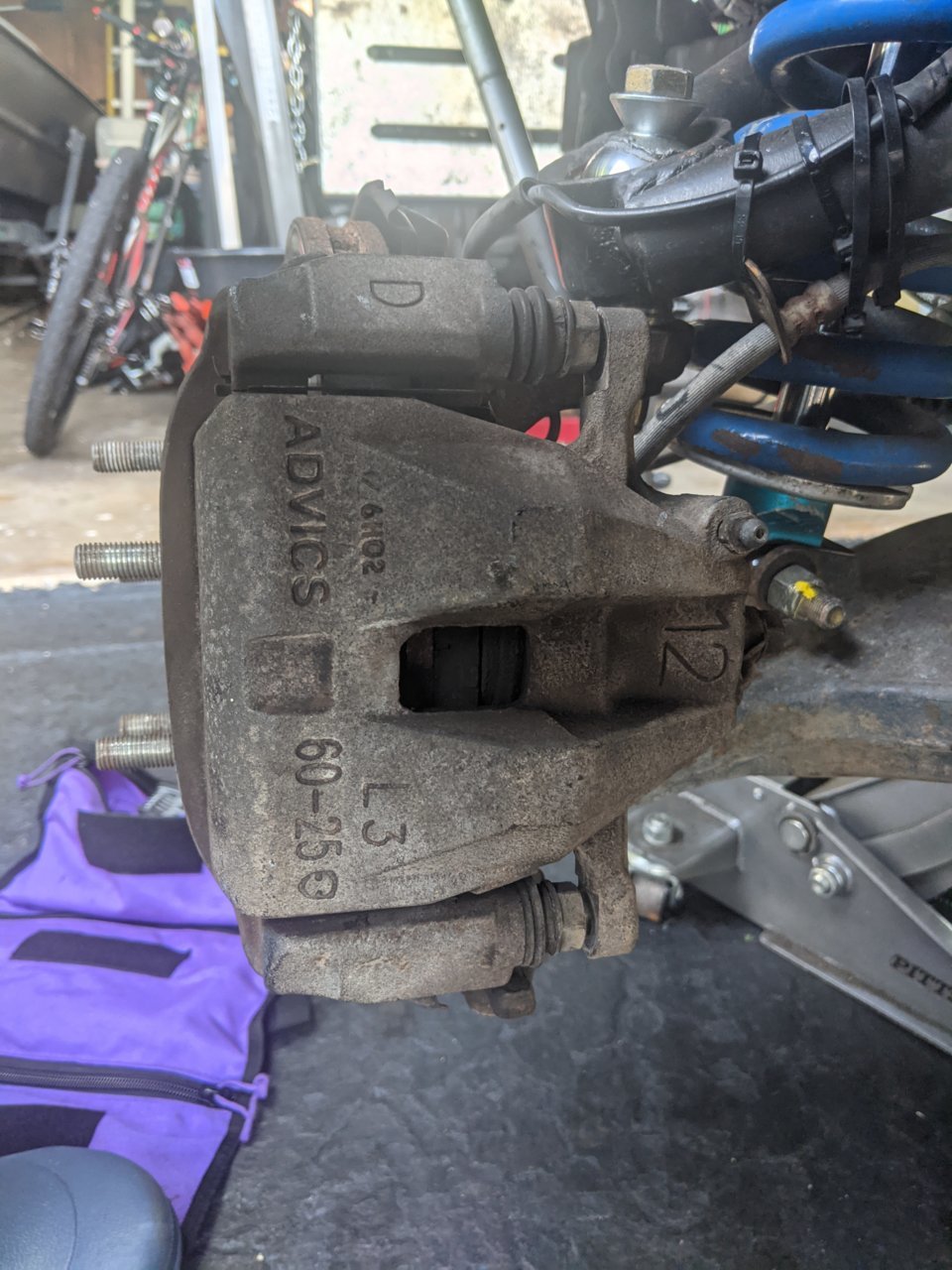

    My calipers were the original Aisin Advics 60-25 with a single brake piston.
    Are there any calipers that fit without any changes on the original mounting points with double pistons?
    These brakes are so spongy and undersized. Even a small improvement would be so nice...

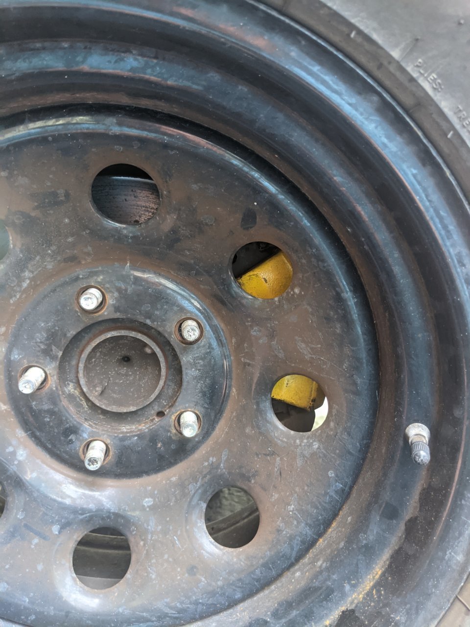

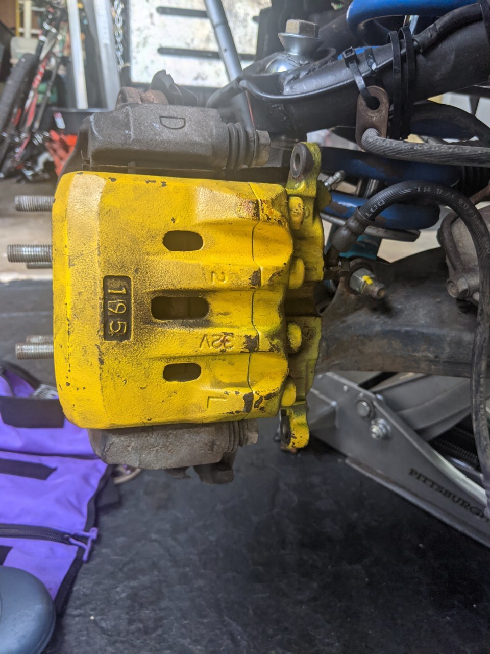

    So I've been looking into what can fit under our 15" rim (going bigger there's more options) and I think I've found a 2 piston caliper that will fit after alittle bit of spacing. I plan to swap my rotors and pads first and then see if the 2 pistons make a difference.
    Here is a couple of pictures from me mocking up
