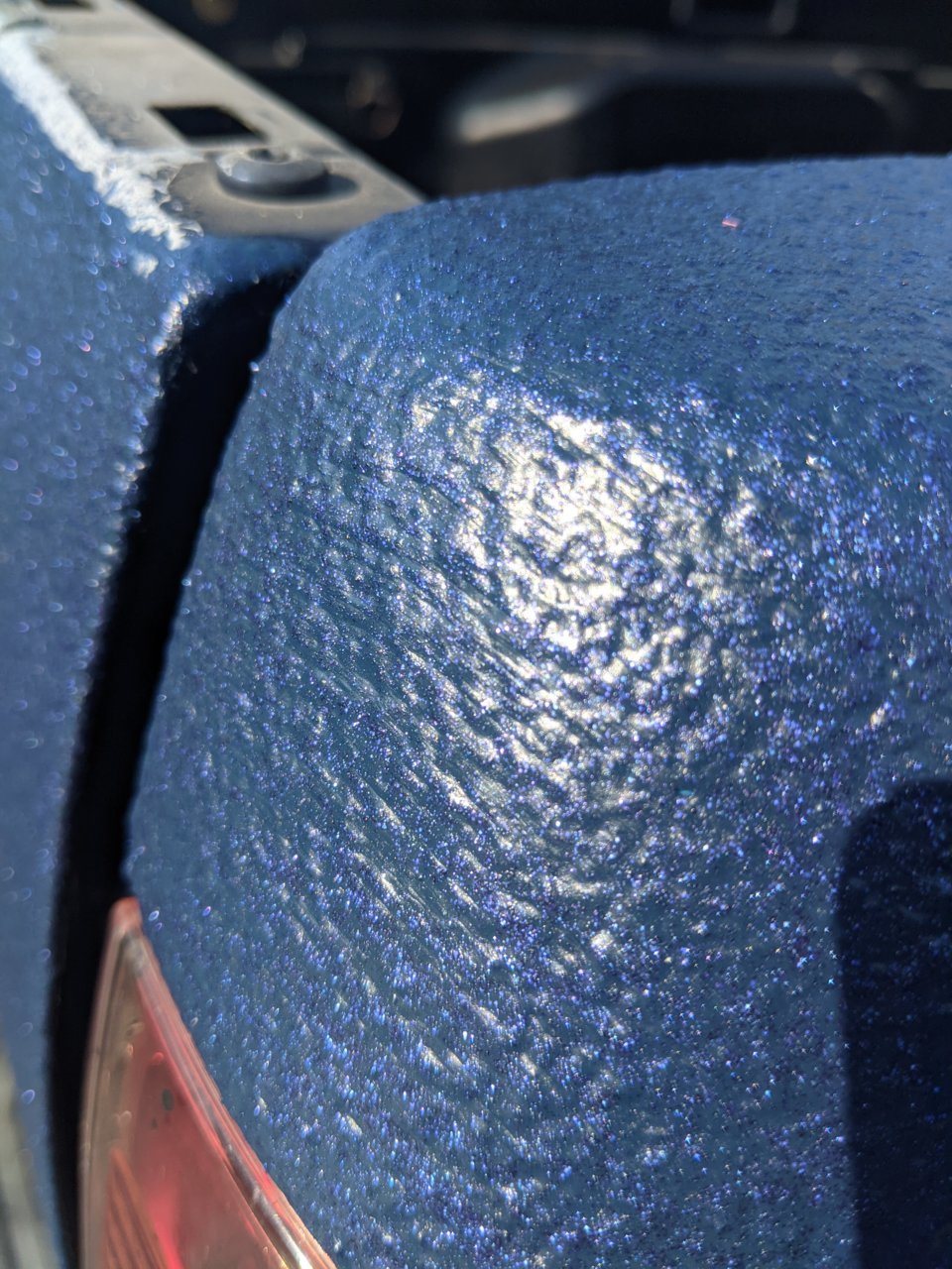

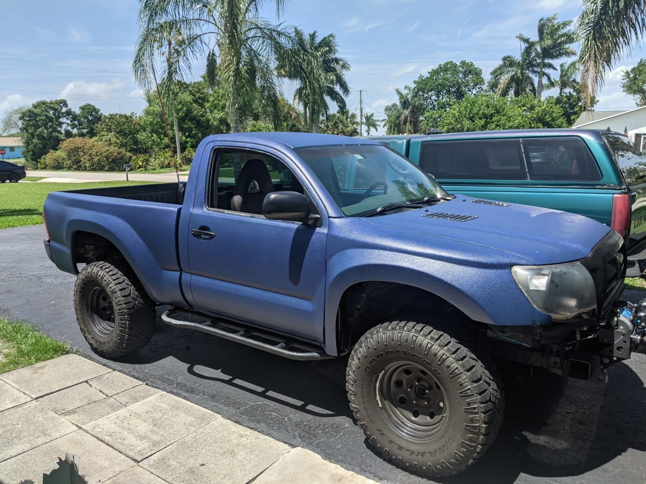

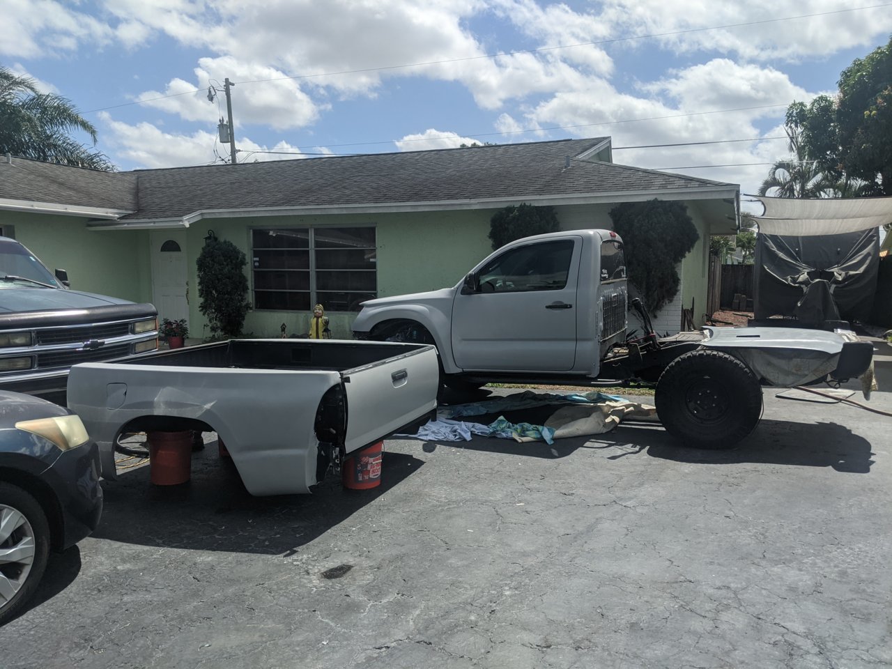

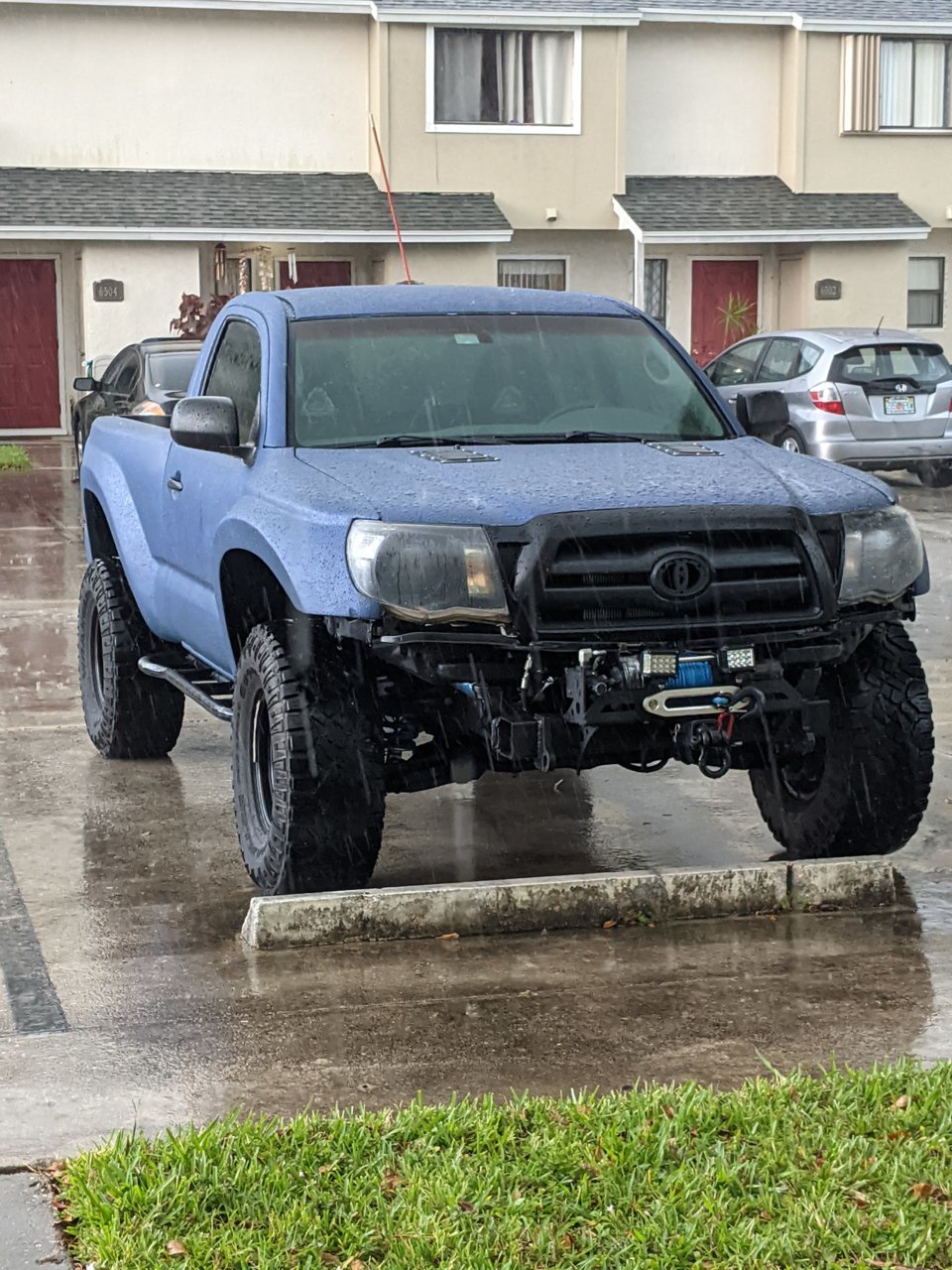

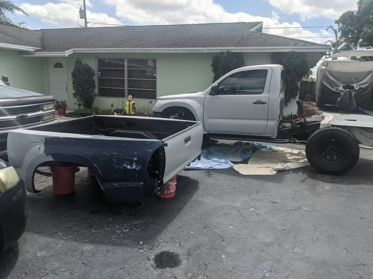

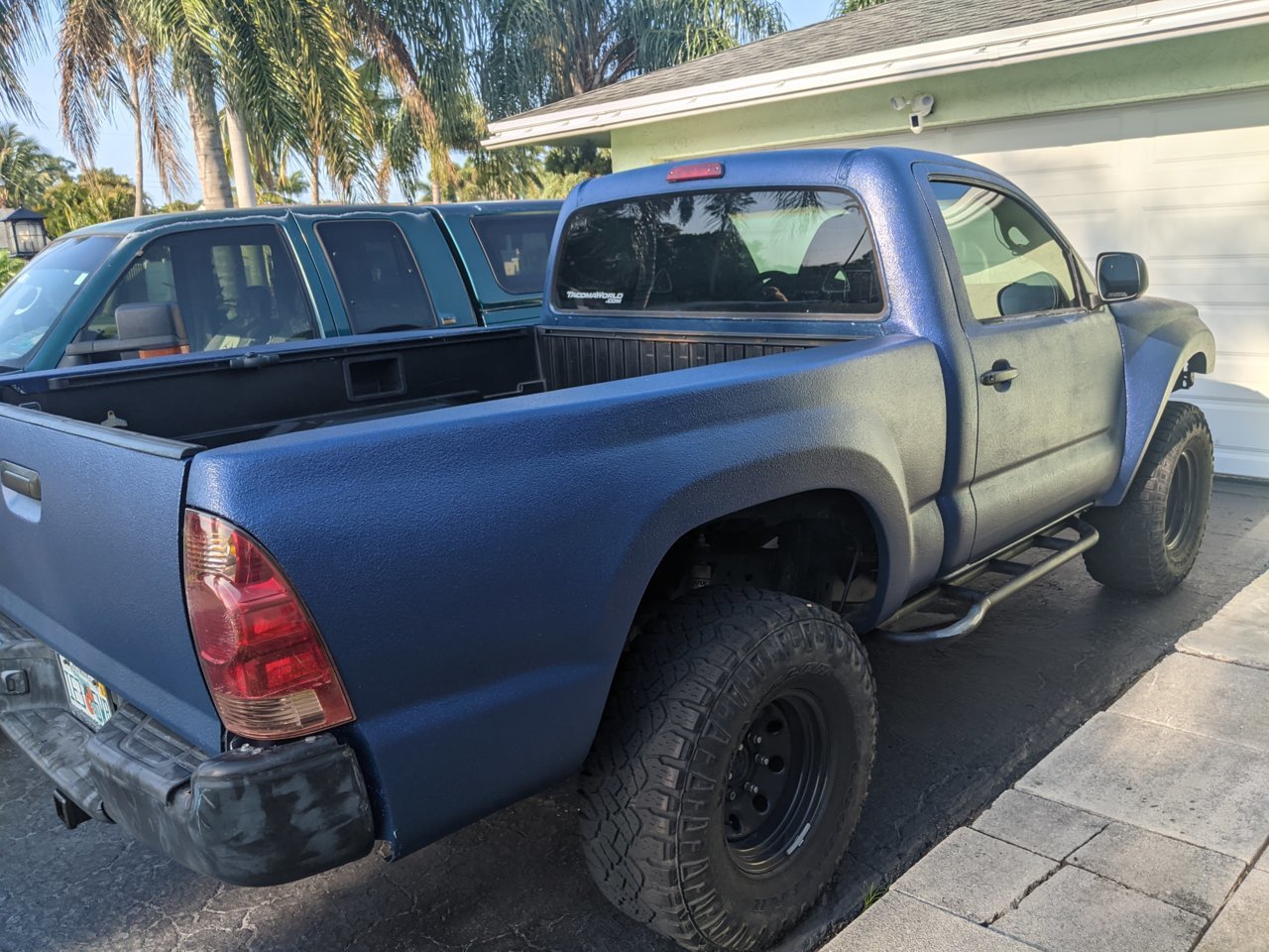

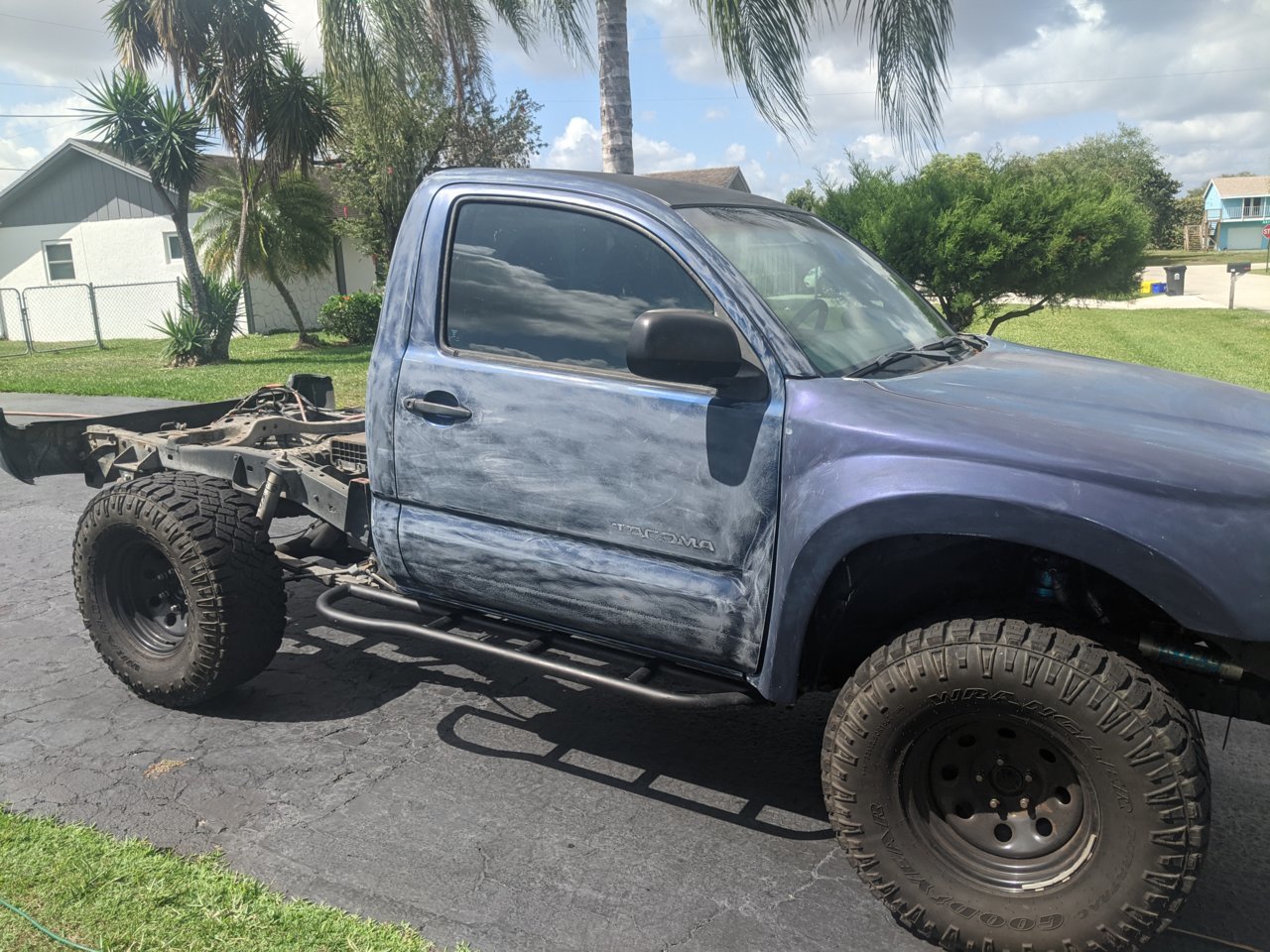

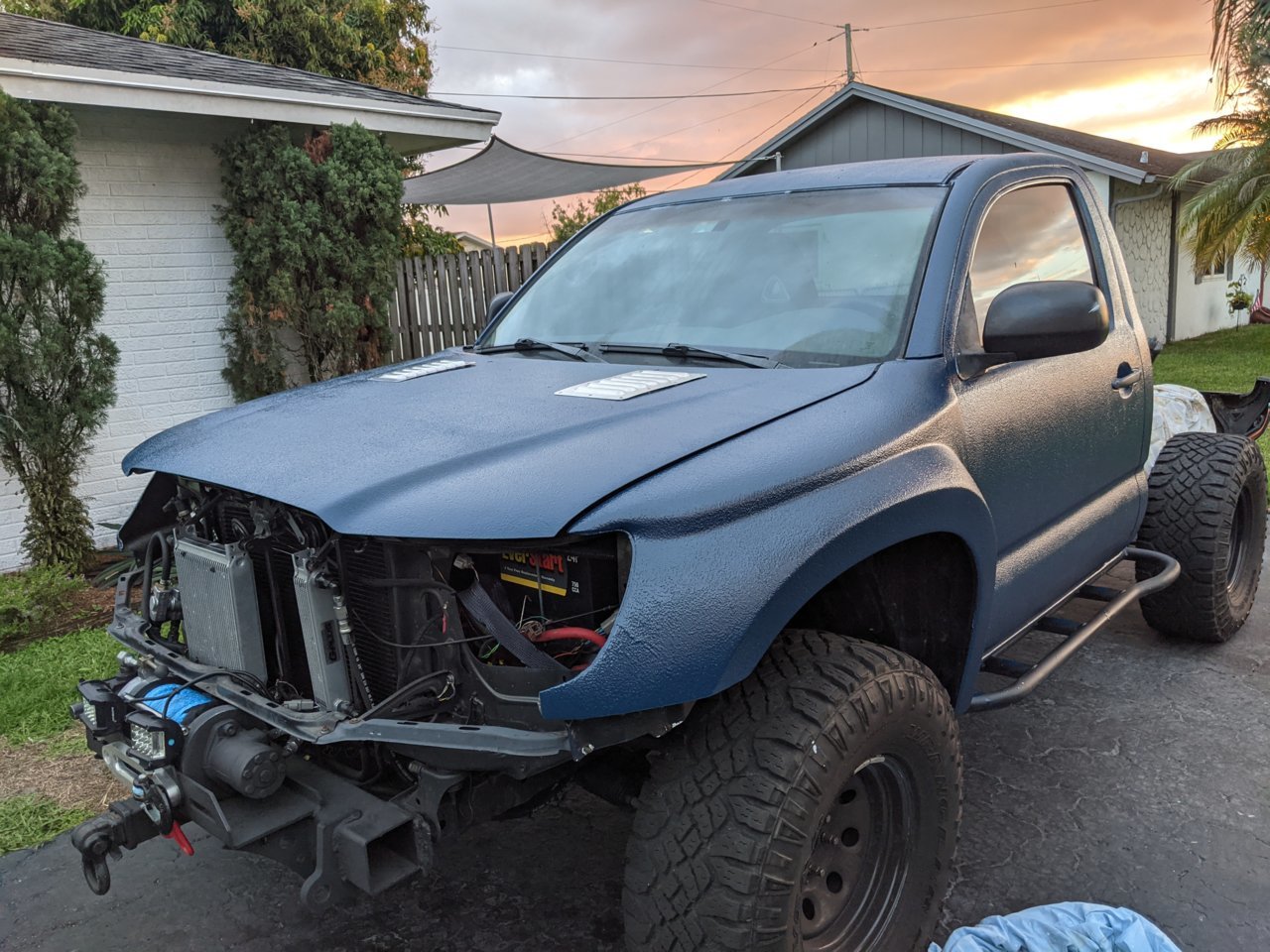

    Soooo I finally painted the truck. I went with monstaliner with the color midnight special and then did a clear coat of the same liner with a mix of indigo and midnight blue metal flake. Here's a picture dump lol

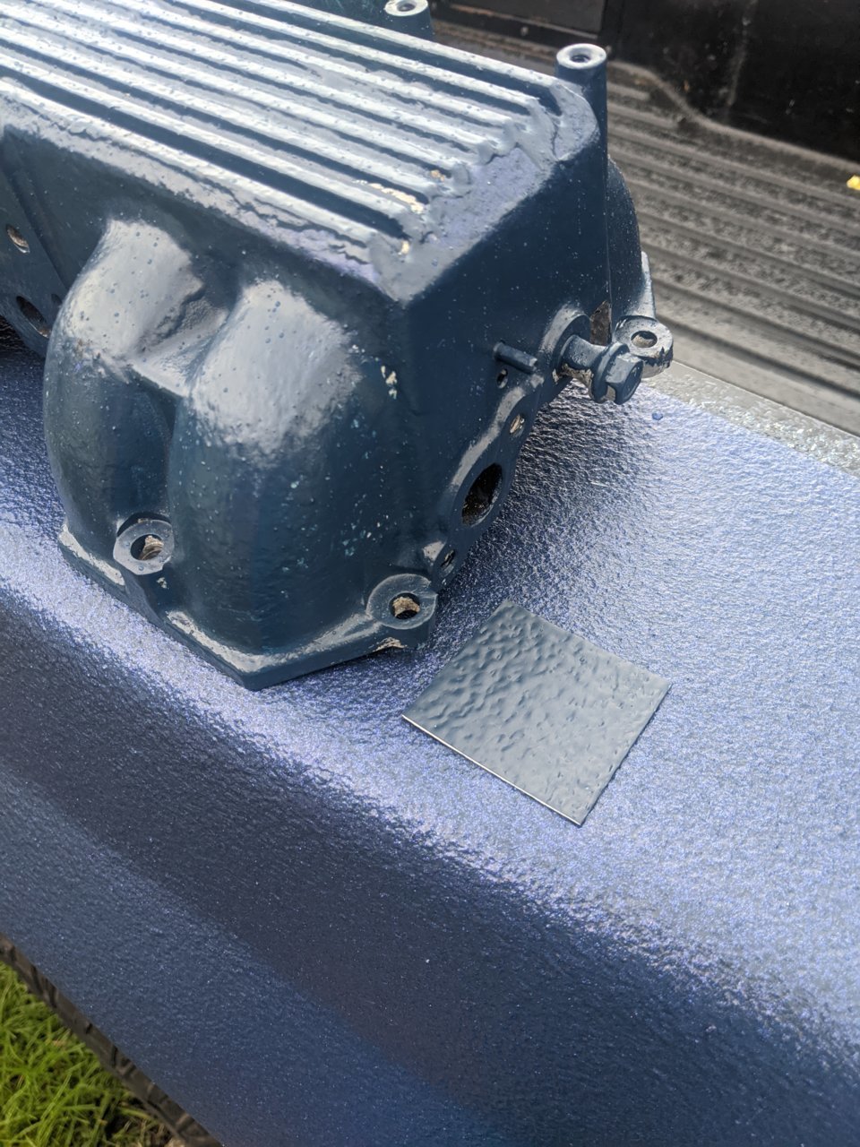

    First color of midnight special no flakes
    Beads very well

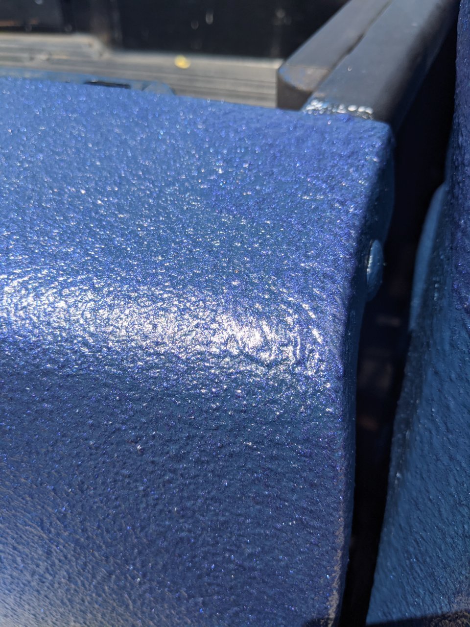

    Final color with metal flake clear coat
    Colors side by side

    What pressure did you spray the liner with?

    I rolled it with their specific blue roller.

    How much of the liner did you end up using? Curious if it was gallons, kits, etc? can you shed some light?

    I used 2 gallons of tinted for color and 1/2 gallon of tinted but with no color for my sparkle coat. I also used 1/2 gallon of their epoxy primer for my primer

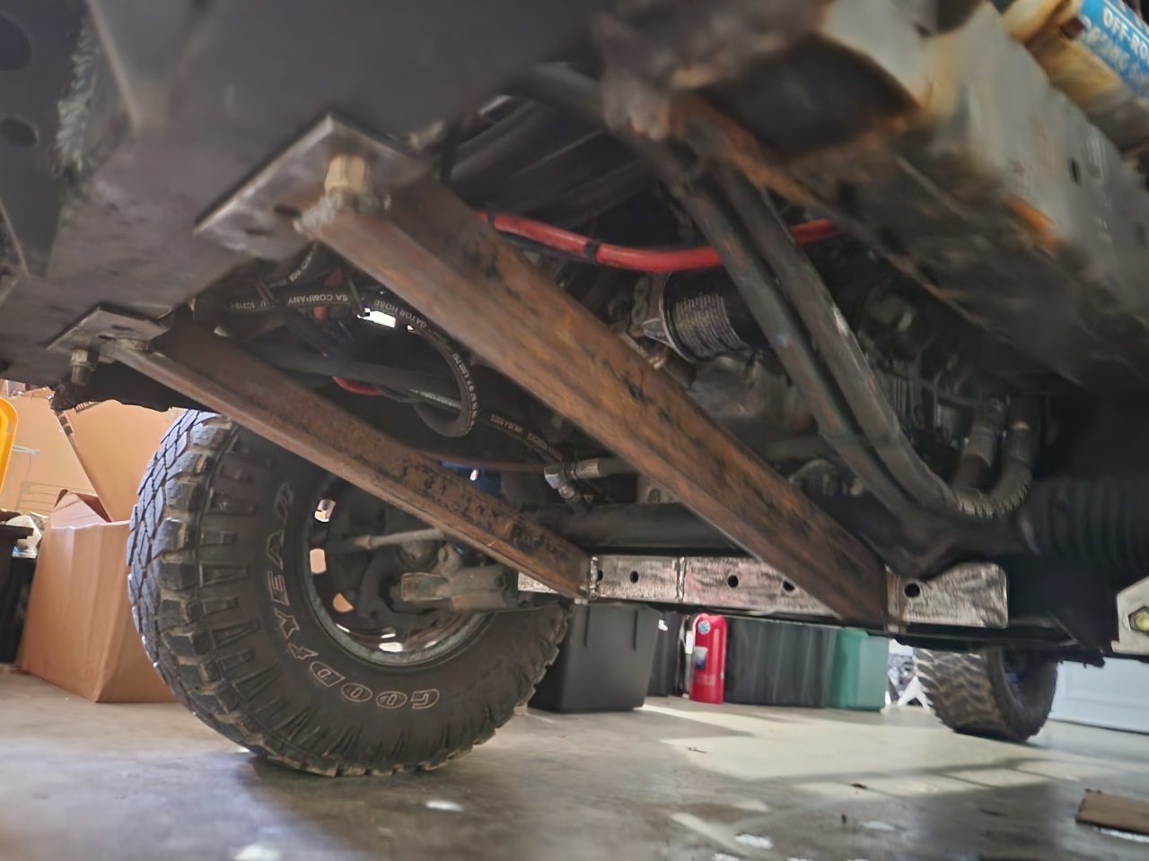

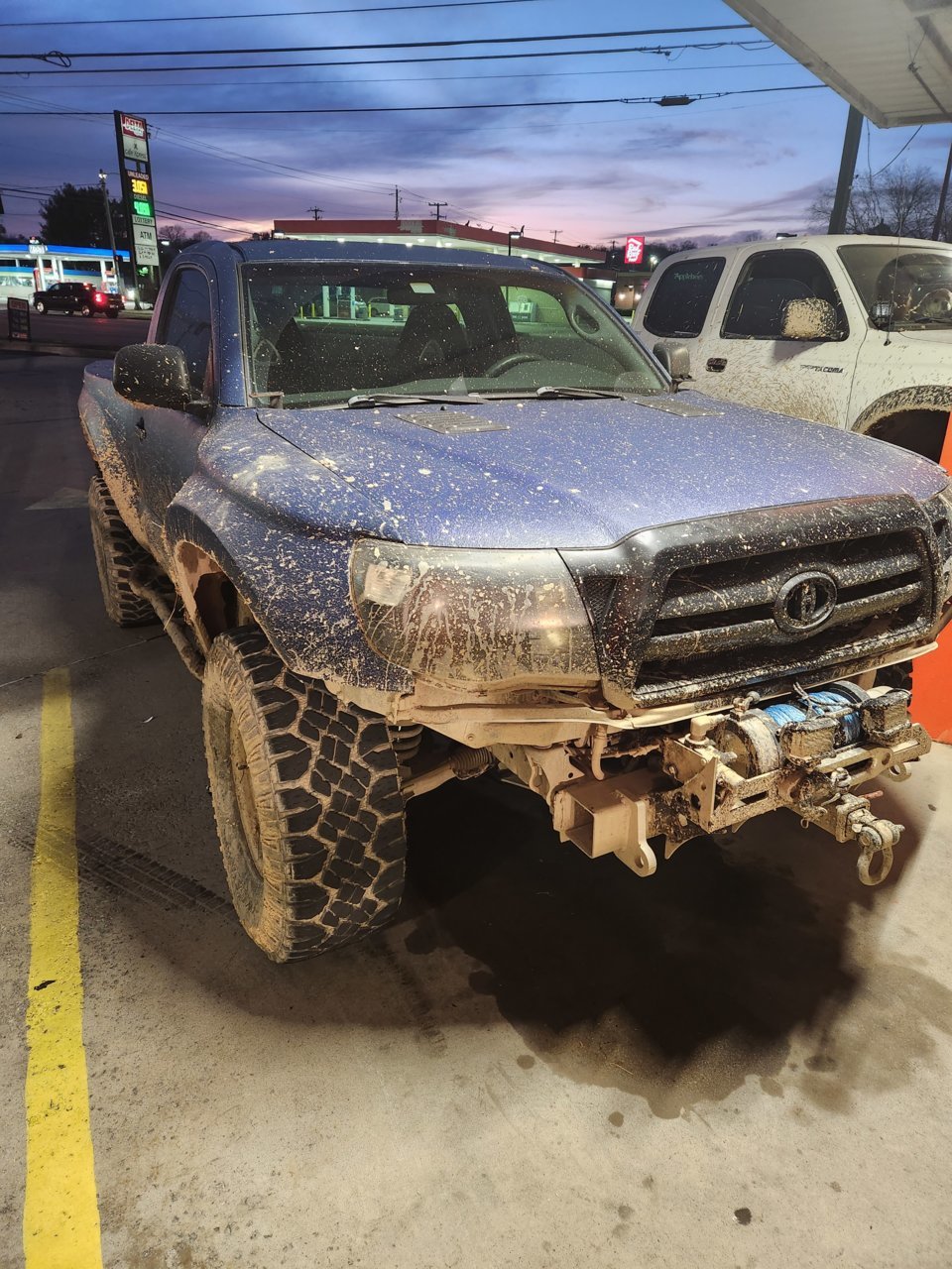

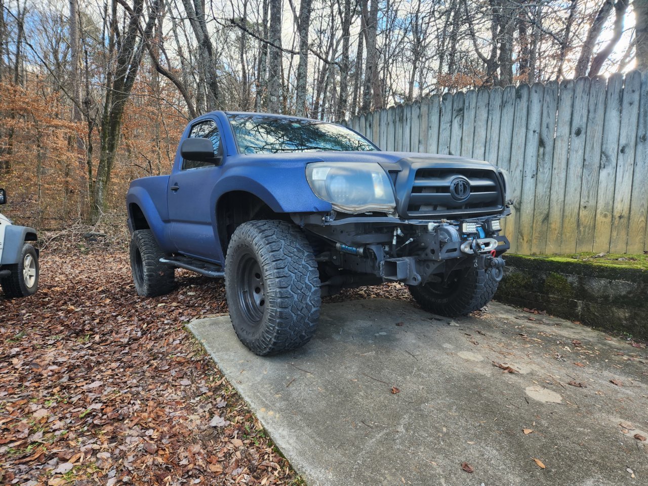

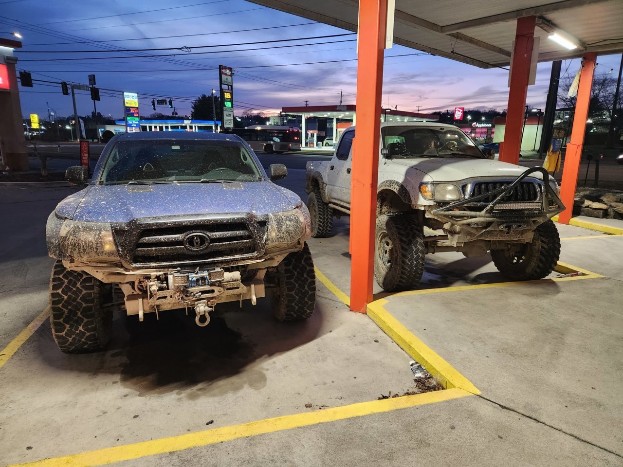

    Soooooo I moved out of Florida and am about 40 mins from Windrock. Which means it was time to build a new skidplate and get out there and send it.
    Didn't get a picture of it fully assembled because I finished late the night before the trip lol. It uses angle iron and 2" square tubing for the main structure and a sheet of hdpe for the actual skid ($41 a big sheet of 1/4 hdpe from grainger)
    Go pro didn't charge so I didn't get any action shots but I sent it hard up a blue trail and did pretty well. I would say I was able to do about 90% of it as a 2wd with a locker and the other 10% I was pulled through.
    Plan on going out again soon just need to fix a few small things and add some wheel well liners because there was alot of mud where the sun don't shine. The next plan it to hit as many of the green trails as possible

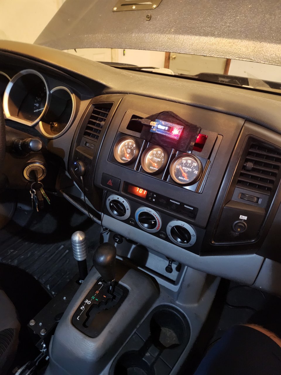

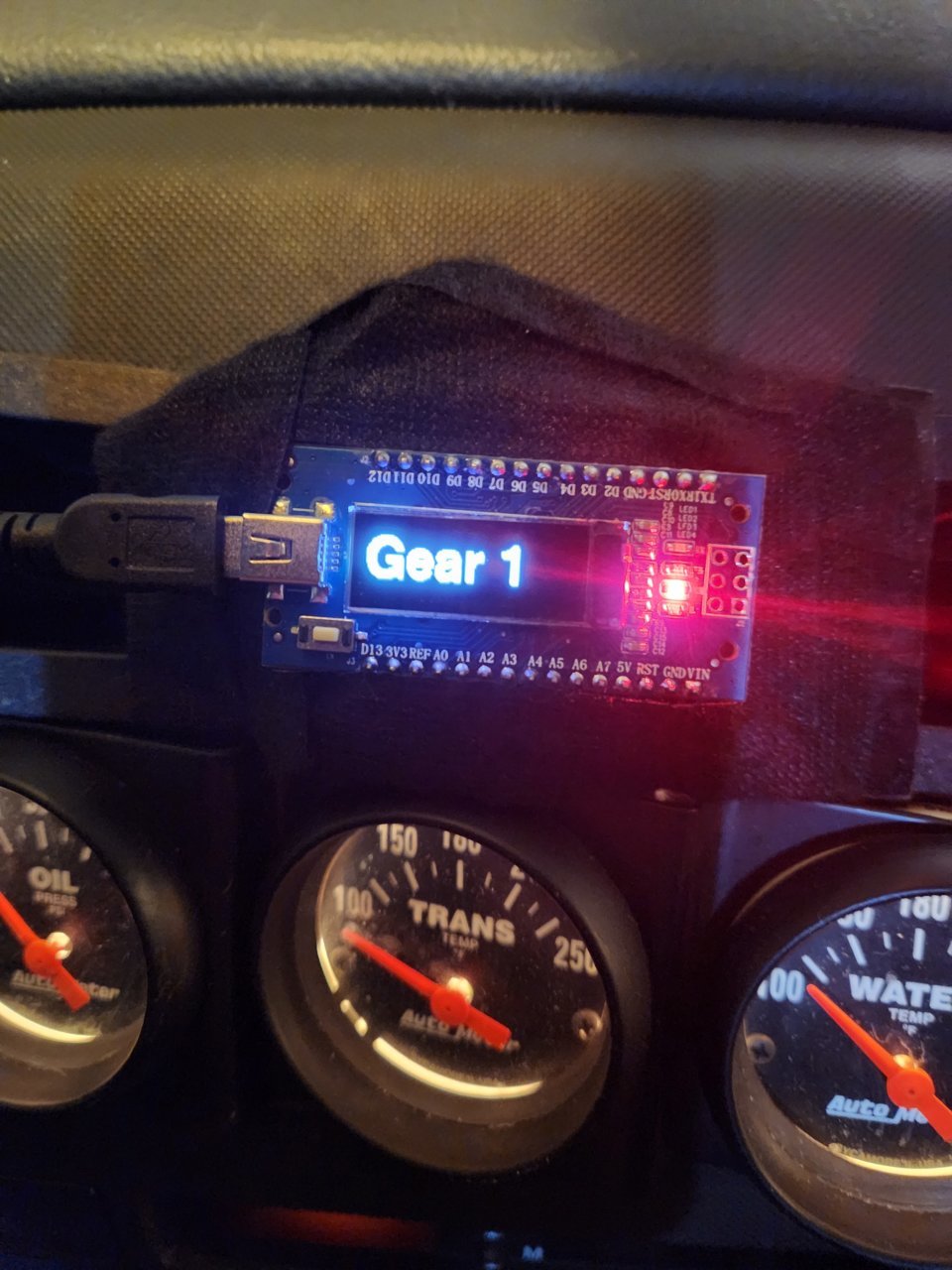

    It's been good especially in the cooler weather. I forgot to mention I rewired my trans a bit and now it's sequential shifted. Put the shifter into D and use then use the push pull shifter. Could have done paddles but where the fun in that lol

    I'll ask for everyone else who's gonna think it. Video of that gorgeous sound! Bummer about the gopro, but now you have an excuse to go to Mexico and show it off :D
    That shifter setup is pretty sweet, what are you using for a controller that lets you sequentially shift it?

    It's for the front. I cut and moved my front crossmember up alot so I needed to redo the skid frame. I'll post some more photos once I bolt it back up. At some point I'll make a gas tank skid tank as well.

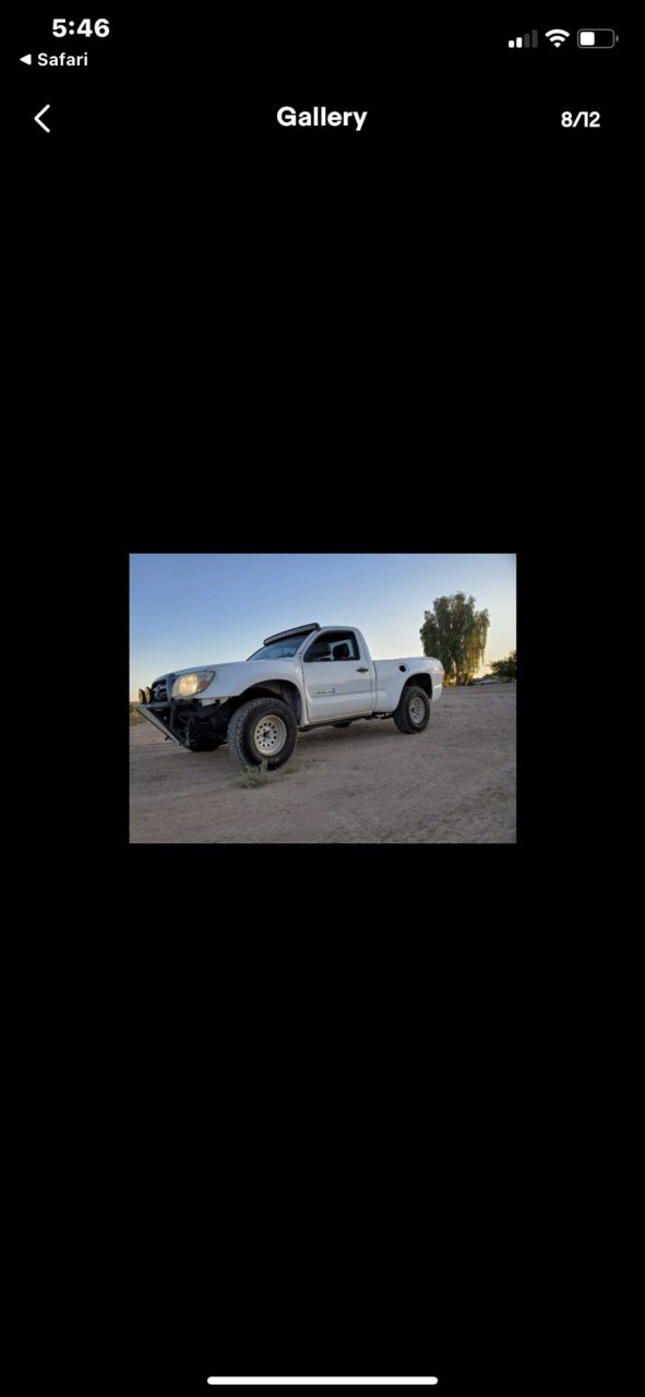

    1999 White Tacoma Base
    Exhaust
  17. Feb 8, 2023 at 11:36 AM
    #237
    5 Lug Fury
    5 Lug Fury [OP] Well-Known Member
    Nov 21, 2014
    #142831
    3,078
    Kenny
    Knoxville, TN
    V8 Solid axle swapped 5 lug
    Got a lot of stuff lol
    Got a screenshot? It's not loading for me.
  18. Feb 8, 2023 at 3:46 PM
    #238
    ToughTaco99
    ToughTaco99 Well-Known Member
    Dec 4, 2022
    #412282
    145
    Jerry
    Exhaust
  19. Feb 8, 2023 at 3:55 PM
    #239
    5 Lug Fury
    Nov 21, 2014
    #142831
    3,078
    Kenny
    Knoxville, TN
    Ahhh yeah it would. I think the 2nd gen 5 lugs are a little slept on. You want to slam it, you can. You want to solid axle swap, you can with less stuff to cut out. Also 5 lugs don't usually get marked up like the other Tacomas do.
  20. Feb 8, 2023 at 4:09 PM
    #240
    ToughTaco99
    Dec 4, 2022
    #412282
    145
    Jerry
    Exhaust
    I have a 99’ which would be a good candidate for about anything lol. Just waiting on the motor to blow. At this point it may not ever lol. 362k and I drive it about 100 miles a day.
