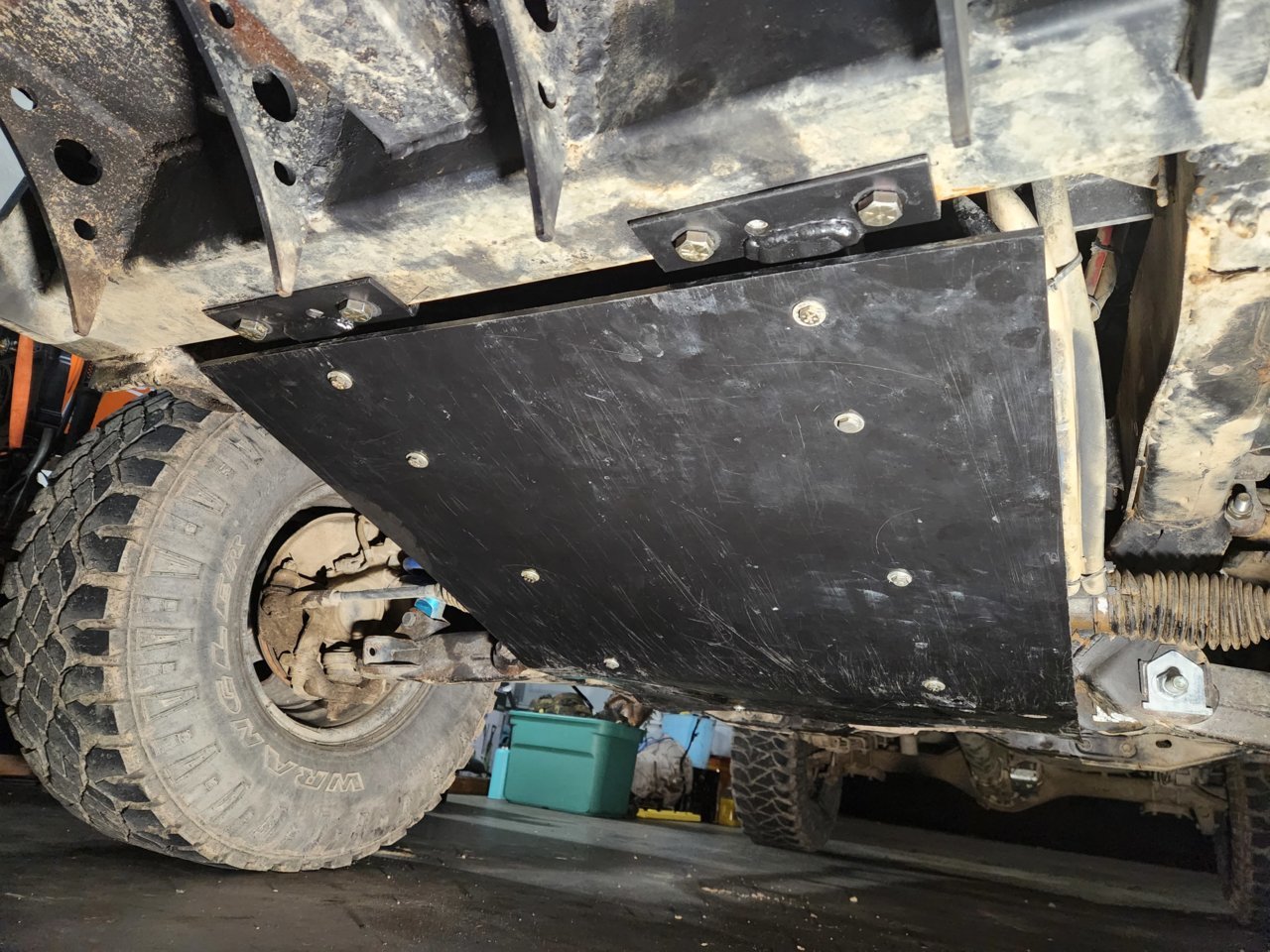

    Here's some pictures of the skidplate on. This time I used 1/4 20 weld in nuts instead of running the bolt through with a normal nut. Not sure if I would do 1/4 20 again as the fine thread is picky when lining things up.
    Here's what's underneath before paint lol

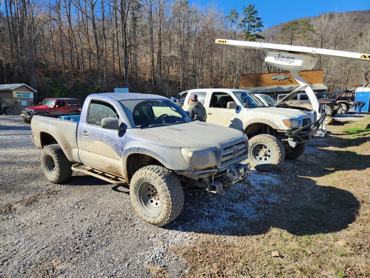

    Right before the windrock trip, I swapped the sc400 torque converter out with the tundra one I have. Made a world of difference in the low end and I didn't have to power brake as much in the muddy hills.
    Second trip through windrock was better than the first. Coming back with nothing broken helps. 2wd with a locker can do alot but we did find some limitations, nothing a quick pull didn't solve. A lot more muddy water this time.
    I did get some video so I still got to post those. Going to change the gopro location next time as most of the videos you can't see through the mud.

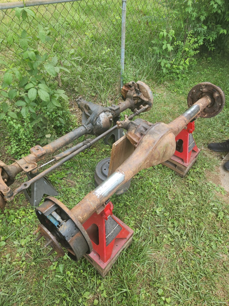

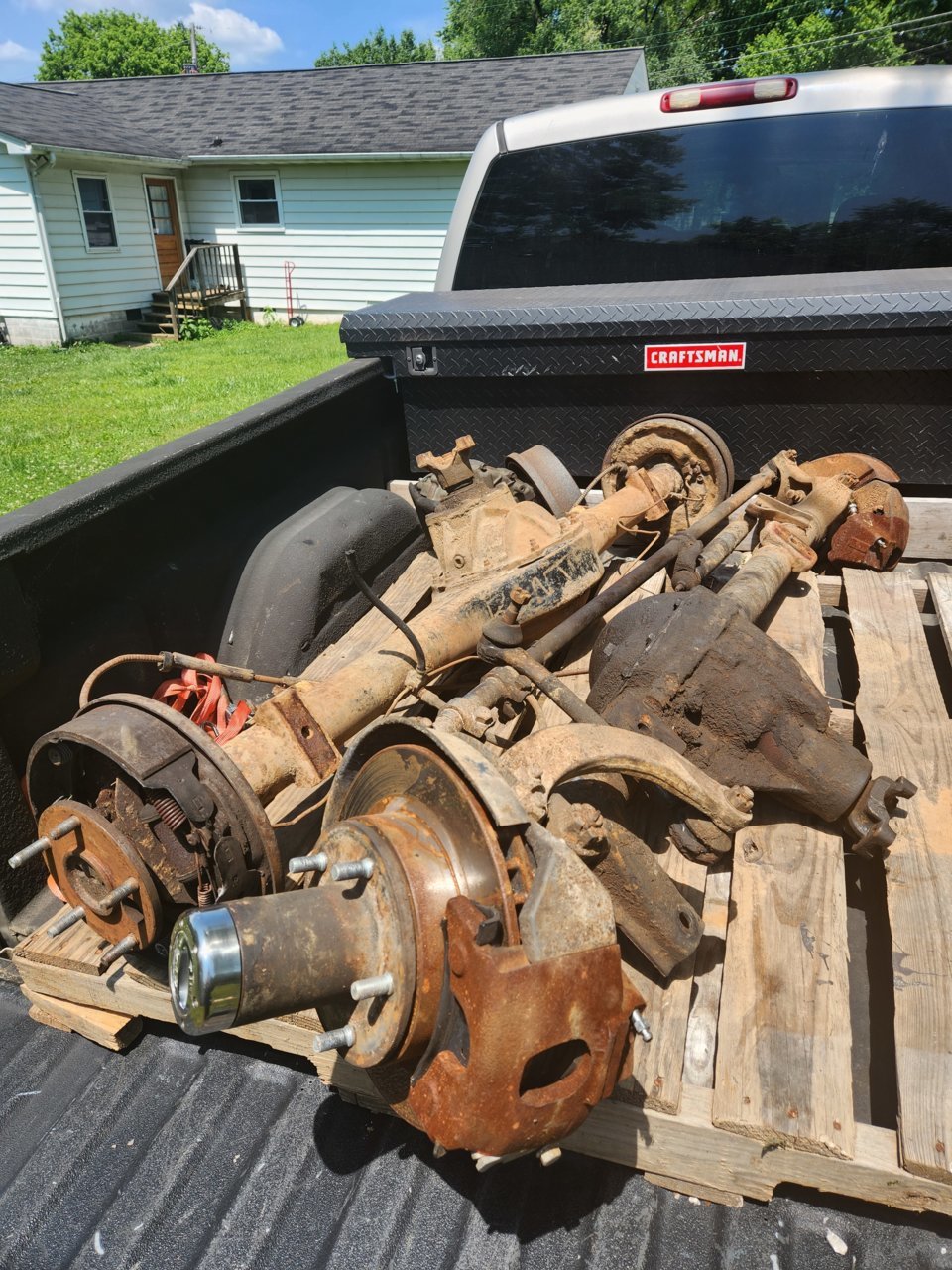

    The plan is a
    Axles
    Dana 44 high pinion
    Ford 9" (with stock lsd for now)
    Gears will most likely be 4:88s
    Drivetrain
    Tundra 4wd trans
    4runner j shift transfer case
    Suspension
    Leaf sprung front
    Chevy 63s rear
    The goal right now is to swap in the trans, transfercase and do the rear end.
    I've already prepped the trans and twin sticked the transfercase

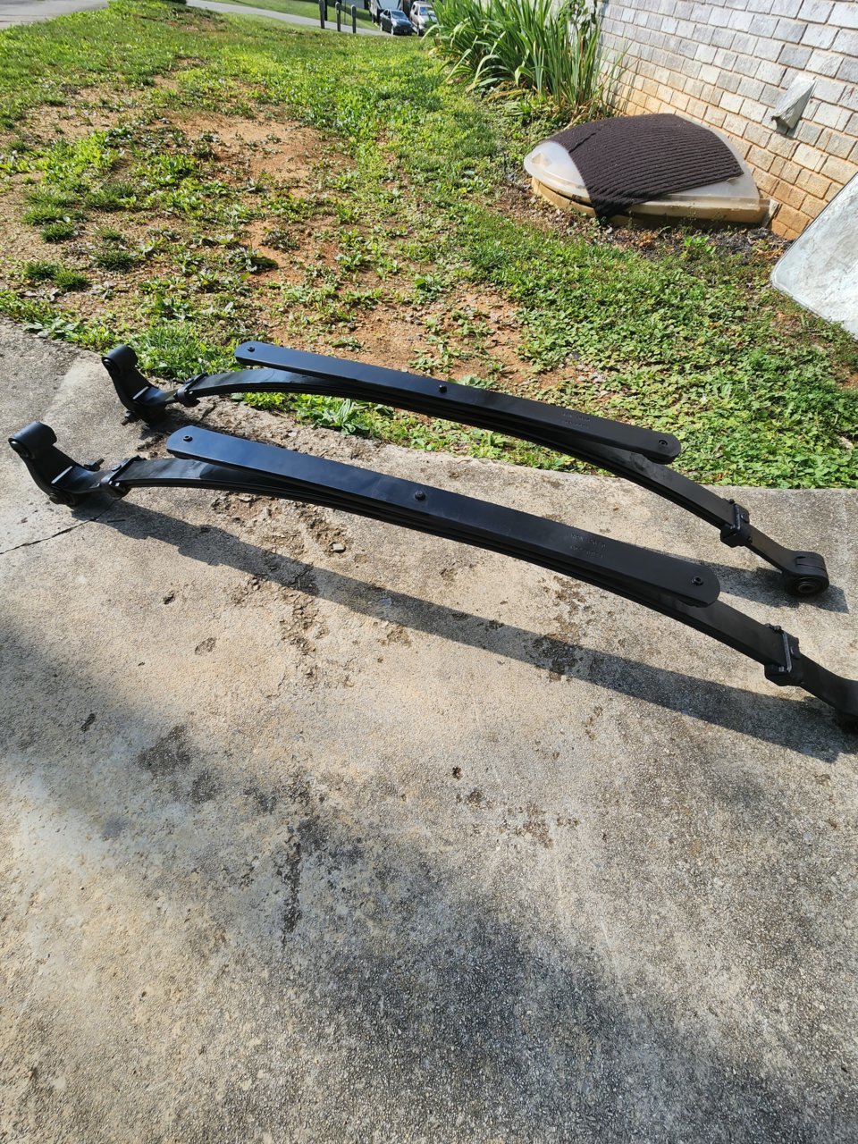

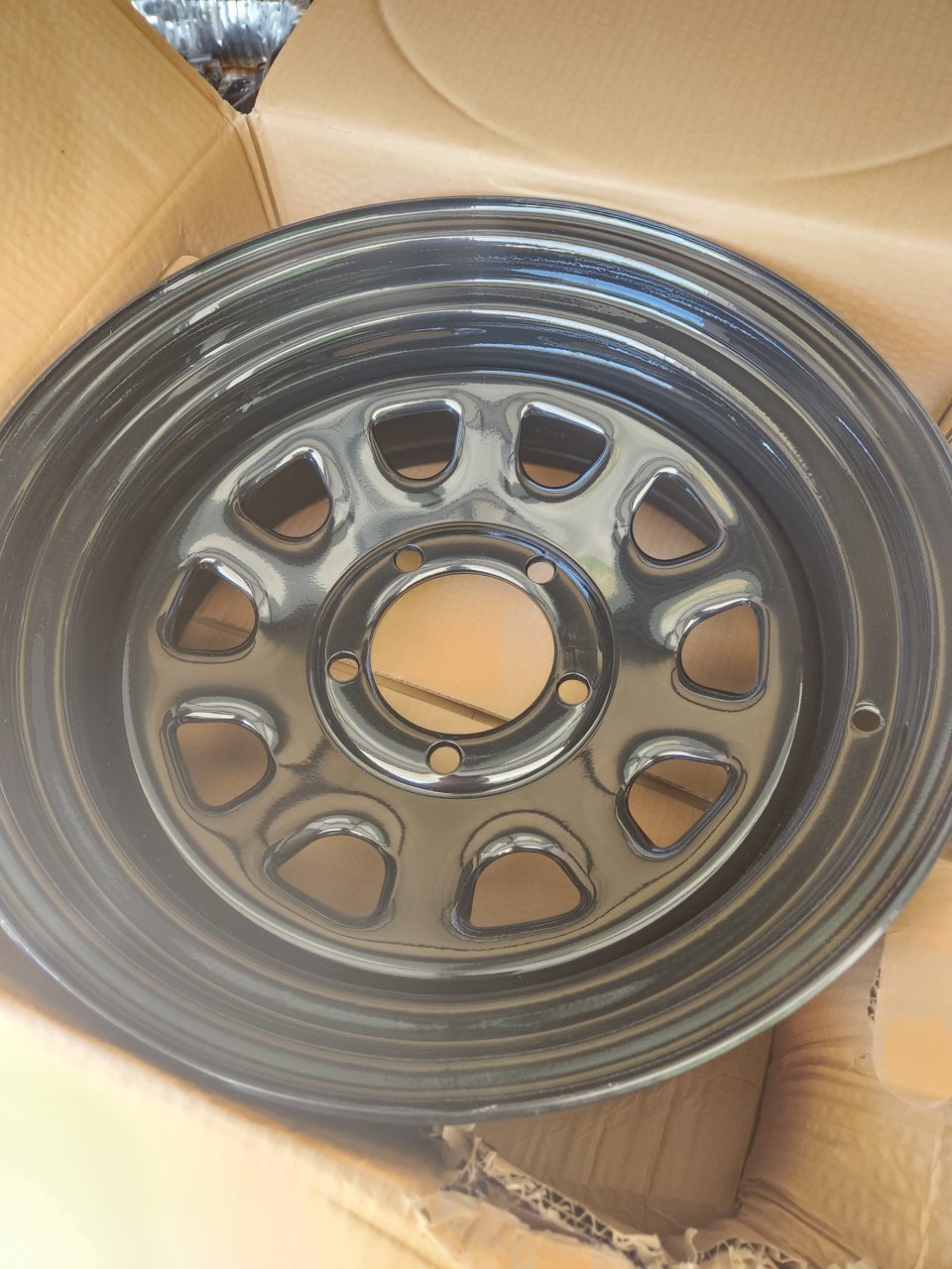

    Got leafs from the junkyard and painted them as well
    Going from 15s to 17s as it's easier to find 35s/37s in that size

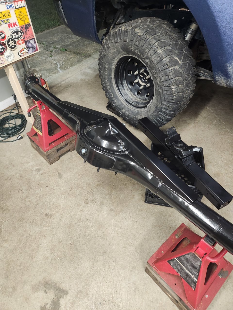

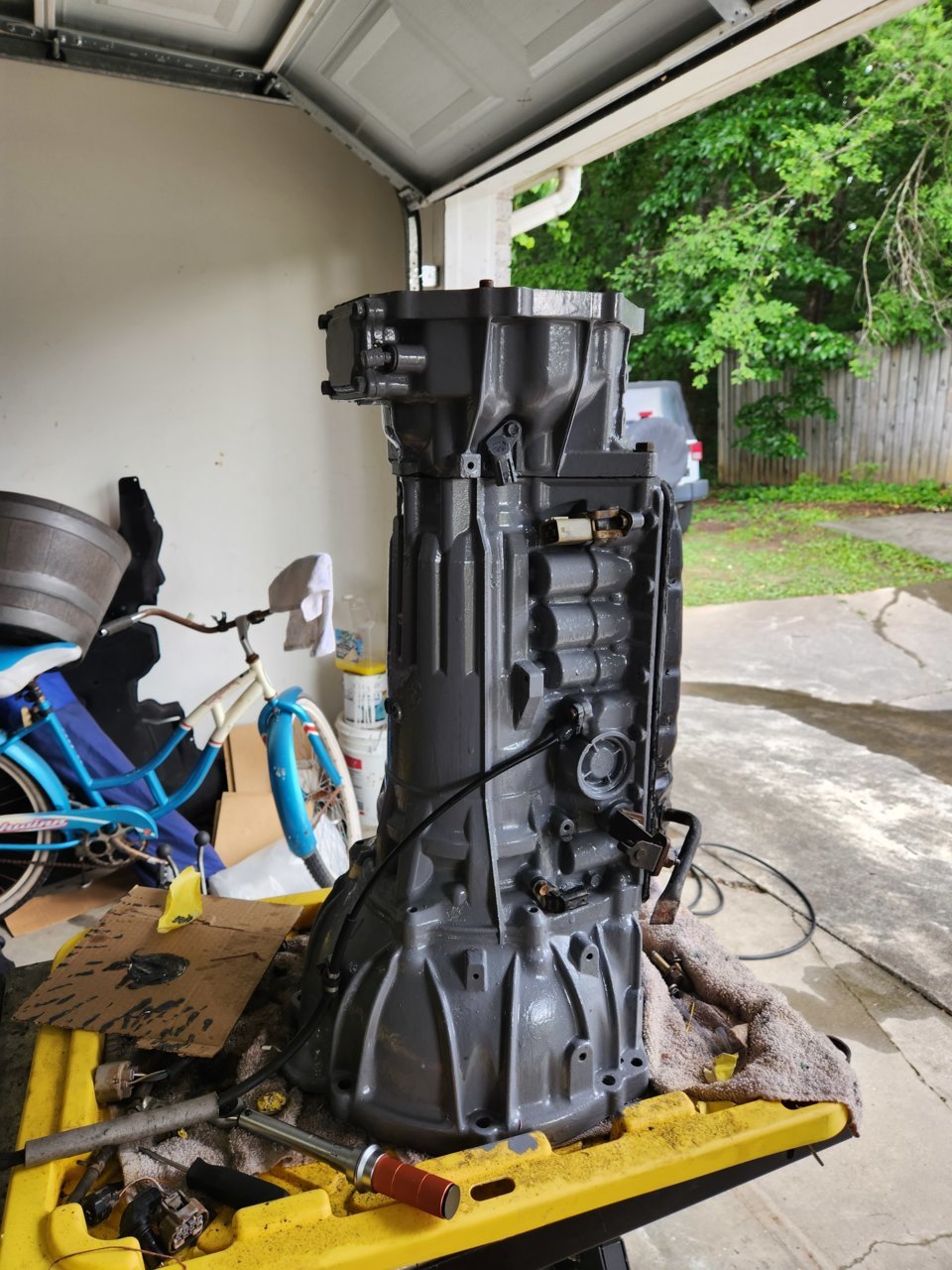

  11. Jun 26, 2023 at 3:09 PM
    #251
    5 Lug Fury
    5 Lug Fury [OP] Well-Known Member
    Nov 21, 2014
    #142831
    3,075
    Kenny
    Knoxville, TN
    V8 Solid axle swapped 5 lug
    Got a lot of stuff lol

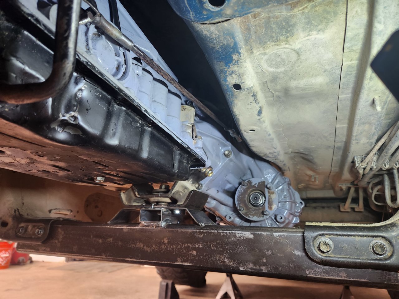

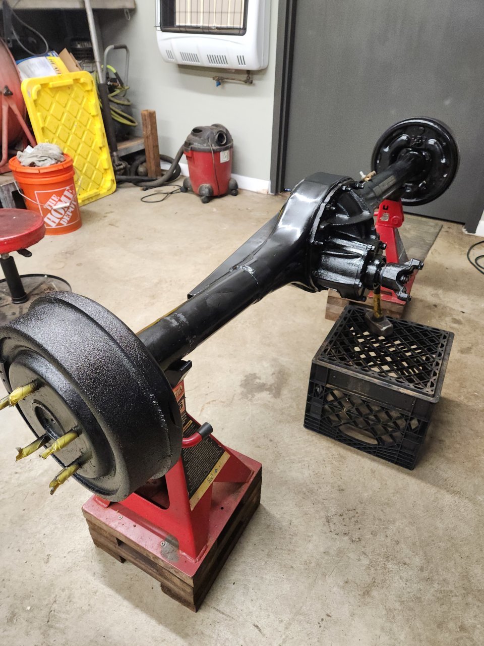

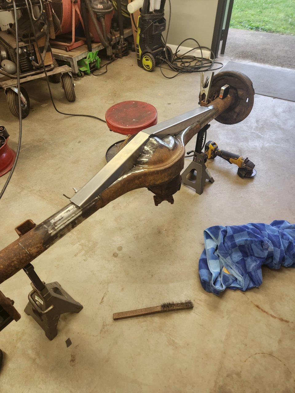

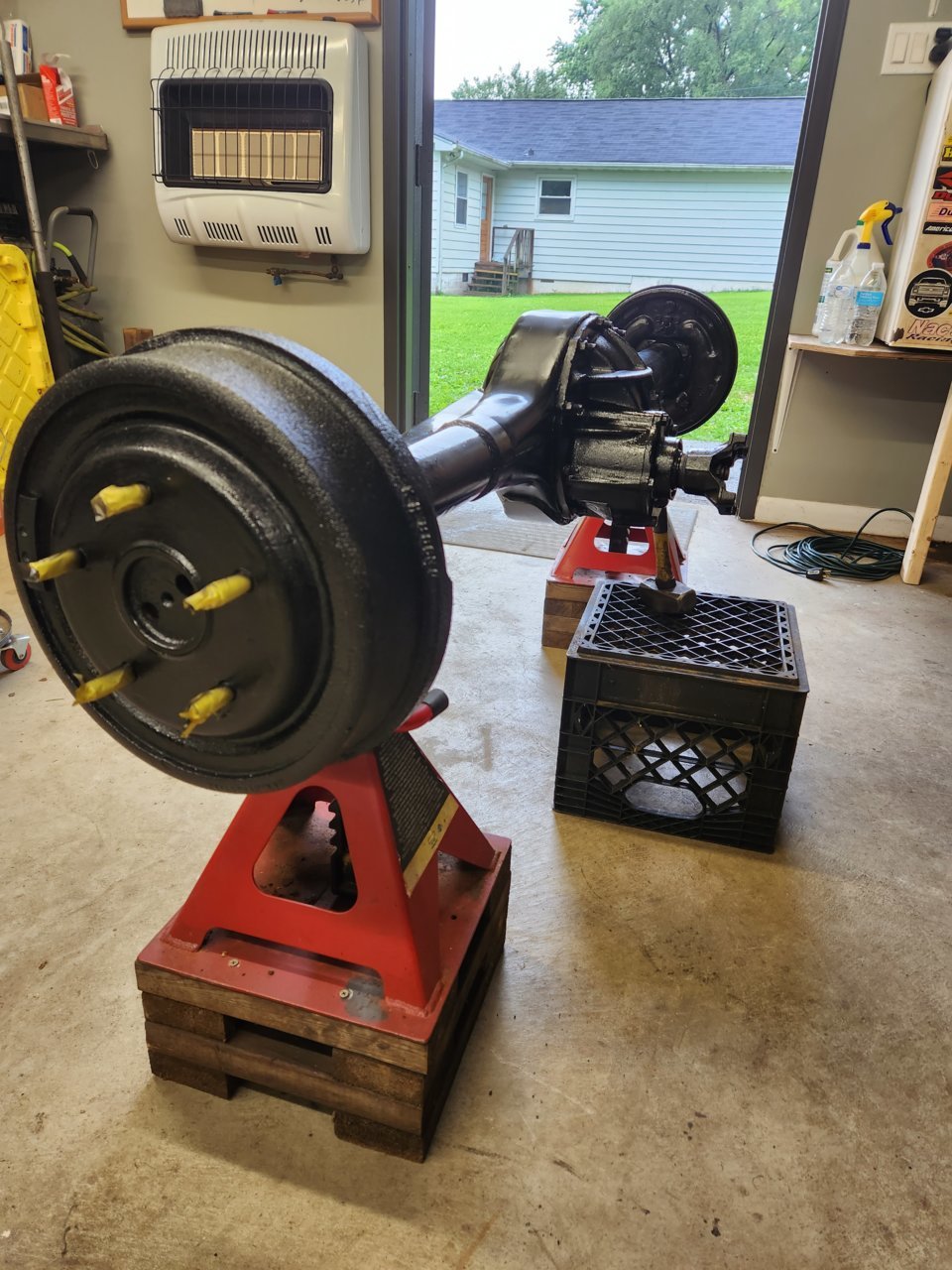

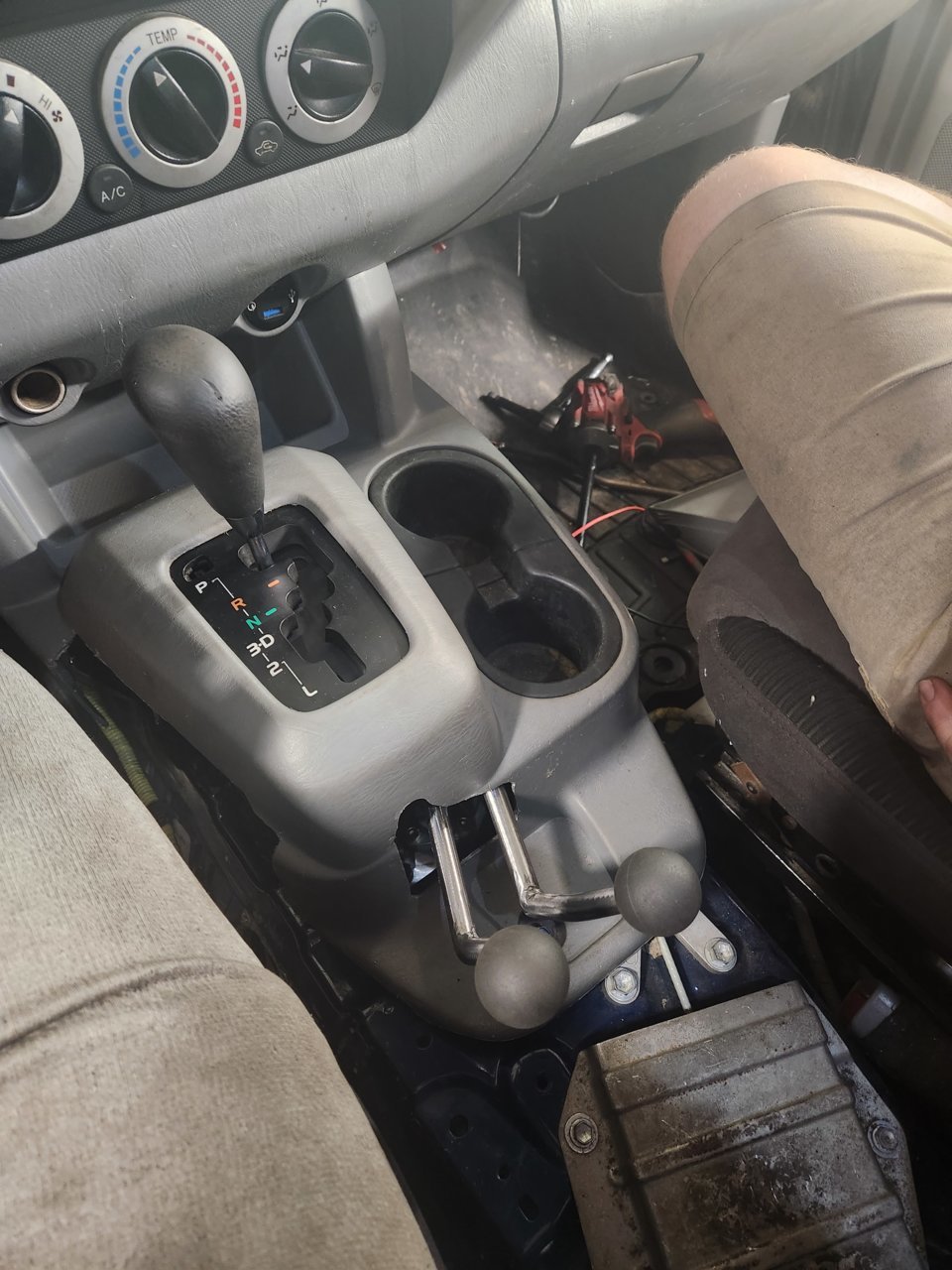

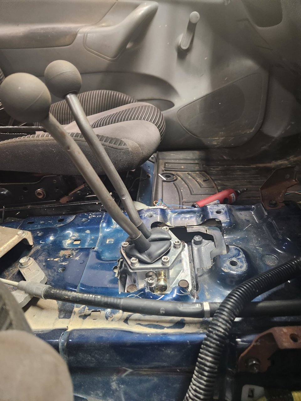

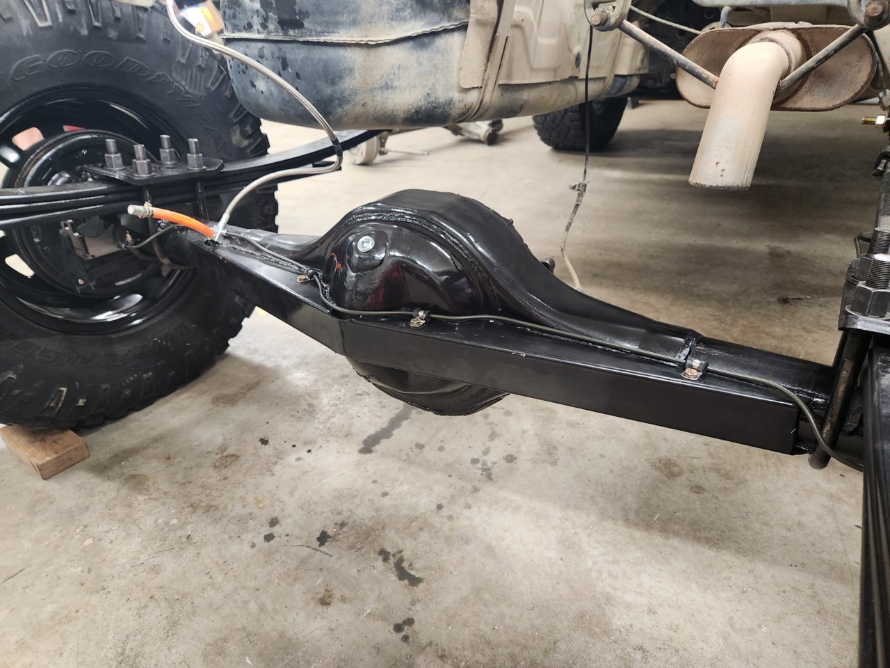

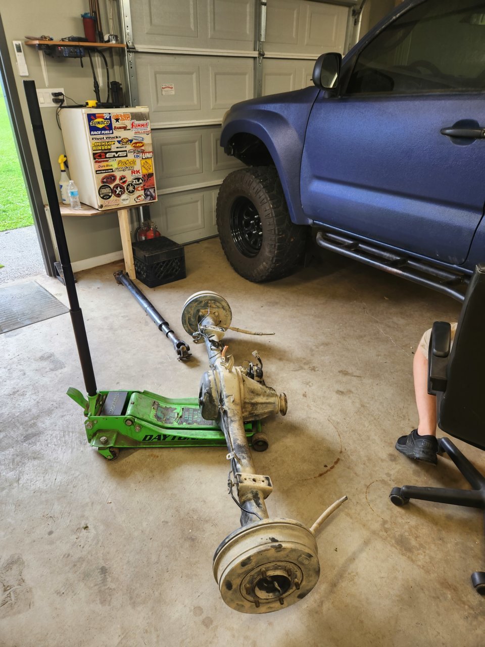

    Got the old 2wd trans out and the new 4wd bolted up with the transfer case. Made a new Mount that eventually will need modification for the front drive shaft but for now it's wayyyyy beefier than the stock one.
    Decided to go twin stick. Don't have a picture but got the trans shifter in and a new linkage made up as well. Just need to cut the twin stick and weld them in a way they plays nicely with the center console.
    Here's one of just the twin stick. As you can see they come up right next to the trans shifter

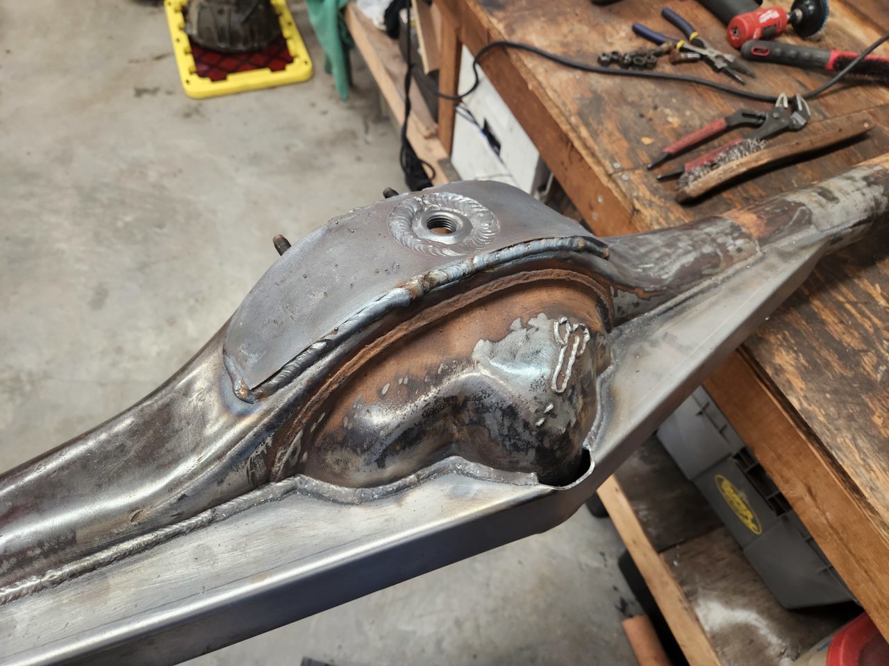

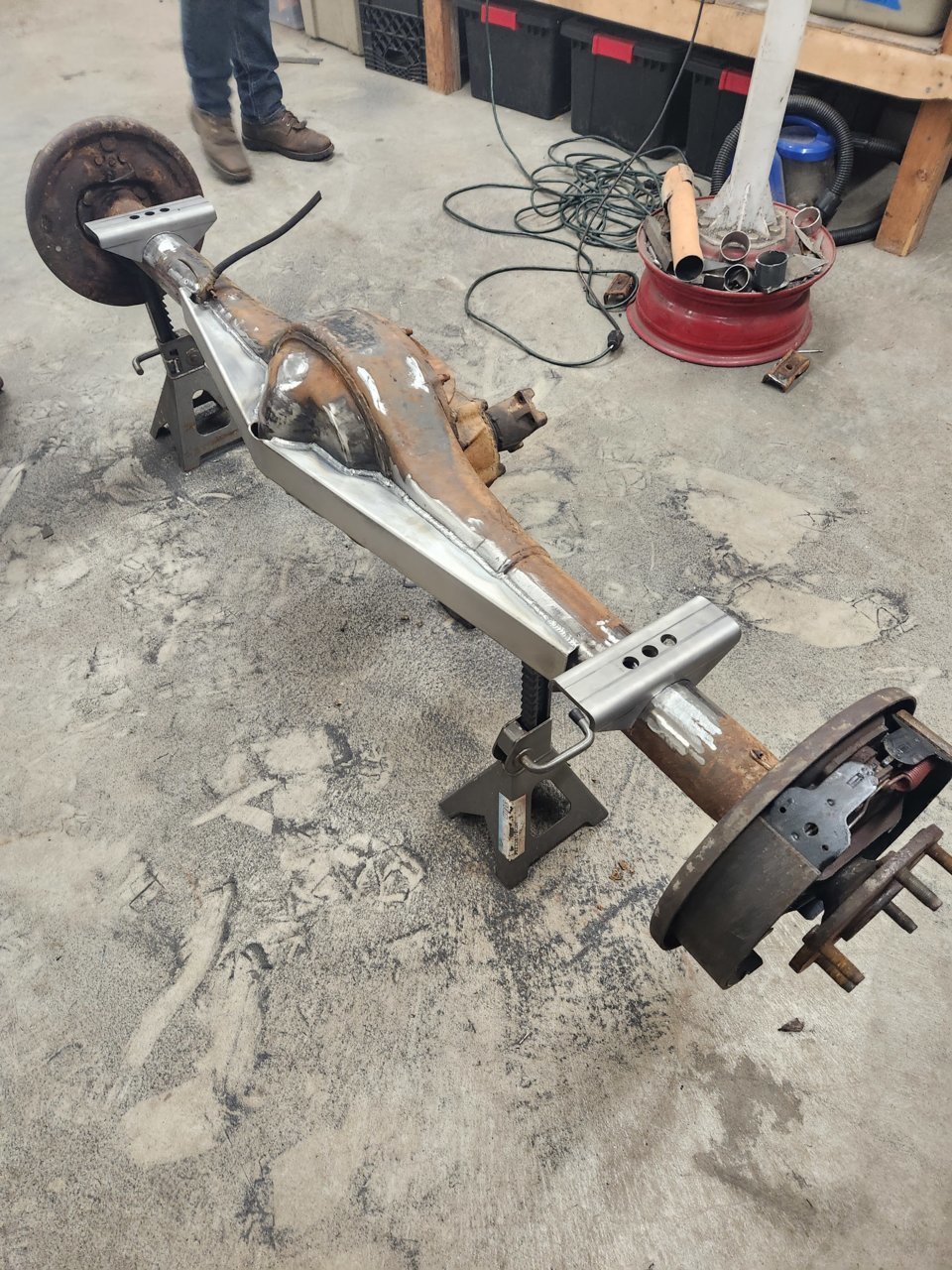

    Decided to truss the rear axle with an Amazon $70 truss lol
    The truss fit pretty well and plenty of room for the spring perches (which are only mocked up rn lol)
    Decided to add a 1/2 drain and inspection port along with a 1/4" plat on the bottom for skidding on rocks. Here's the bottom
    And finally paint and assembly. I decided to not touch the third member yet and see how the current gears and lsd clutches are. Did replace some of the hardware though.
    Ace hardware gloss black is sooooo glossy

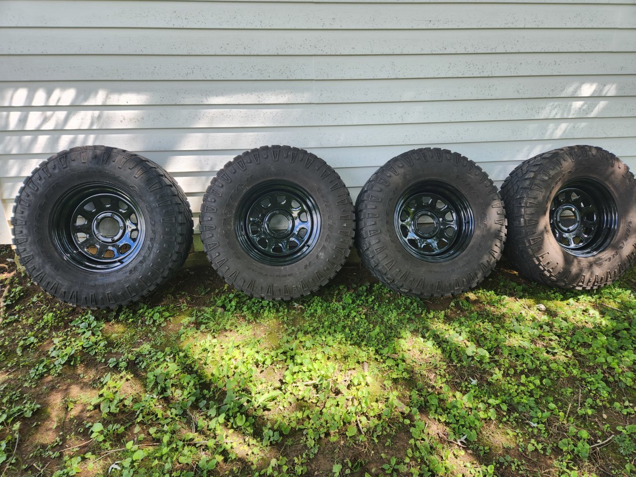

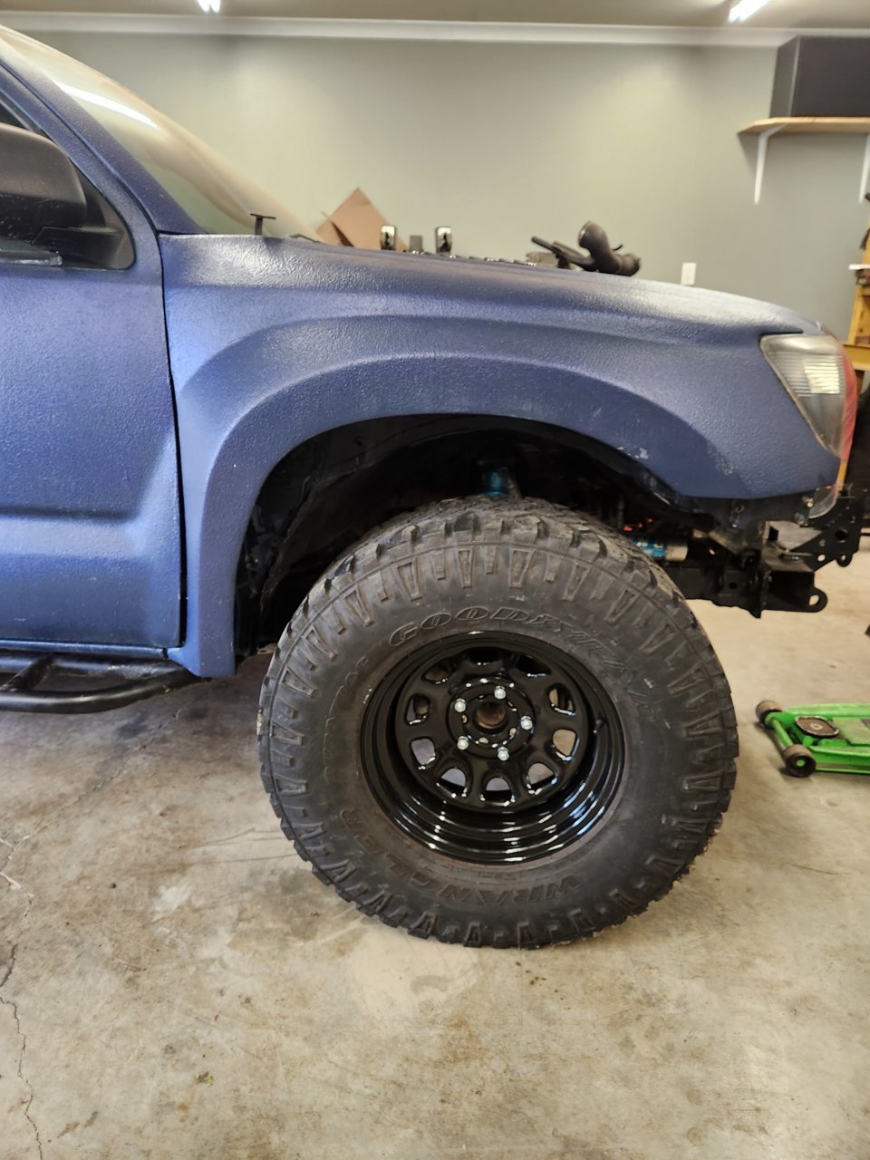

    Annnnnnd finally got a used set of goodyear duratracs 325/70/17
    33 vs "34.4"
    Got some things to do in the front to help with clearance since I'm using an adapter up from until I do the dana 44.
    Still gotta get the center console finalized with the shifters and then the fun begins in the rear with chevy 63s and the ford 9"

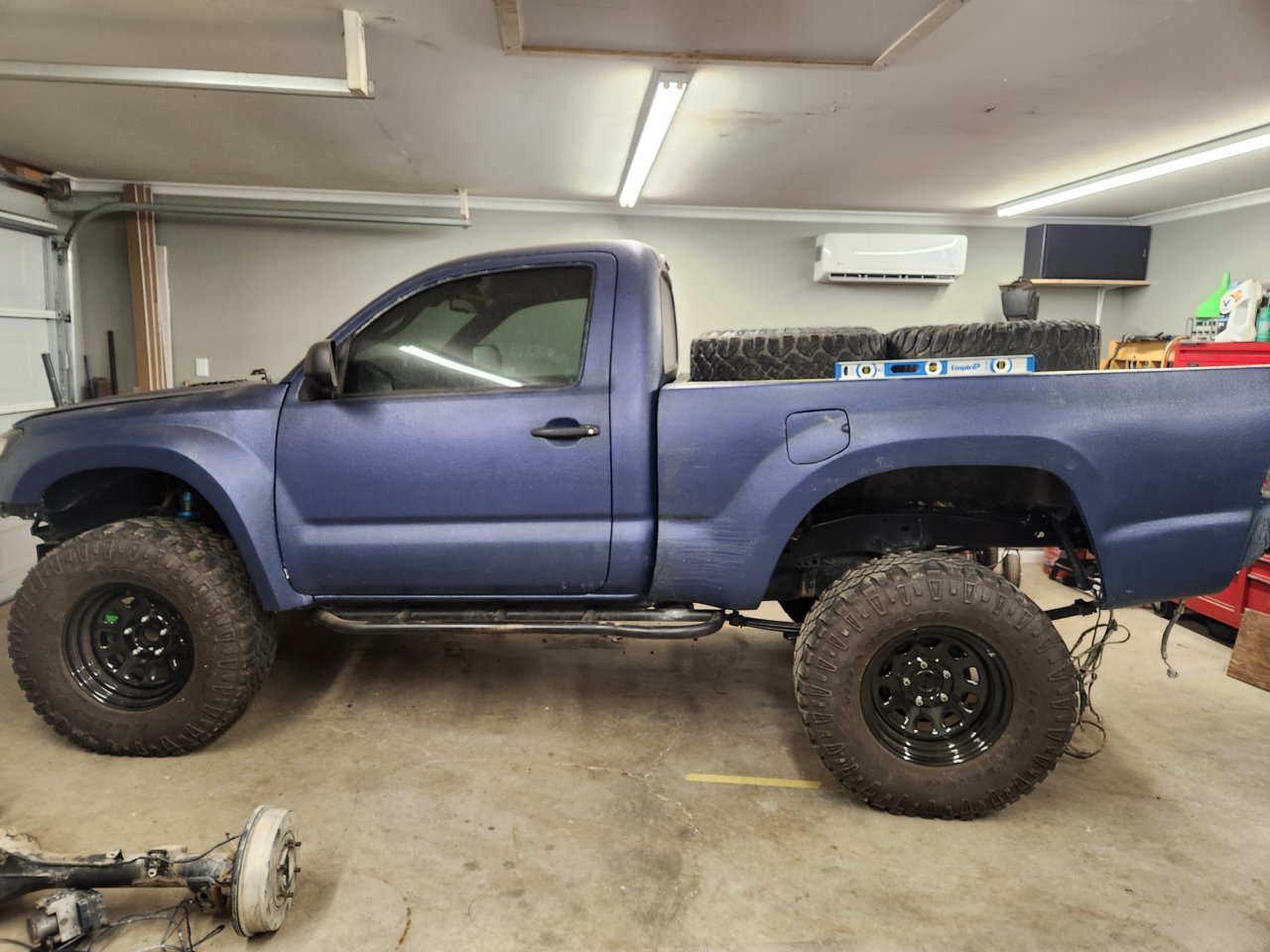

  14. Jul 1, 2023 at 7:42 PM
    #254
    5 Lug Fury
    Nov 21, 2014
    #142831
    3,075
    Kenny
    Knoxville, TN
    Shifters for the twin stick are done now. Also was able to drive the truck around the block to confirm the junkyard transmission was good.
    Bed is off now and strip down will start tomorrow.

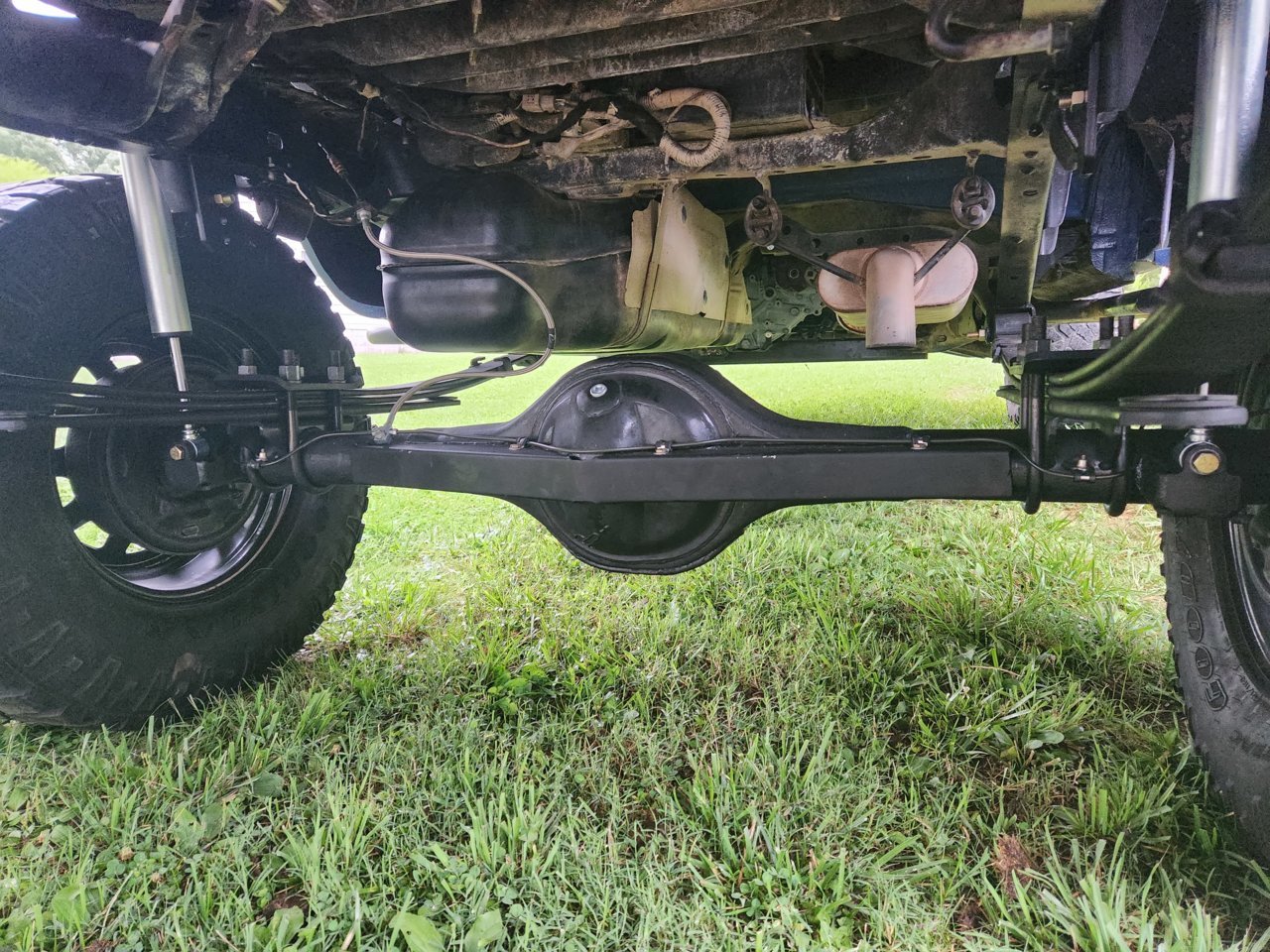

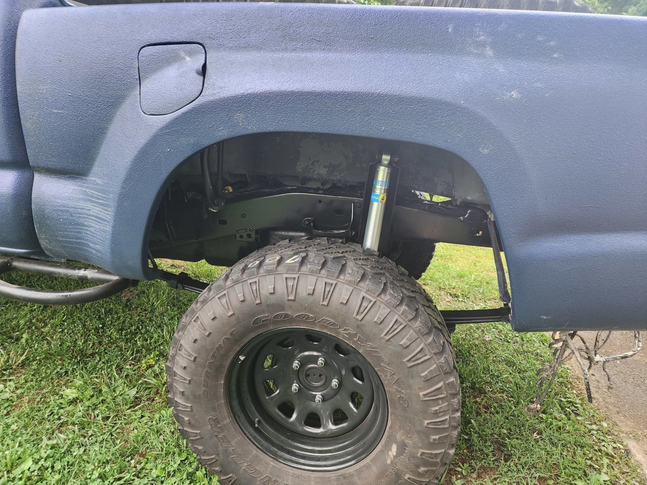

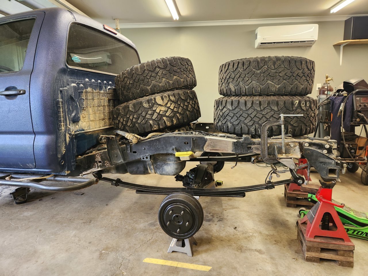

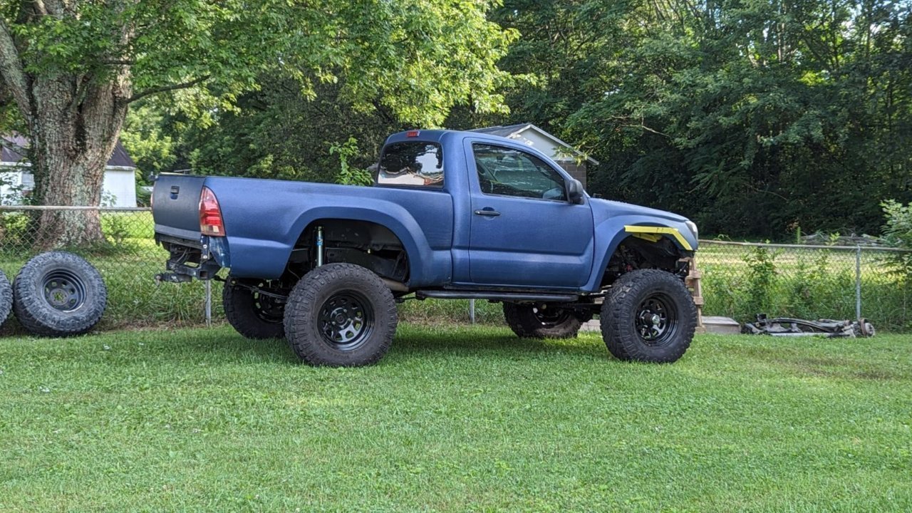

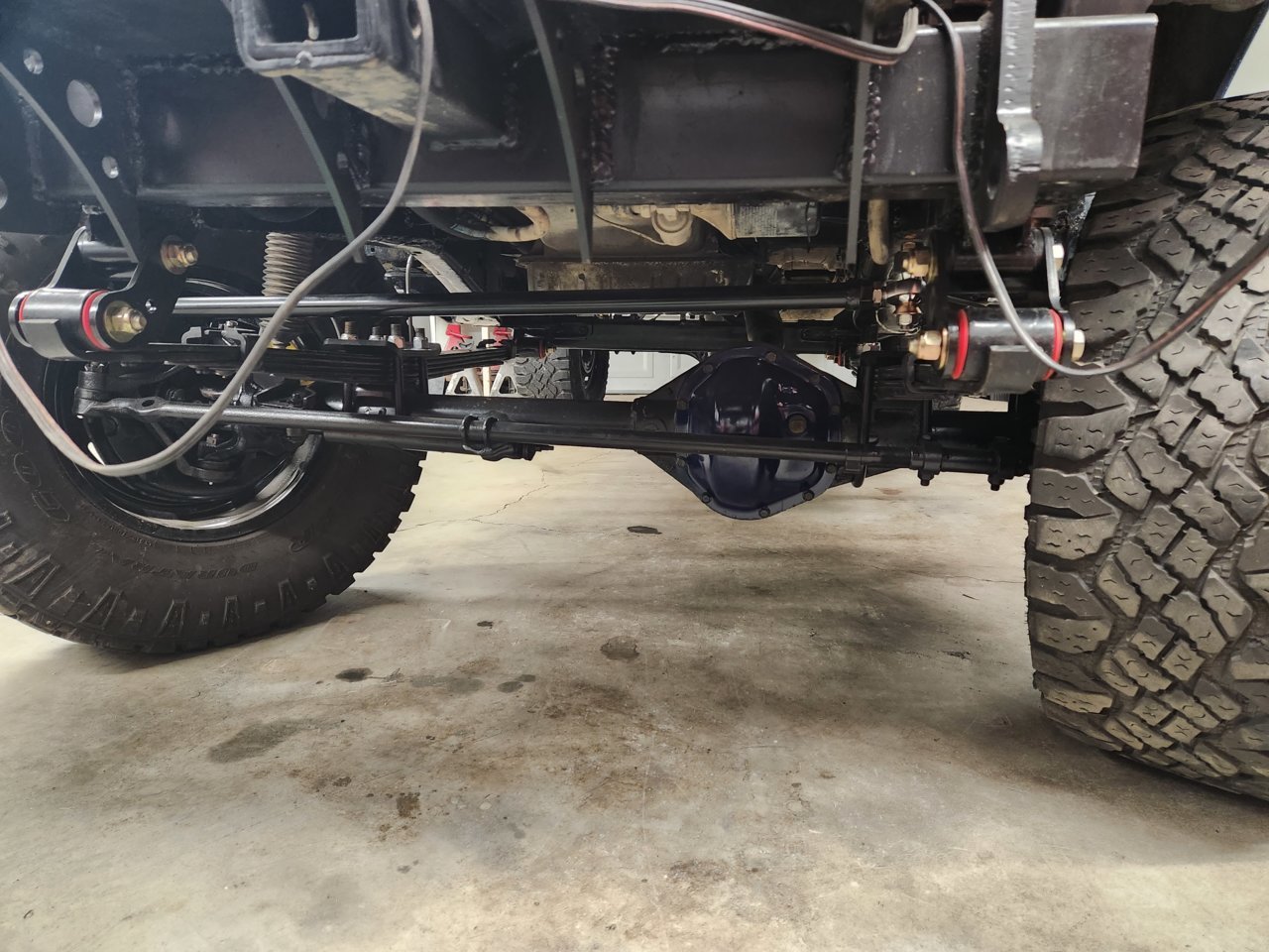

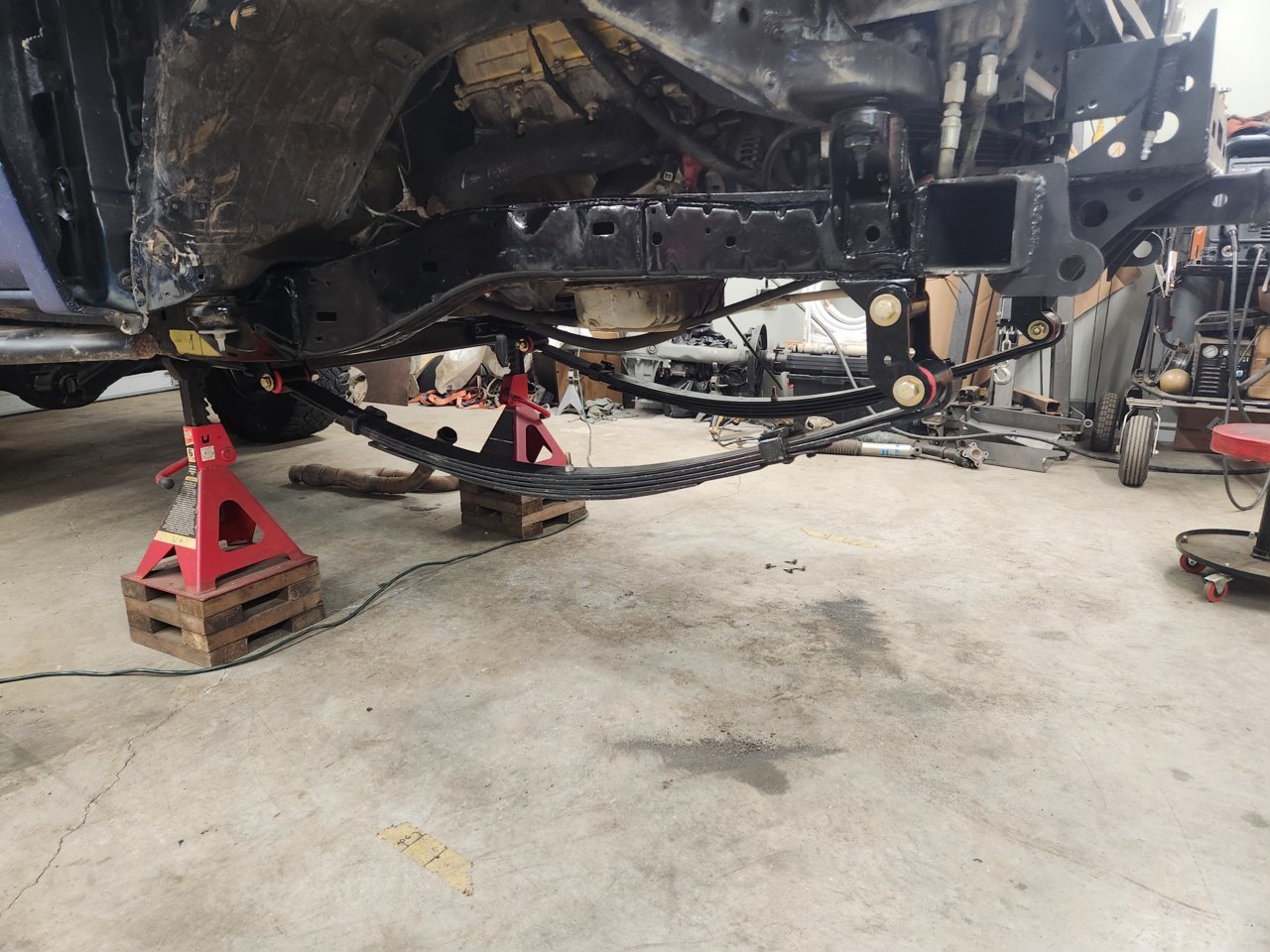

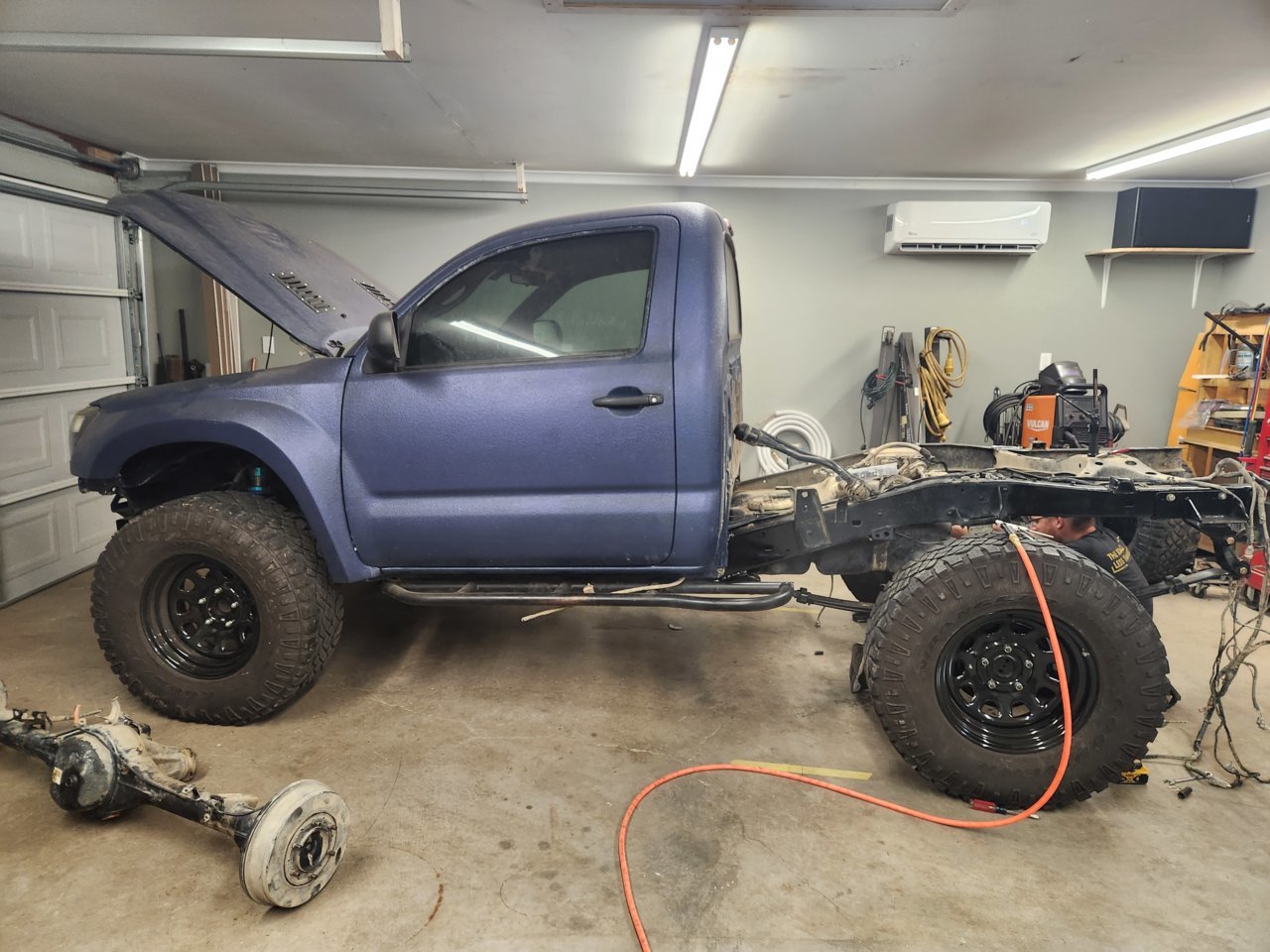

    Ripped out the old axle and cleaned the frame off
    Playing with shackle angles ended up with a little lower of an angle than this one
    Back on the ground

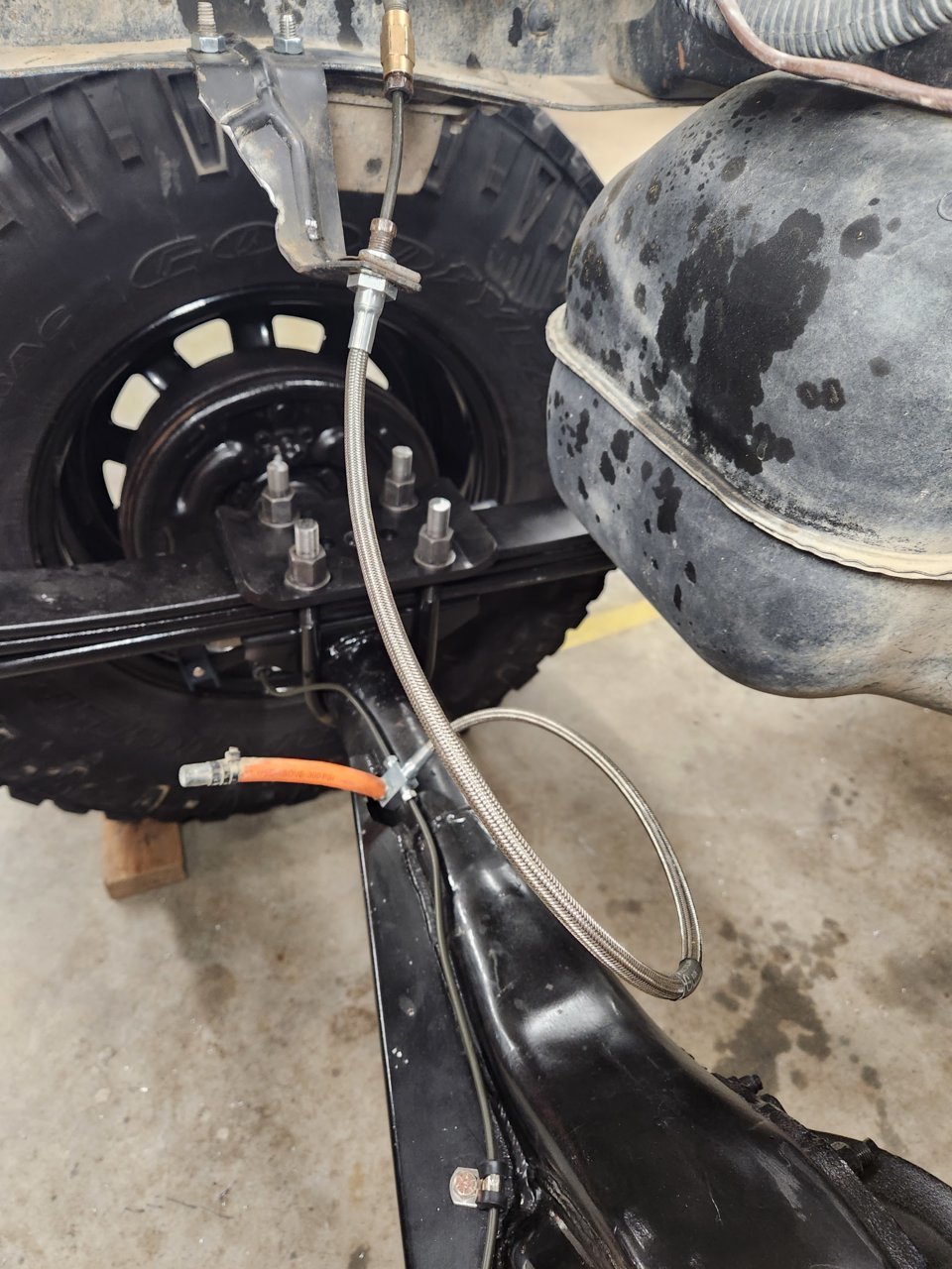

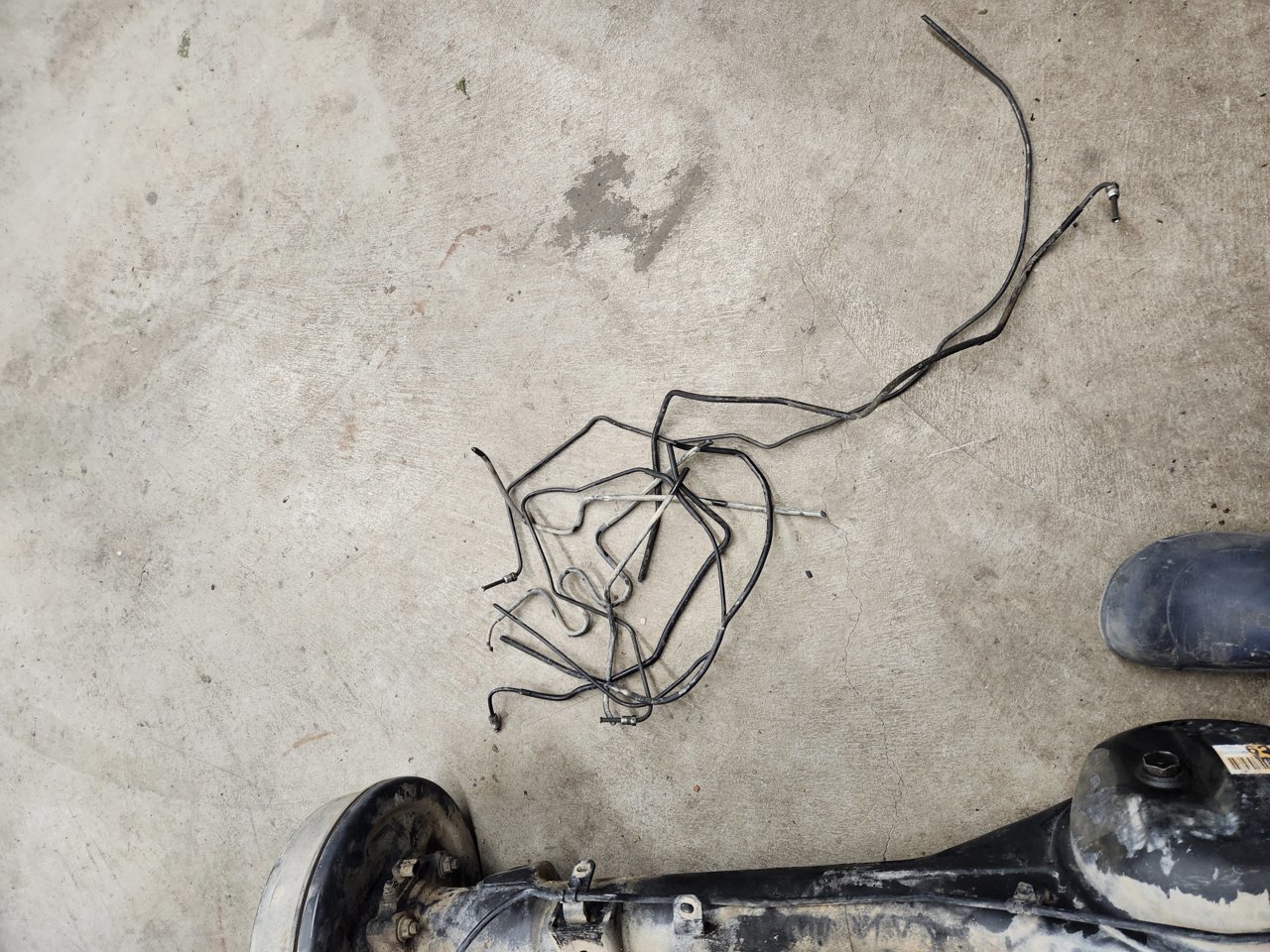

    Rear brakelines added. Utilized one of the stock hardlines with an adapter
    Also ripped out all alot of the previous lines

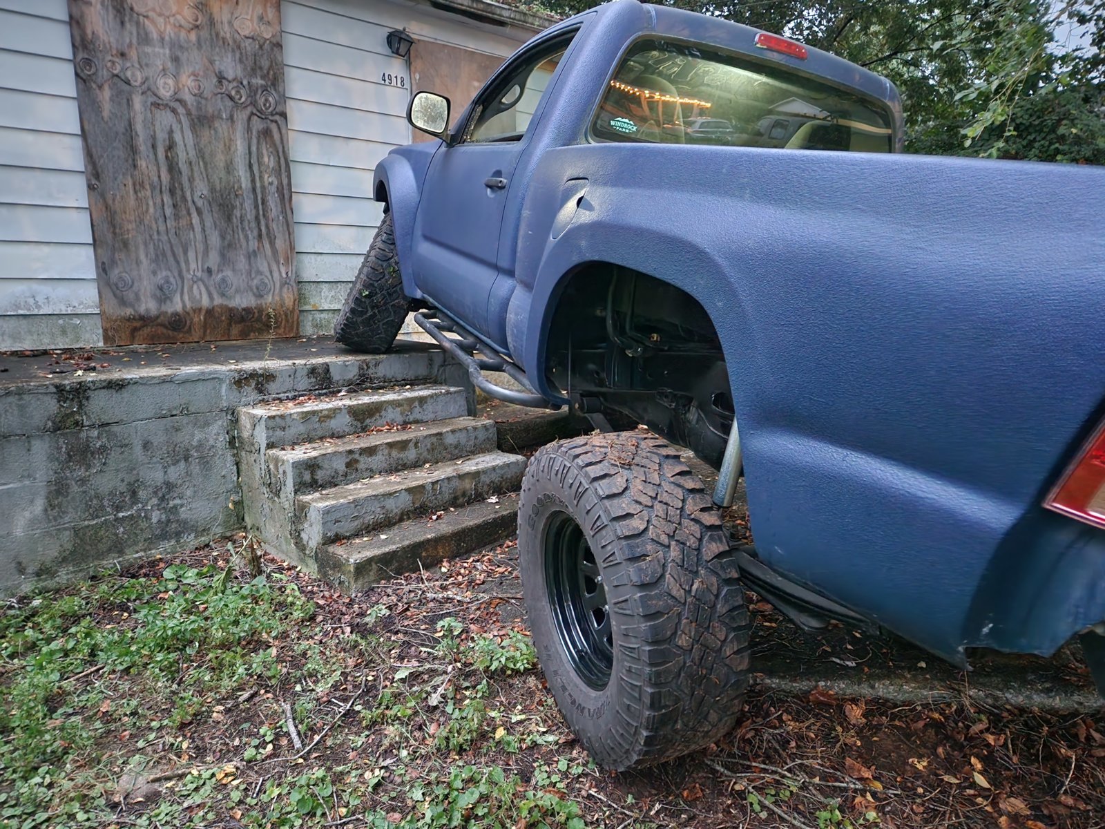

    Back on the ground. Yeahhh I know the booty is pretty up there lol. The front will eventually match..
    You vs the guy she tells you to not worry about
    Ended up making the shock tower adjustable with a 1/4" plate and keeping it bolt on
    Probably one of my favorite photos showing how tucked the 9" is even with the 1/4" skid on the bottom of it
    Waiting on some brake parts as I'm upgrading my booster and master cylinder to a tundra one. Also have the driveshaft on order so mainly waiting on parts right now.

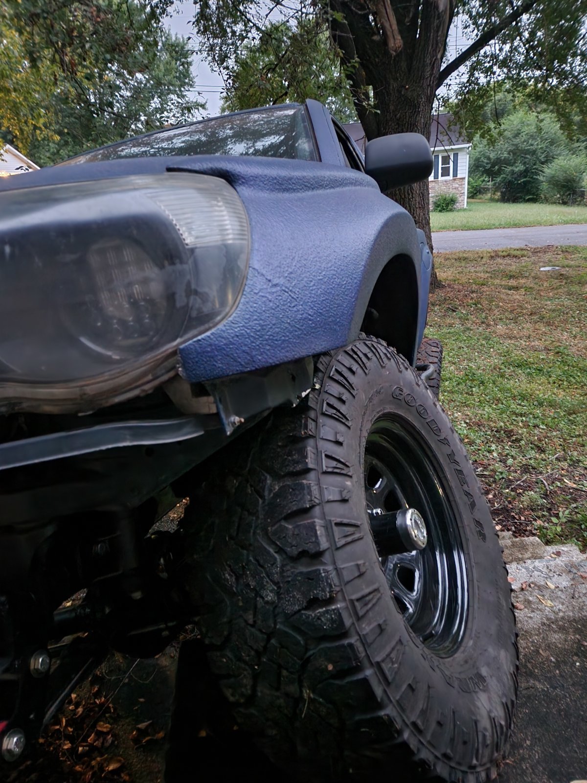

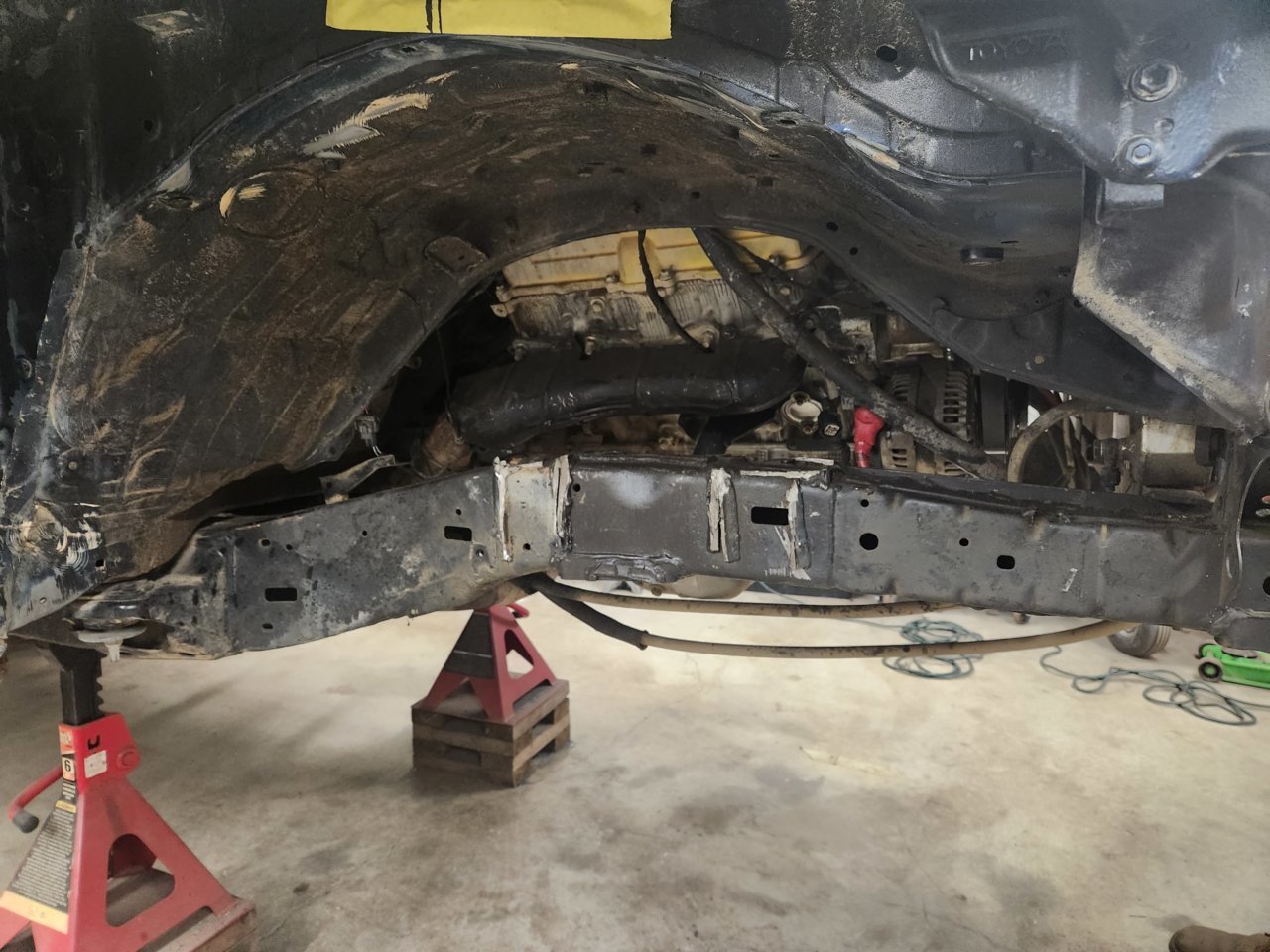

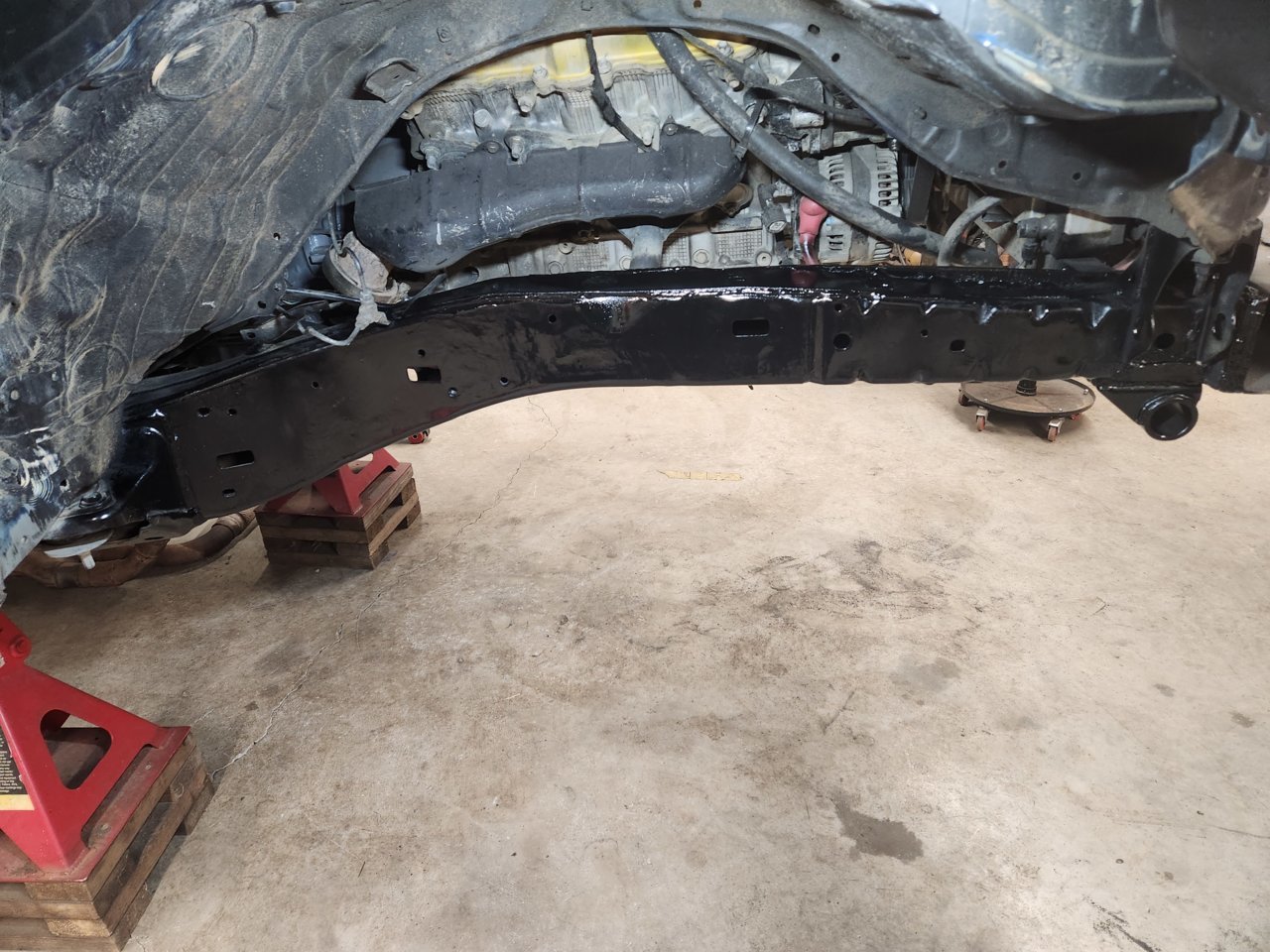

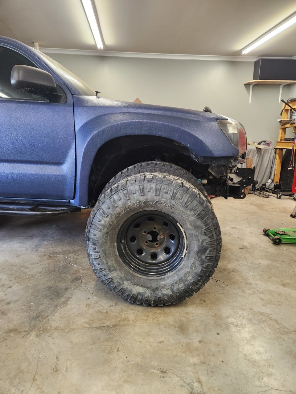

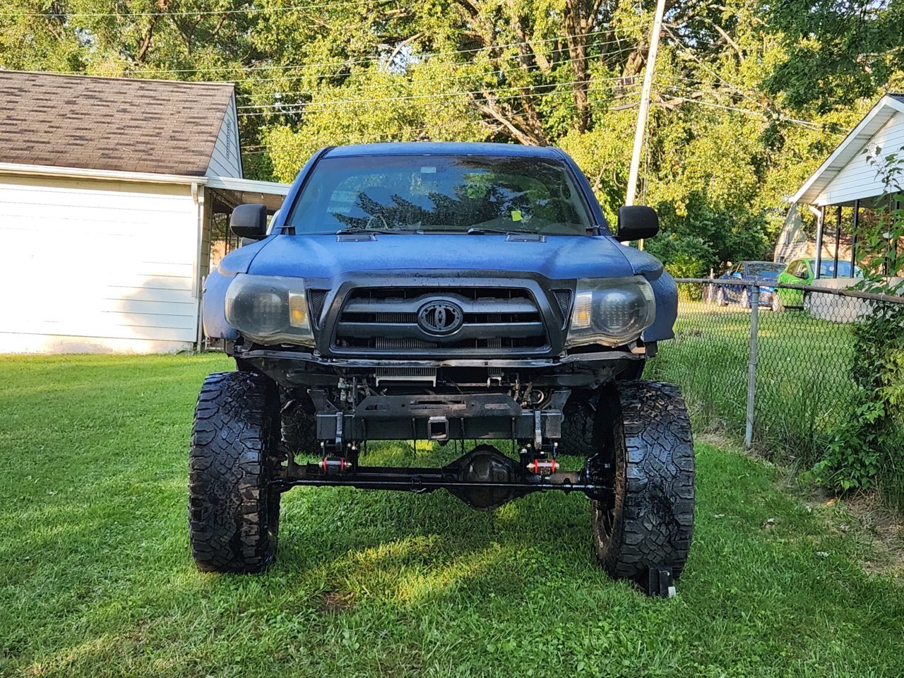

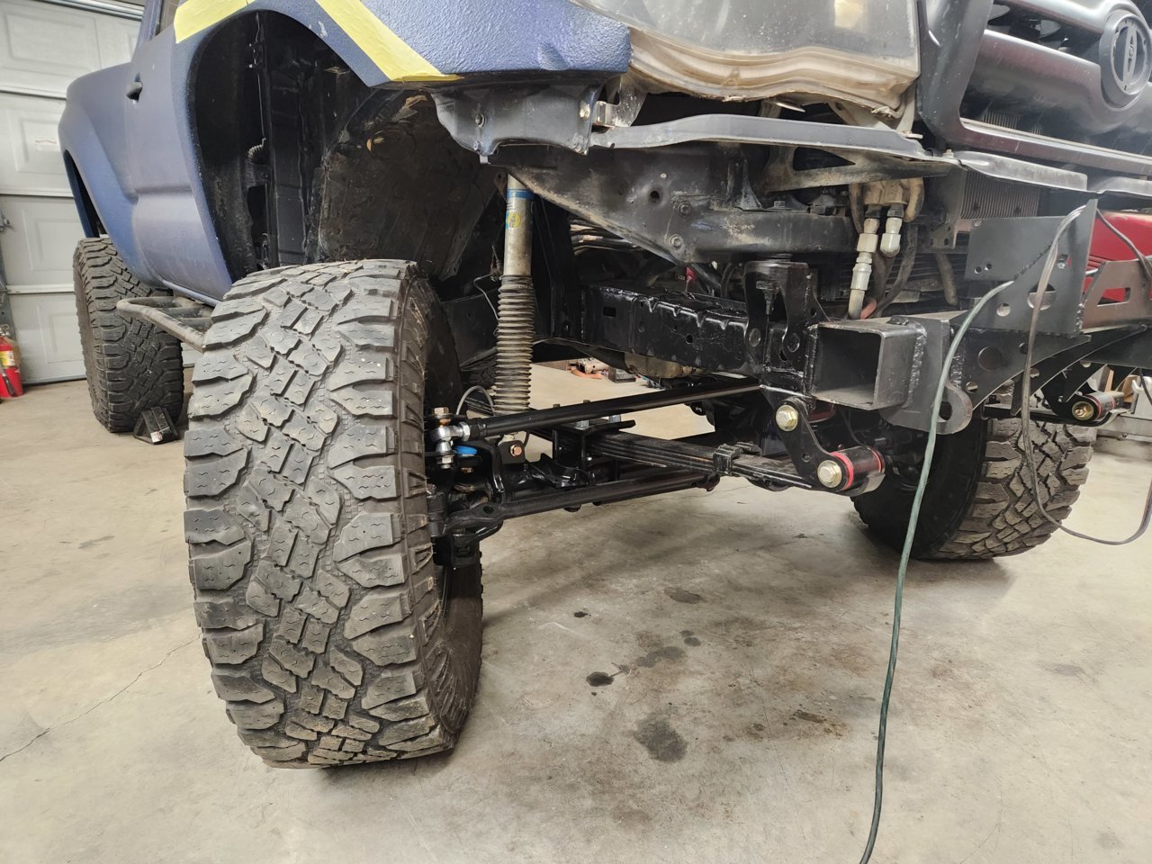

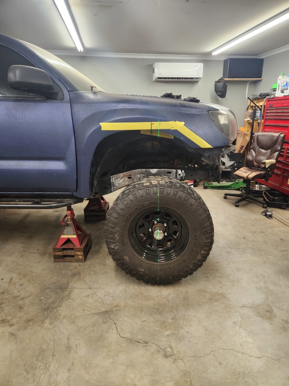

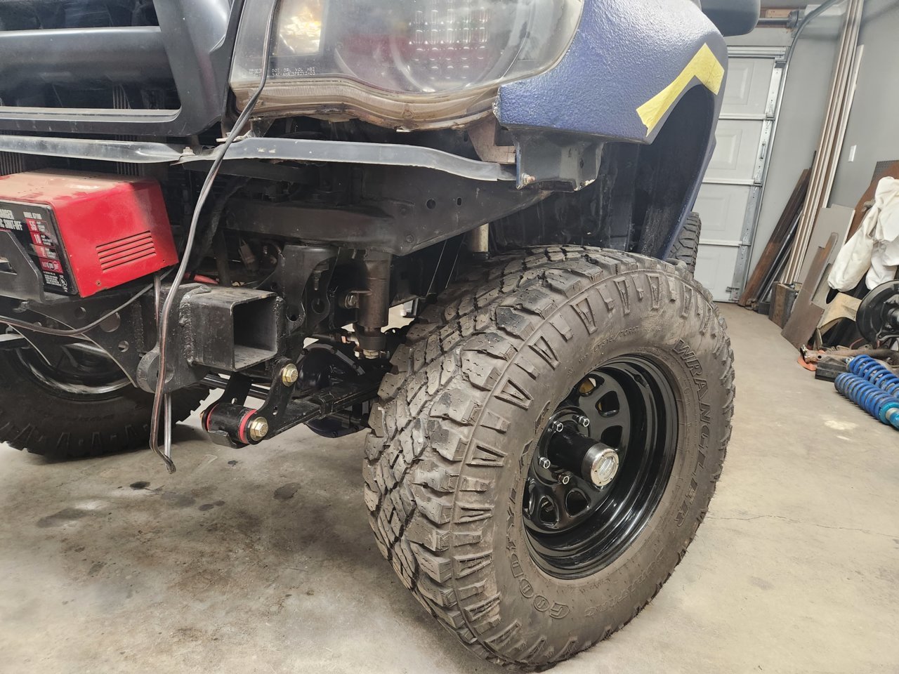

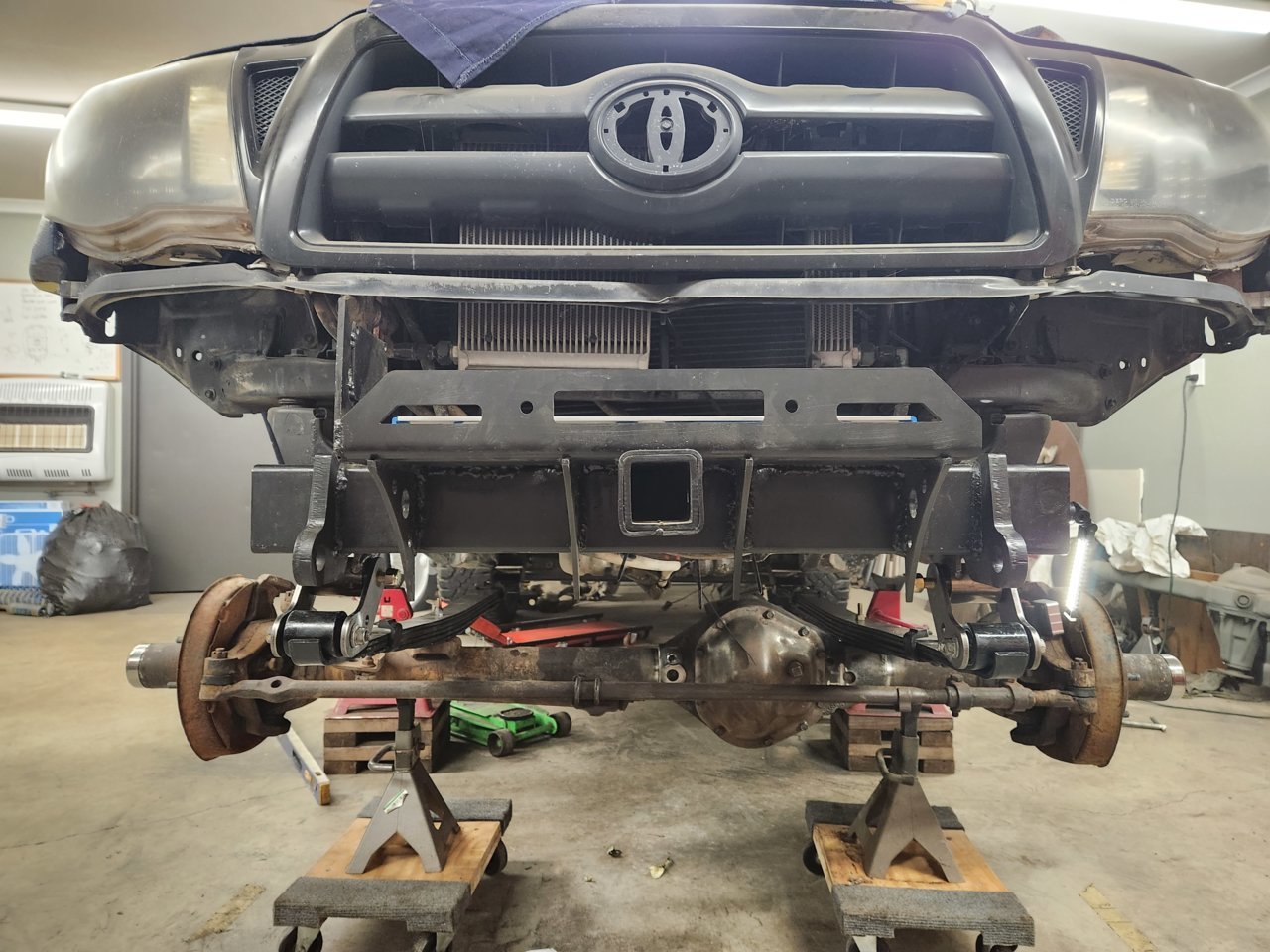

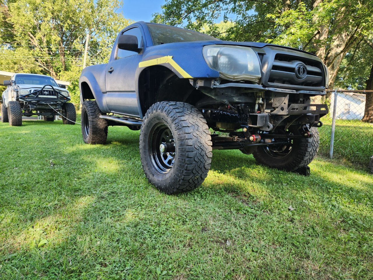

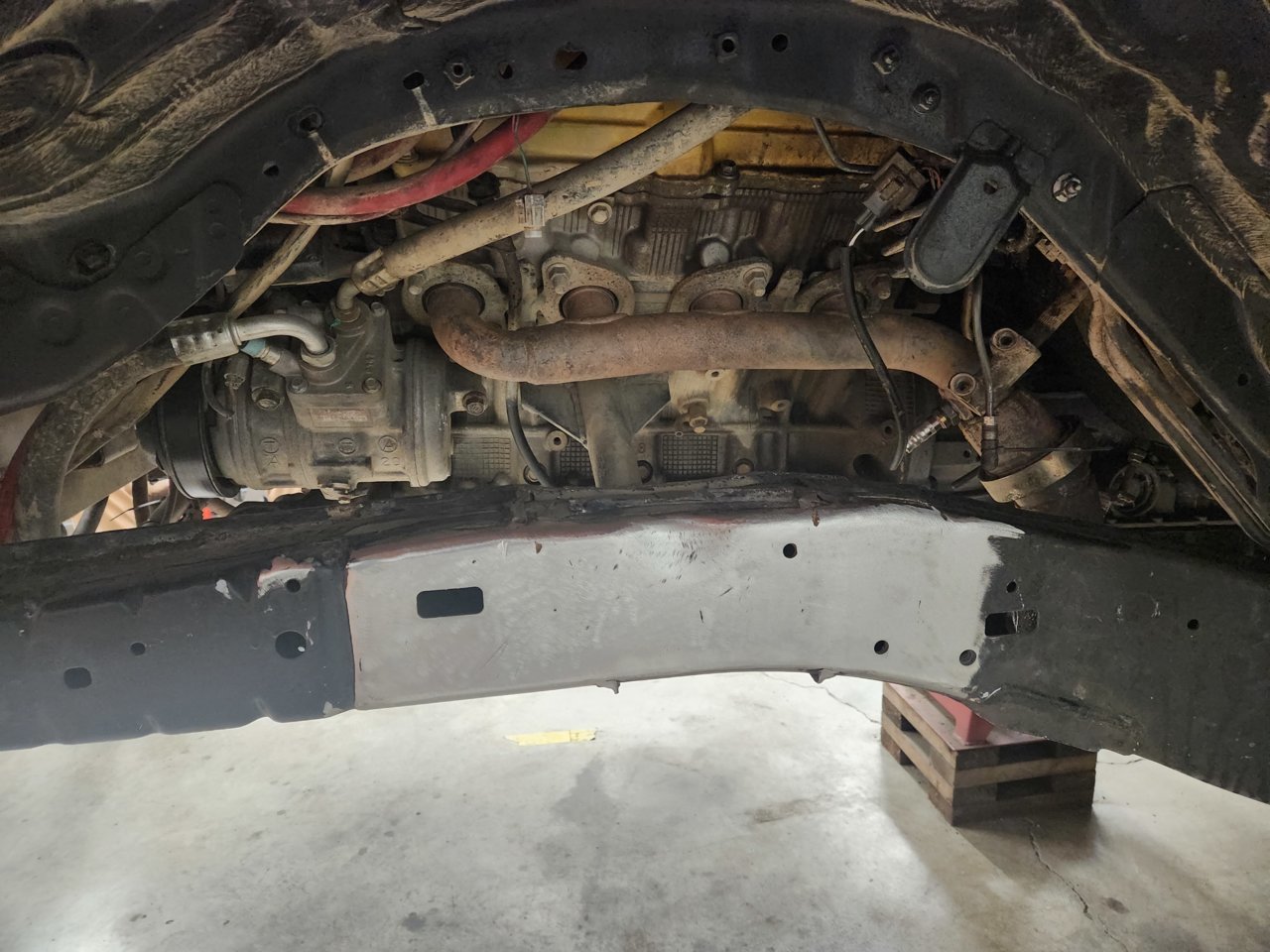

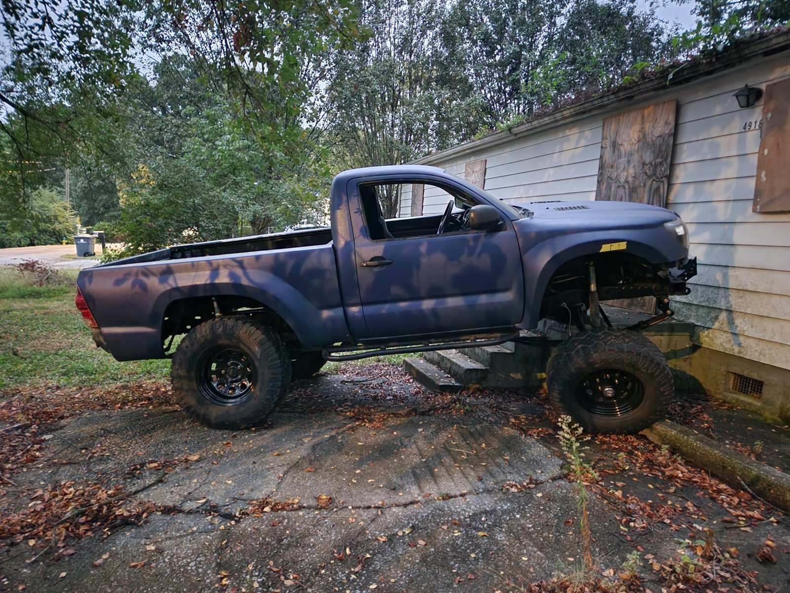

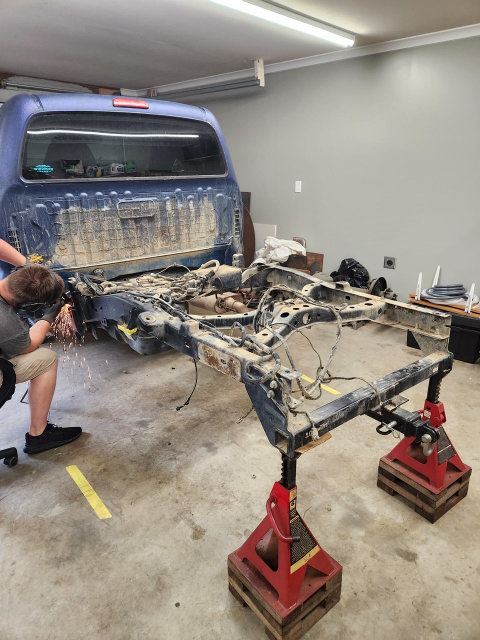

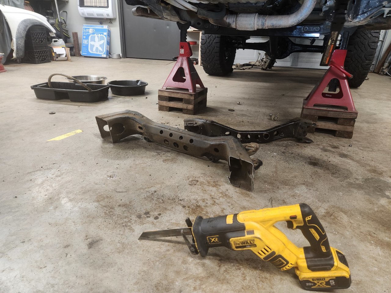

    Well the truck rubbed hard in the front with 35s and the coilovers turned down about as far as they can go so instead of wasting time to make them fit :sawzall:
    And then 3 whole days of grinding
    We then started the fun of measuring measuring and measuring. The laser helped alot in this process
    We decided on moving the axle roughly 2" forward although we'll see how it actually measures once it's on weight. By the end of the weekend we got it tacked up and on some weight.
    Still got alot to go but from cutting Friday night to on weight Sunday evening I think we're moving along pretty good.

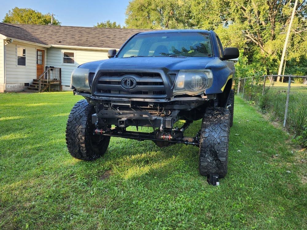

    Well after more welding and grinding we were able to get paint on the frames. Still need to mount shocks and steering but for now it won't rust.
    Got new bushings in the springs
    Annnnnd after bolting up some stuff, we have a roller :D
    Still got plenty of work mainly steering, shocks, brakelines, and oil pan. Most of of the parts are inbound so it's just mainly time.

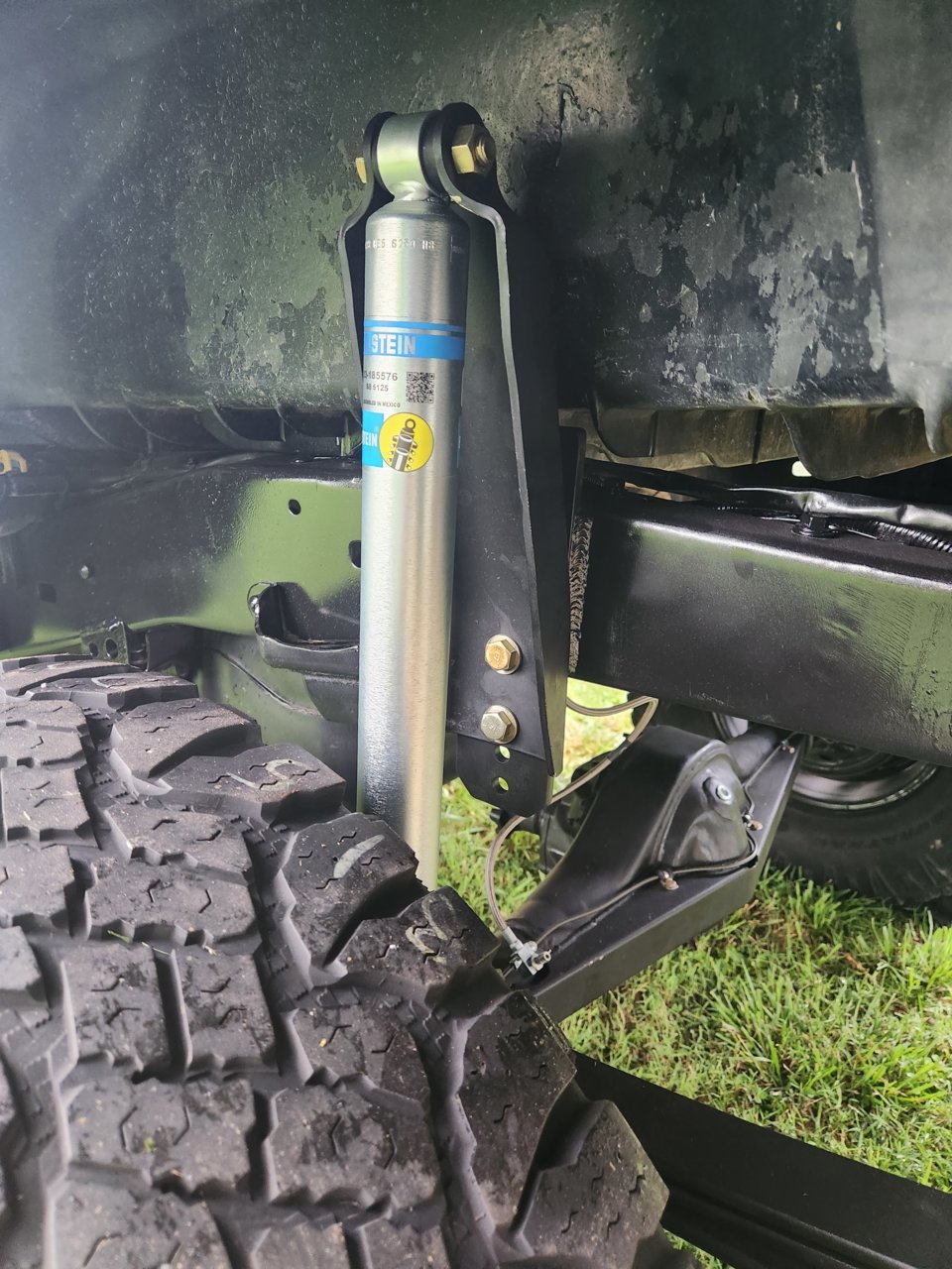

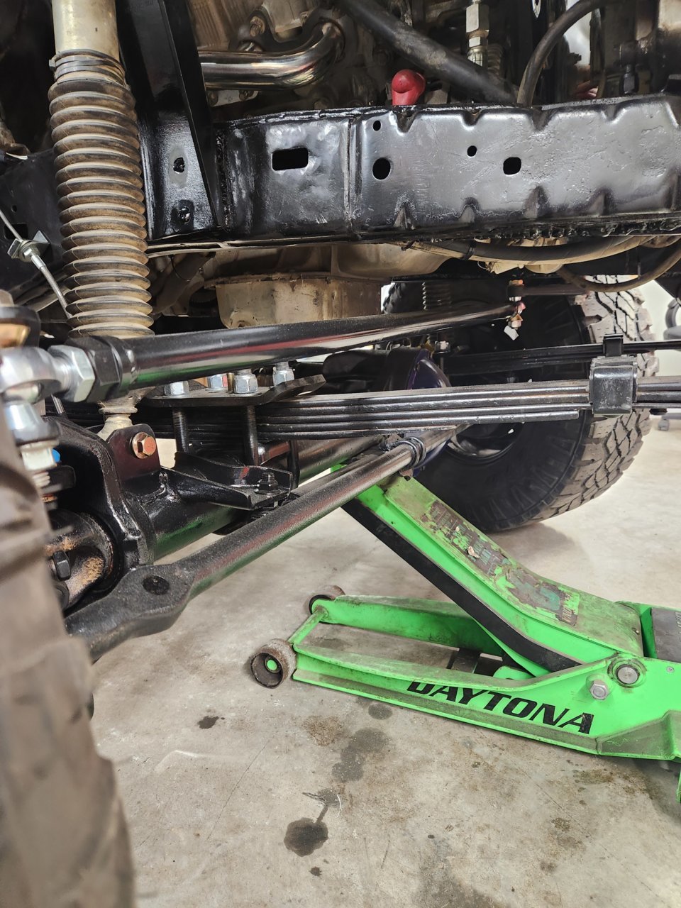

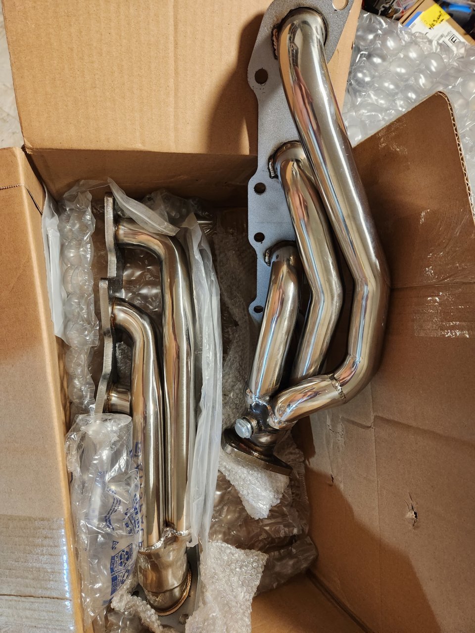

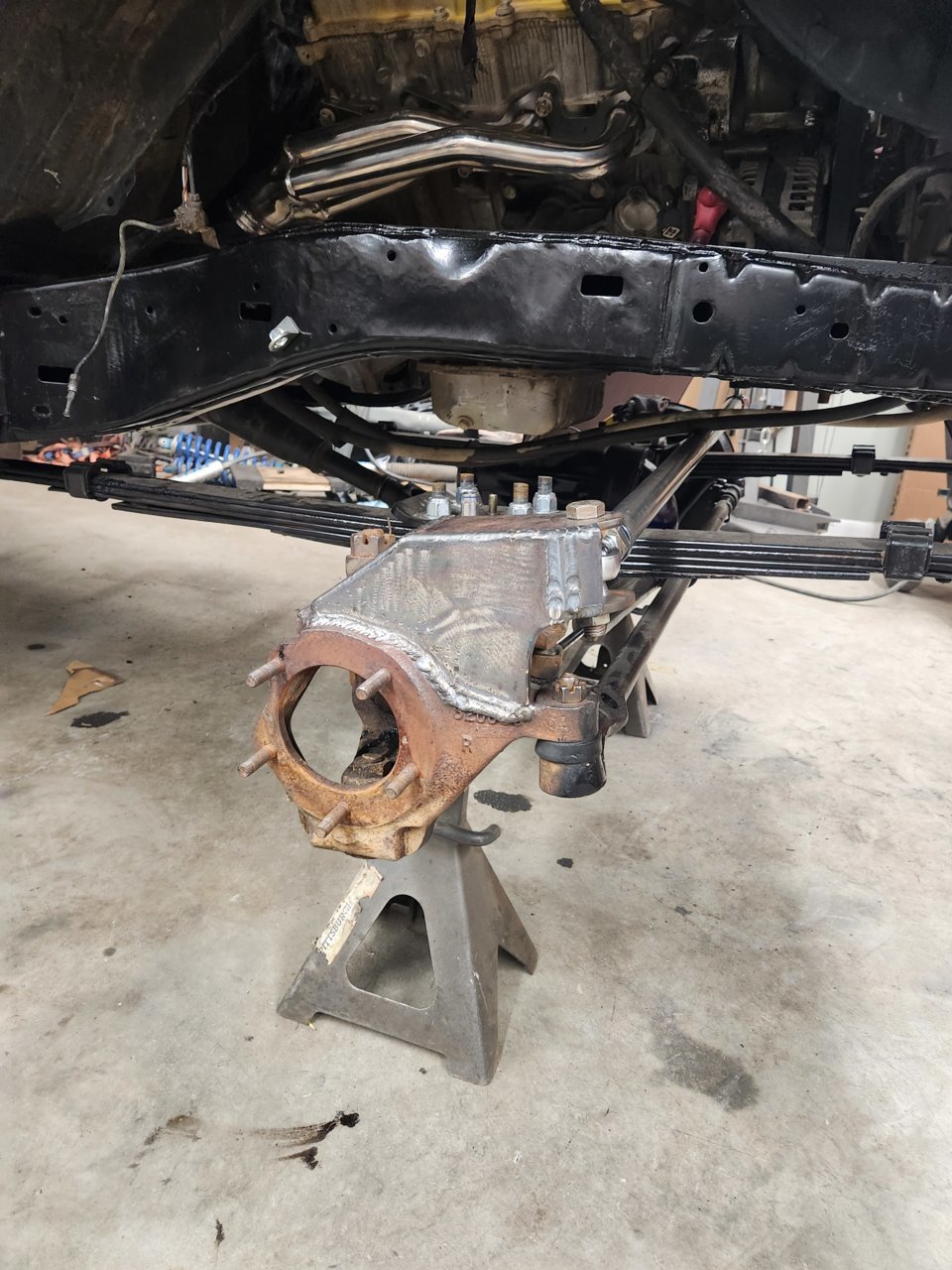

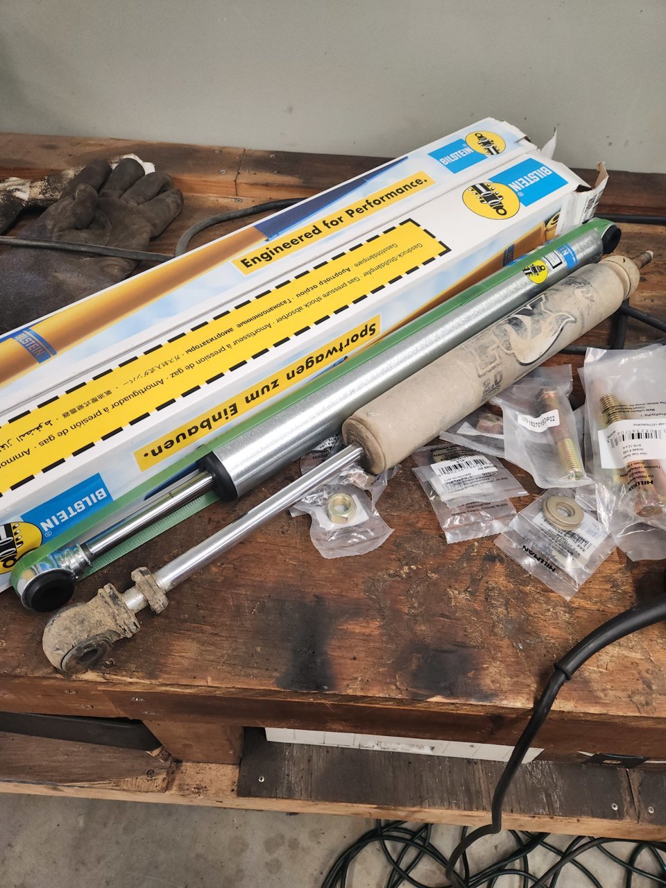

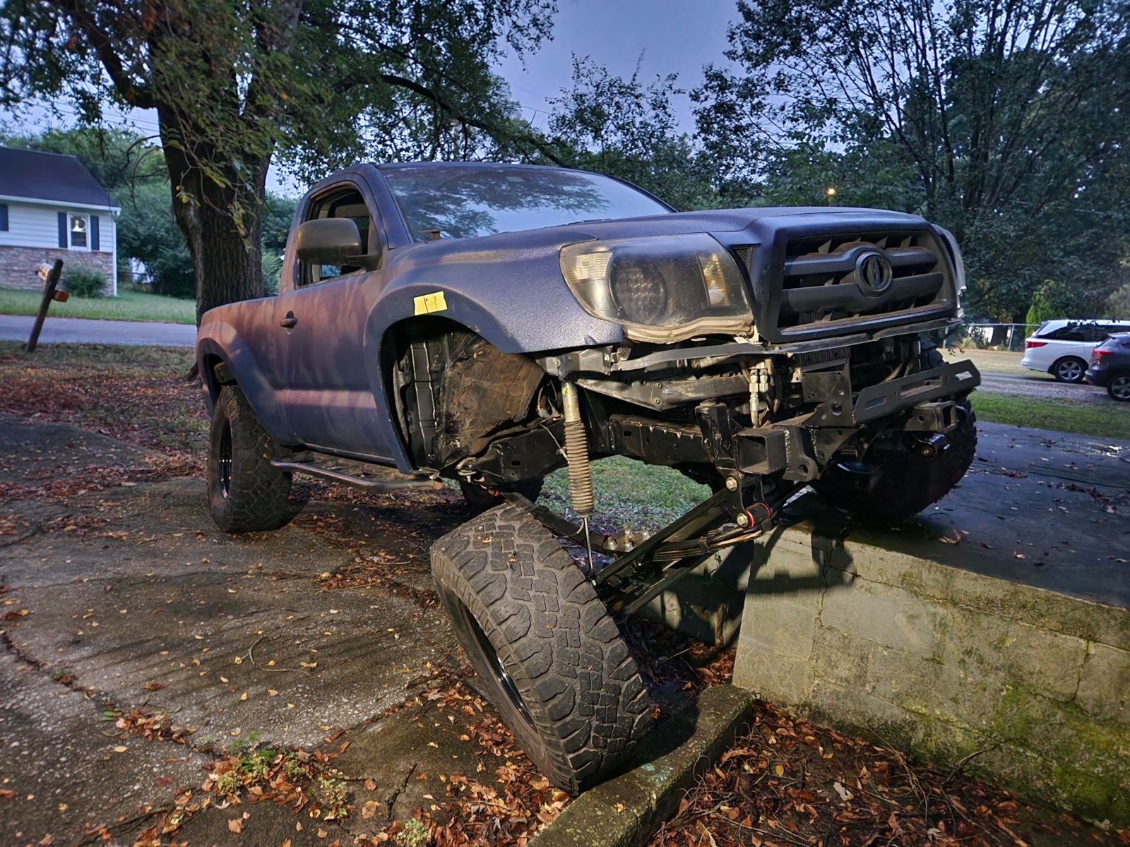

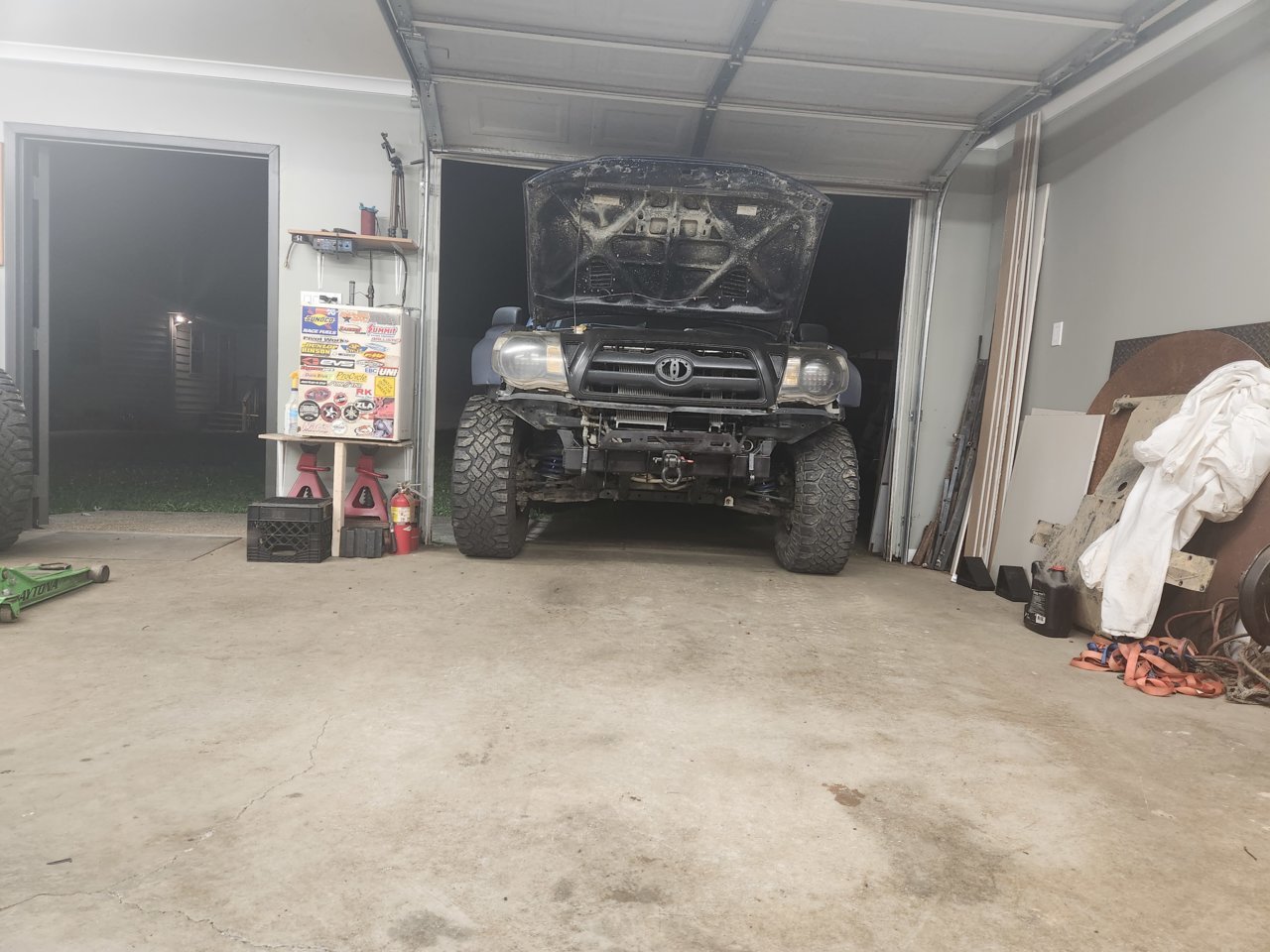

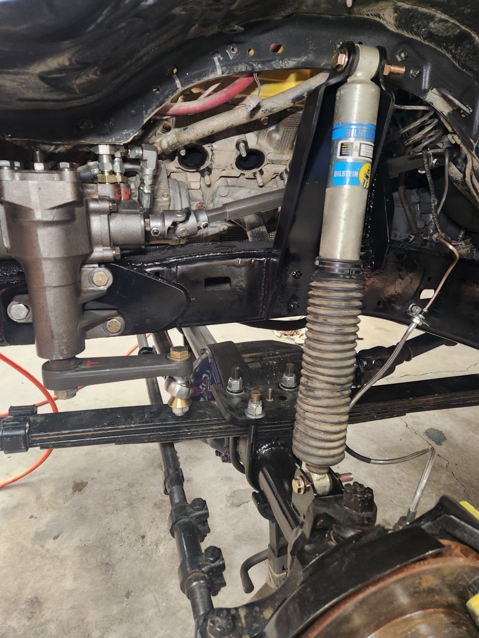

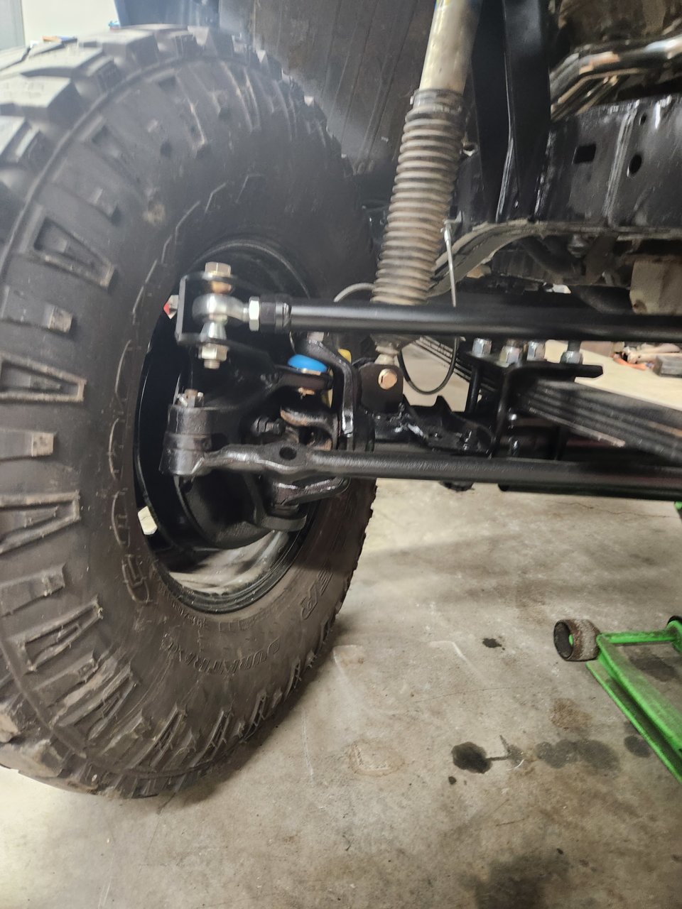

    And now probably the most complicated part of this build....steering. Instead of buying a chevy flat top knuckle, we decided to build our own double sheer knuckle. After the some mathing and a lot of internet researching we came up with this
    We then plated and added the opposing steering box
    As per usual the borgenson joints were a pain to fit onto the steering wheel side of the shaft. The kit we had was ment for a 2nd gen tacoma and came with 11/16 joints on both ends. The steering wheel side was alot smaller diameter and after looking through our parts bin we realized the steering rack has a 11/16 shaft. We gutted the rack and made a stub out of it. We then trimmed and added it to the shaft making it 11/16 on both ends.
    We also slapped in some bilstien 12" shocks and plumped the steering box. For the braklines we used jeep tj extended lines from rough country and only had to change out one fitting on each side.
    The dredded headers are making a comeback again and since the steering shaft has moved a lot they fit with one runner being relocated.
    Still need to modify the exhaust, add the new rear oil pan, and a few other random stuff but very soo will be start up for some testing. Here's a few more pictures
