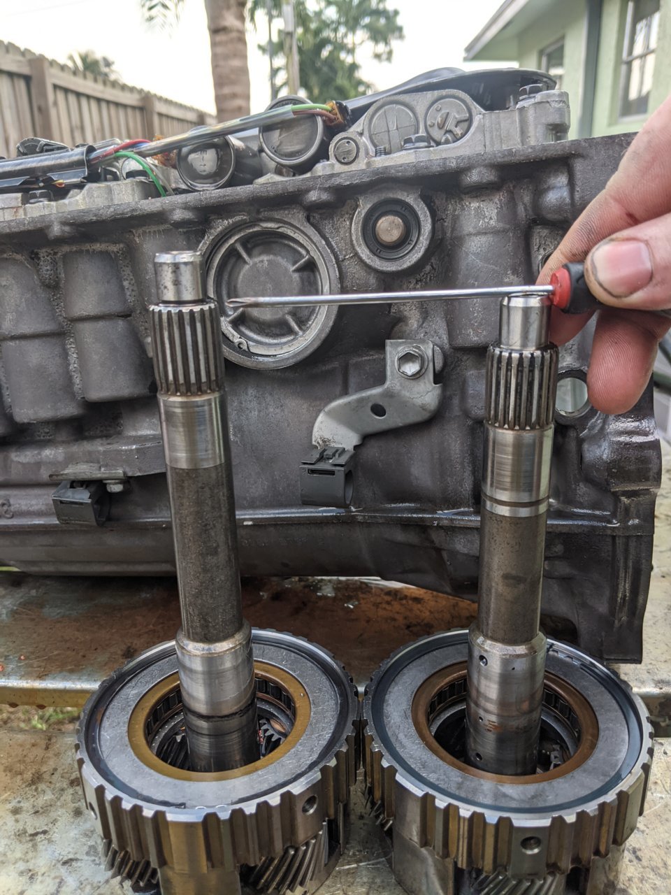

    Sooooo I decided to get another transmission because I feel like I touched too much for diagnosing right now. Just need the truck moving lol so I picked up a jdm a340e from a 1jz vvti with low miles and was super clean. Now this transmission uses 5 solenoids. The extra solenoid is for line pressure and without power it's on max. For now I'm leaving it this way and the only real issue may be the lock up solenoid since it's pwm now.
    Slapped the transmission in and everything seemed good so far. I drove around the block with no electronics and just used the manual part of the a340e to shift throw 1st and 2nd (can't get to 3rd because open headers in a neighborhood lol)
    So I decided to get on it a little and shift. I rode out 1st (not even close to rev limit) and shifter to 2nd. Annnnnd then I had nothing and when I shut the truck off I could hear a grinding sound coming from the tranny.
    I had a feeling it was the input shaft as when I swapped the torque converter over the new transmission seemed to have a shorter shaft. I figured I didn't reassemble the old transmission right so the shaft stuck out more. Nope there is a difference between v8 and straight 6 a340e's
    I didn't realize it was that much shorter and I rounded the shorter shaft as it was barely engaged.
    Notice the nice chamfer on the end
    So I swapped the input shafts as well, as part of the pump because there was also a difference in length.

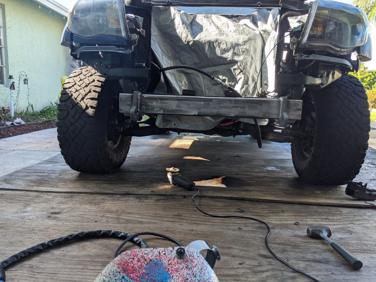

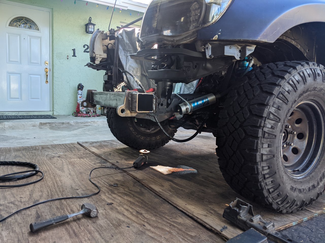

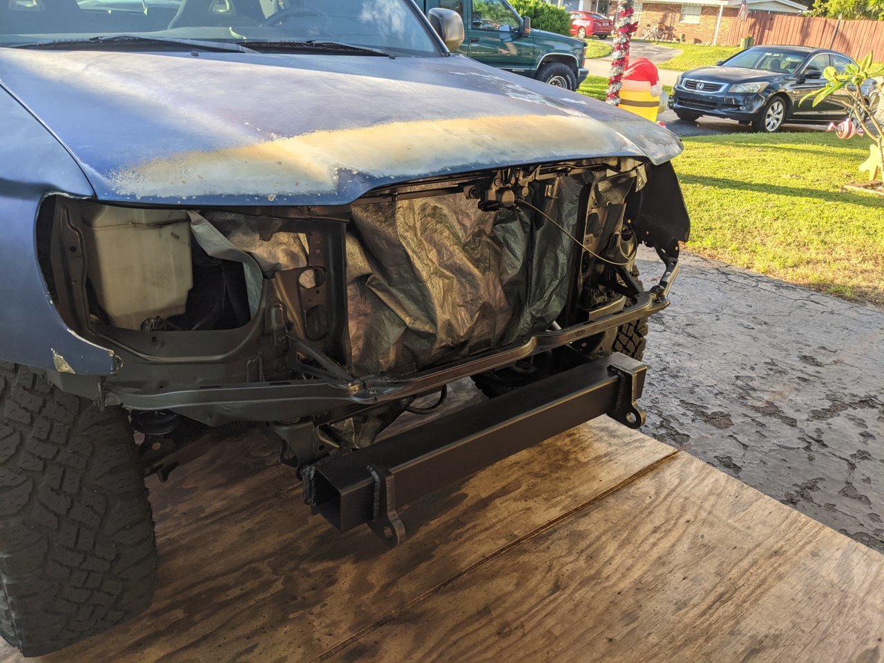

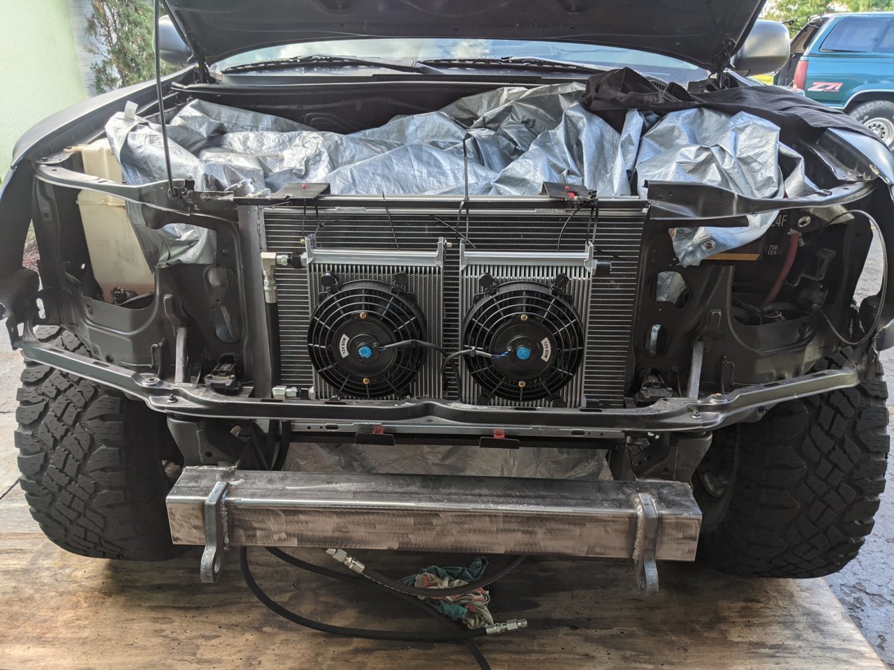

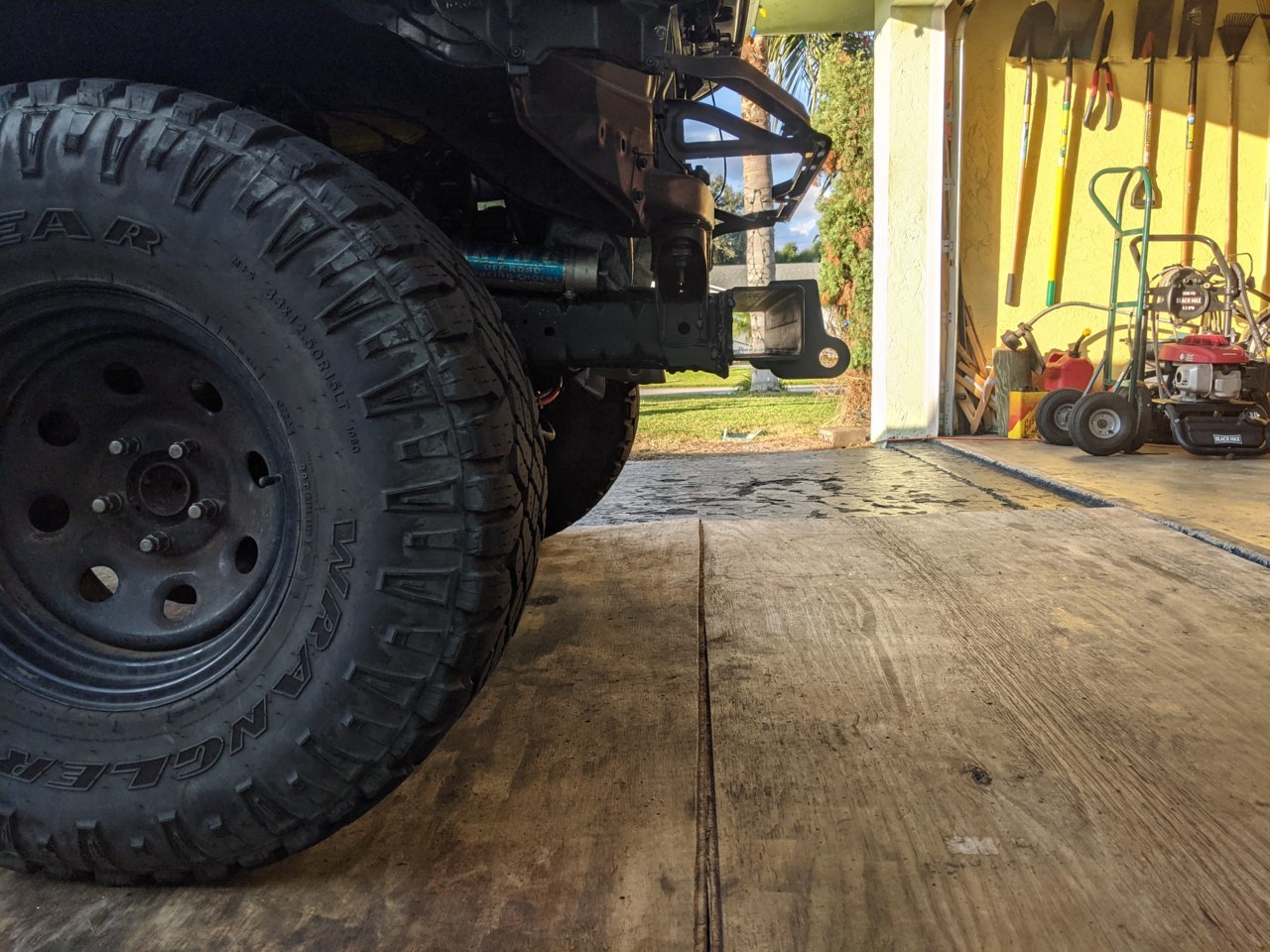

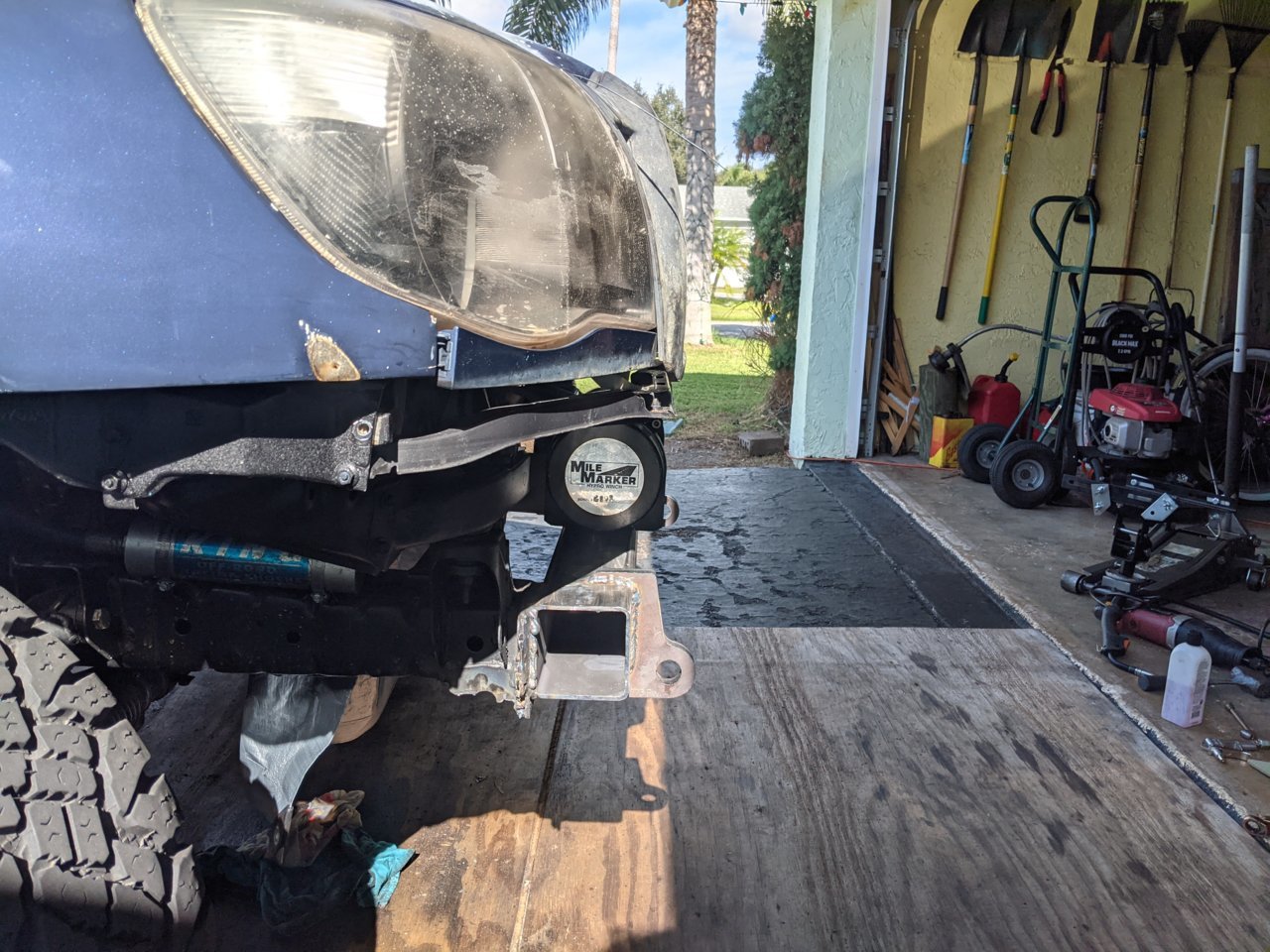

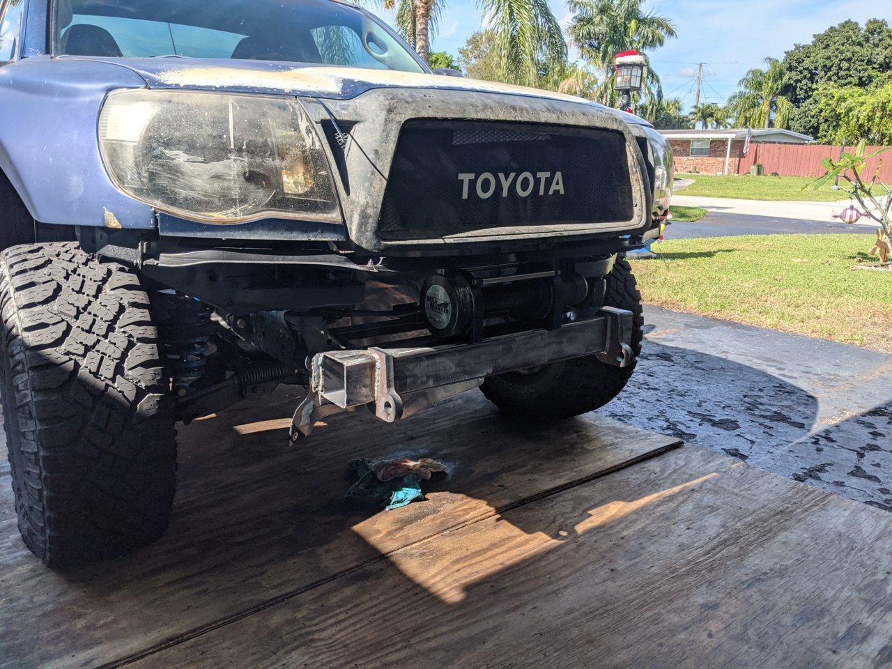

    So I have a new set of log headers inbound and while I'm waiting I decided to start the front area.
    The first task was to install a new cross member and cut the old one out. The new cross member is higher making my front clearance much higher. I've also added some new shin destroying recovery points. Eventually the winch and front hitch will also attach to the new cross member along with some more bar work to protect the grill.
    Unfortunately the winch won't be able to sit that tight as it was too close to my new coolers, but it does look good for pictures lol
    Started to figure out the coolers for the transmission and power steering/winch
    Now I will lose alittle clearance when I add supports for the skid plate but I'm going to try to maintain it as much as I can.

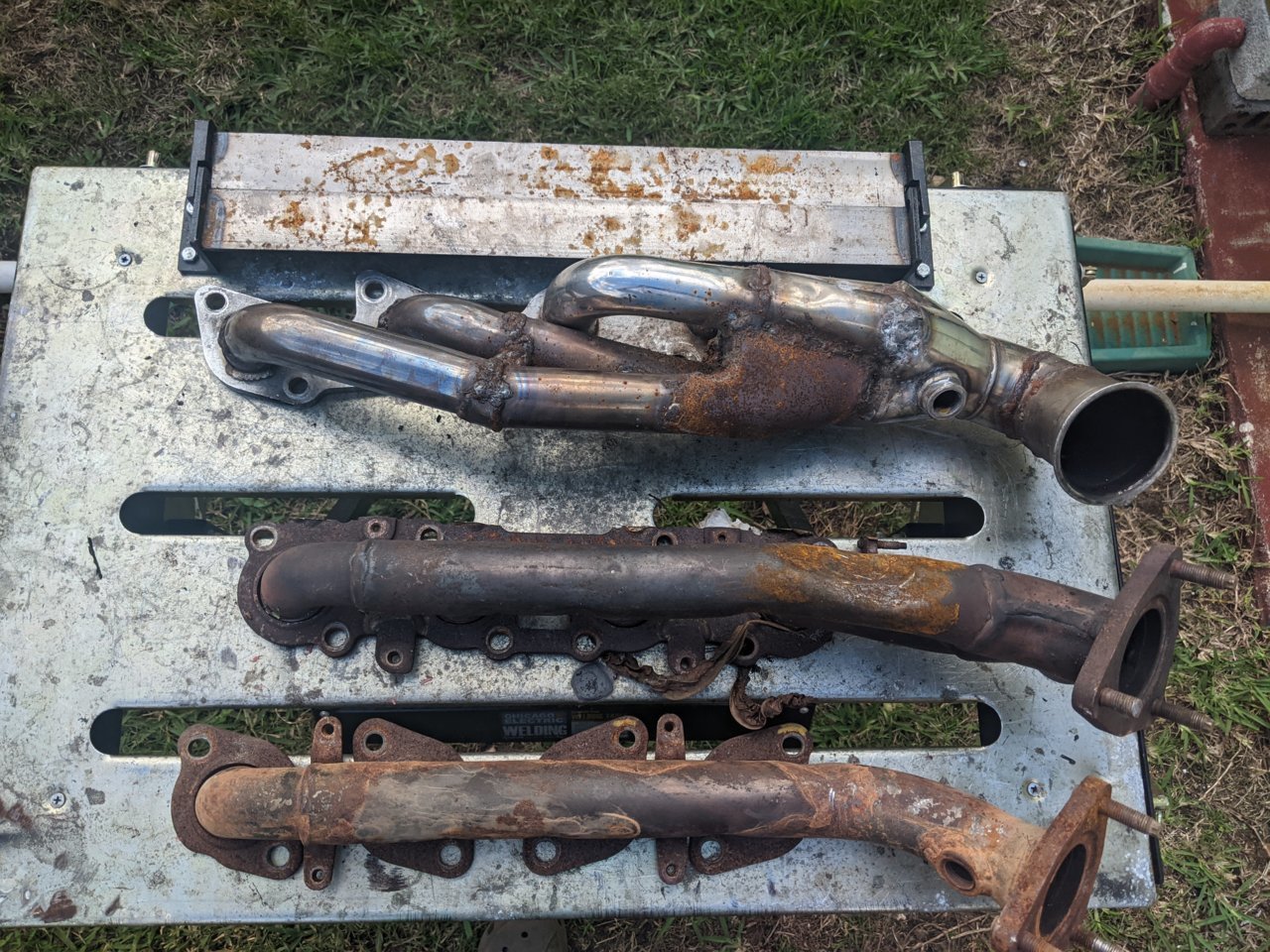

    Super slow progress but I got the exhaust back together. I had to ditch the ebay headers and go with 01-04 tundra headers. They are log style and clear my steering shaft with alot of extra room. I did so try the later year tundra but it was still too close. Yes they are all rusty and the ones I'm using are on the bottom and already have the 3 bolt flange replaced with a marmon flange.
    The next step is finish up adding my coolers and then more road testing.

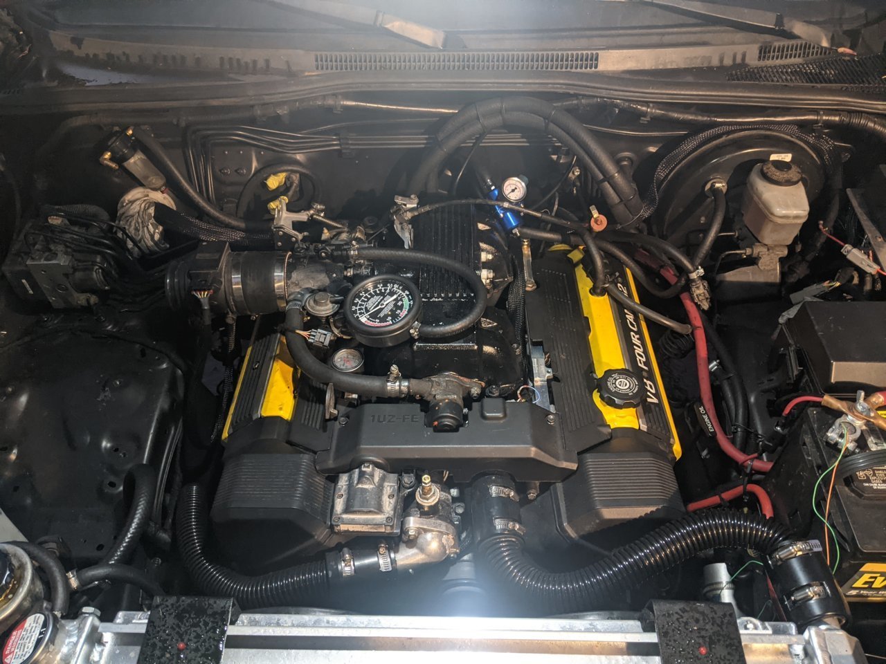

    So the engine was running super rich and had all the fun symptoms like black smoke, fowled plugs, engine shake, negative fuel trims and it sounded like it had cams. I ended up going through a lot of the engine to try to diagnose the issue. In the process I went through the wiring and didn't see any thing that really stood out. I then decided to yolo an ebay fpr because I had suspicion that the stock one wasn't keeping up with my dw200. I now have a different engine, its no longer boggy and running super rich. I found out my tps sensor was broken as well so I have another one inbound. Even with the tps sensor remove it revs like a normal v8 now.
    Yes the engine bay is a bit of a mess and I've already cleaned it back up for now.
    Next is to mount the coolers and work on the electronics for the manualizing the transmission. Its getting real close for me to take it on longer test runs.
