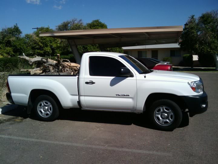

    I bought my 5lug base Taco few months ago in the end of July. I needed a truck for work, the car I was driving had bad overheating problems and I didn't have time to shop around until the right Taco came around. Ultimately I wanted 4x4 regular cab. However this white little truck was the only Taco available in my area which was in my price range. The Taco had 23k miles when I bought it, which is ok amount for two year old truck.
    The base 5lugger looks funny bone stock, its low with tiny little tires. I knew that it won't stay stock for long :) I had to select my modifications very carefully and do a lot of research, because I couldn't blow ton of money on the modifications. Here is few pictures of my Taco bone stock next to my lady's 07 Camry;

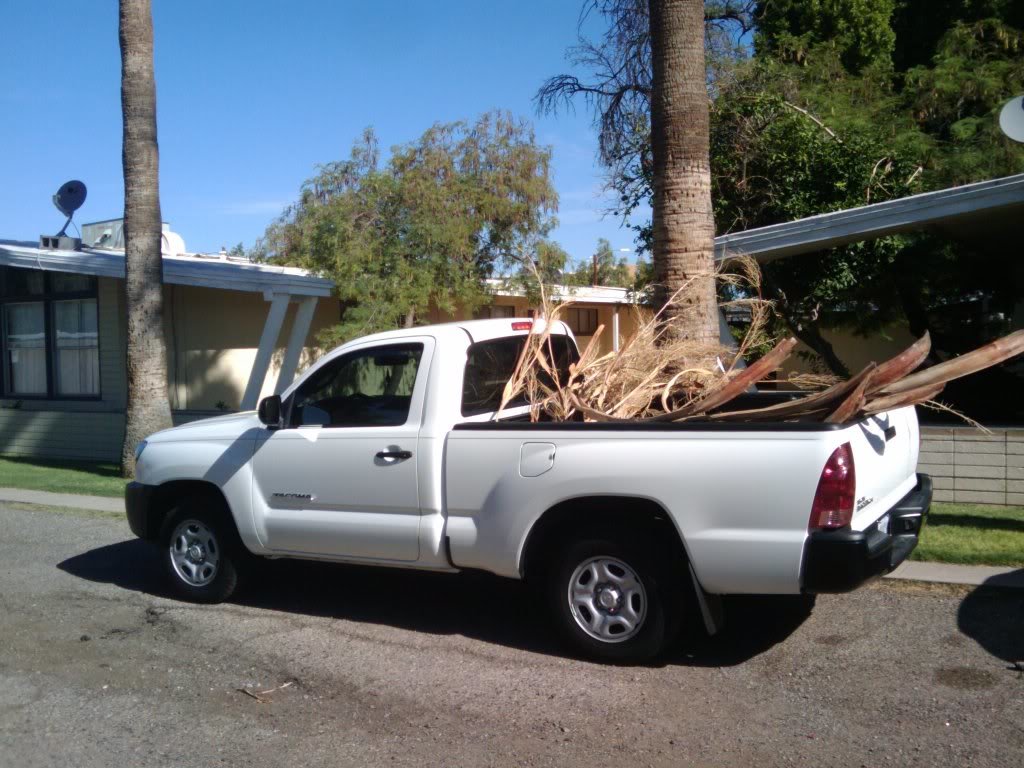

    Hauling stuff;

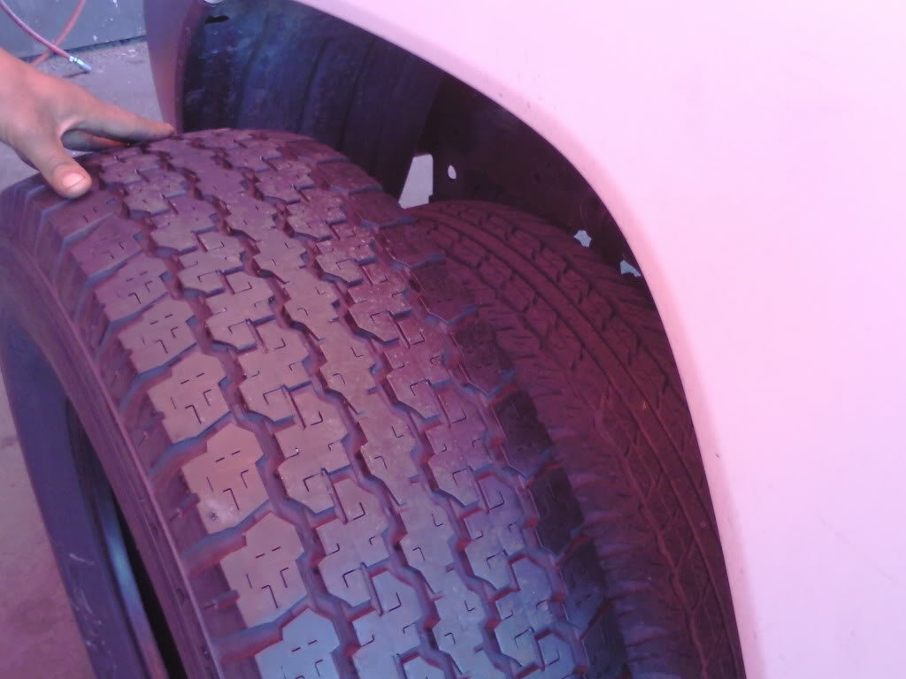

    Sitting in driveway, here you can see how bad it looks with stock ride height, stock tires and stock rake;

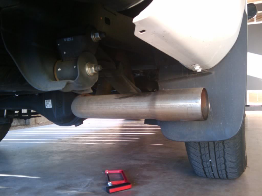

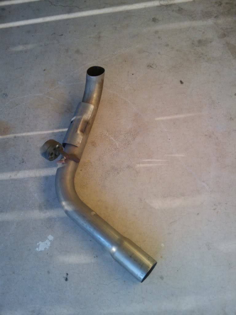

    My first modification was taking off the mud flaps and cutting the stock exhaust. I didn't like how it curves around and sticks out;
    About 10minutes with my hack saw and the exhaust was cut, looks much better!!
    The portion which was cut;

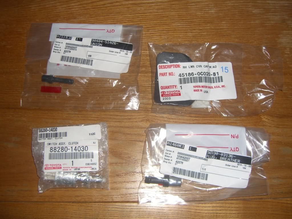

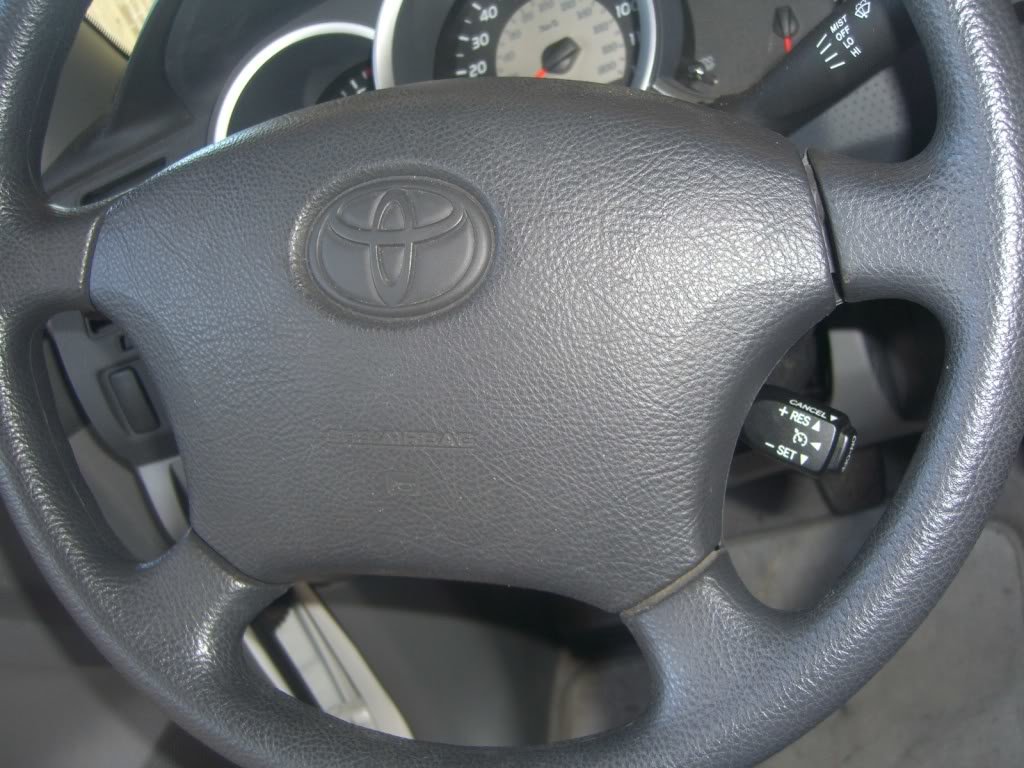

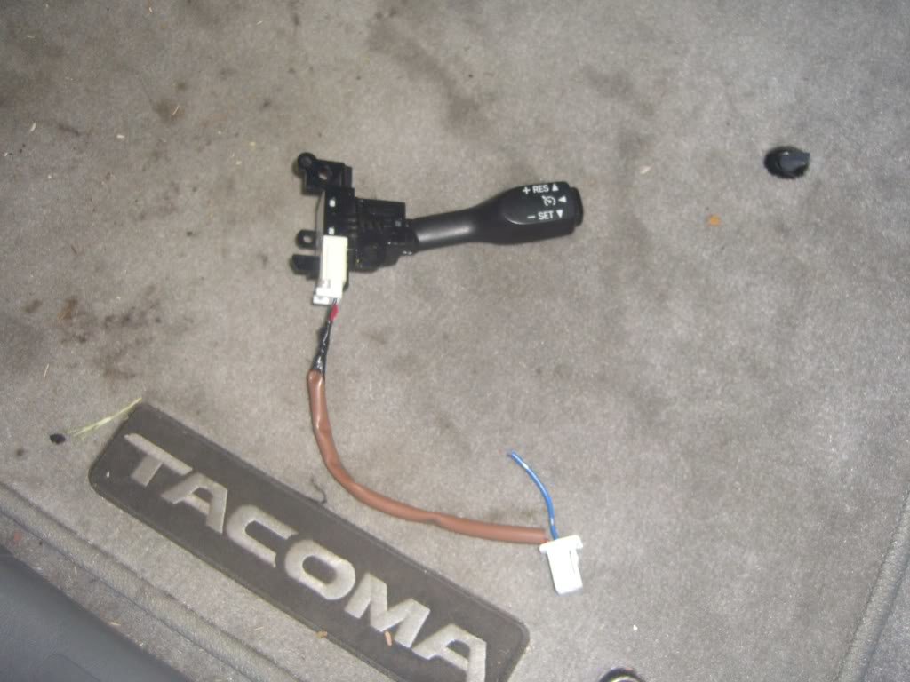

    Second modification was OEM cruise control. I do quite a lot of driving on highways and being able to set the cruise is much more pleasant than watching my speed constantly...
    I sourced the cruise control stalk from a member here for $25 shipped...
    Then I ordered the clutch switch, steering wheel cover, union and diff breather from Toyota of Dallas. Yeah even shipped it was cheaper then from a local stealership...go figure...
    OEM cruise installed, works awesome!!

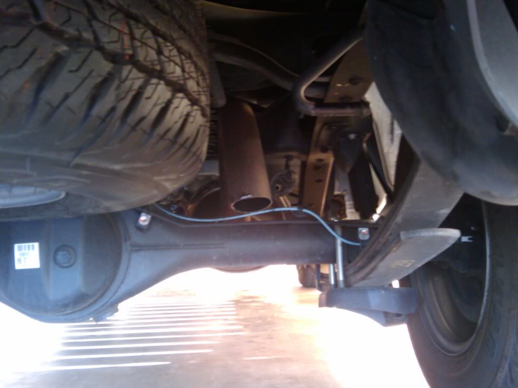

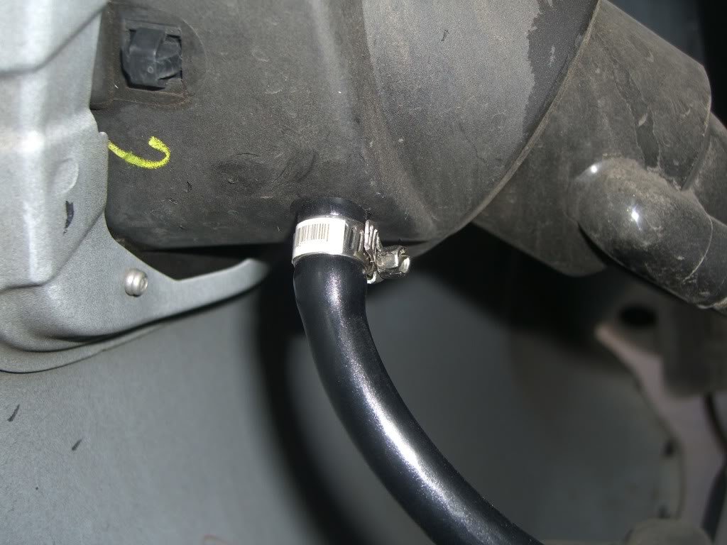

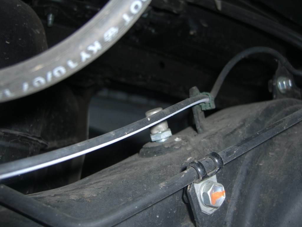

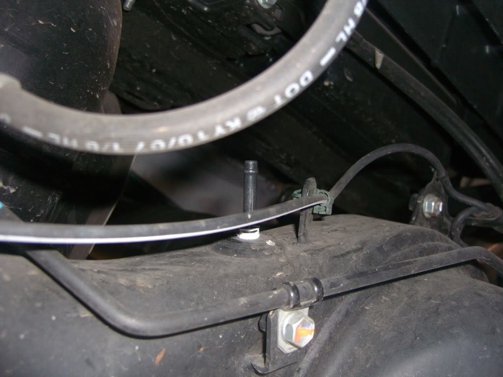

    Then i relocated the rear diff breather. I don't know if I ever go through high water so the breather would get submerged fully, however this mod cost me around $15, so why not? Better be safe than sorry, right? Stock rear diff breather;
    Stock rear diff breather is out, union in its place;
    Rear diff breather relocated;
    I used metal clamps and fuel line for the rear diff breather;

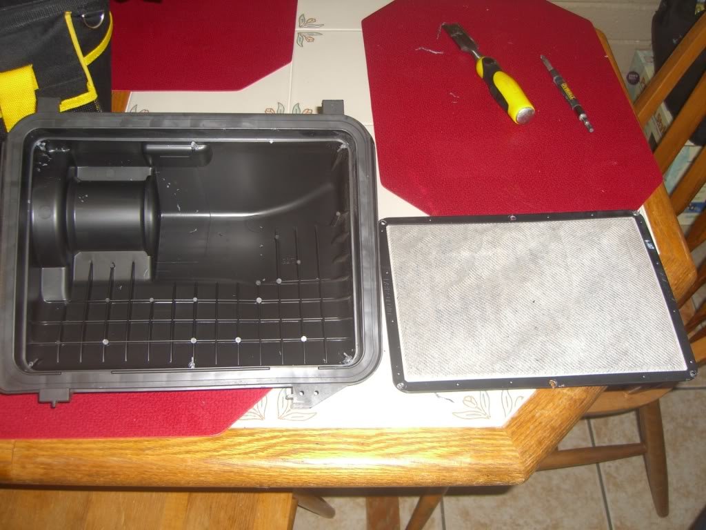

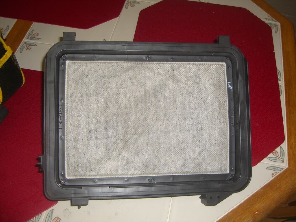

    After reading up on intakes for the taco, I have decided to stick with modified stock intake.
    I have removed the 2nd air filter. Air box with the 2nd air filter;
    2nd air filter removed;

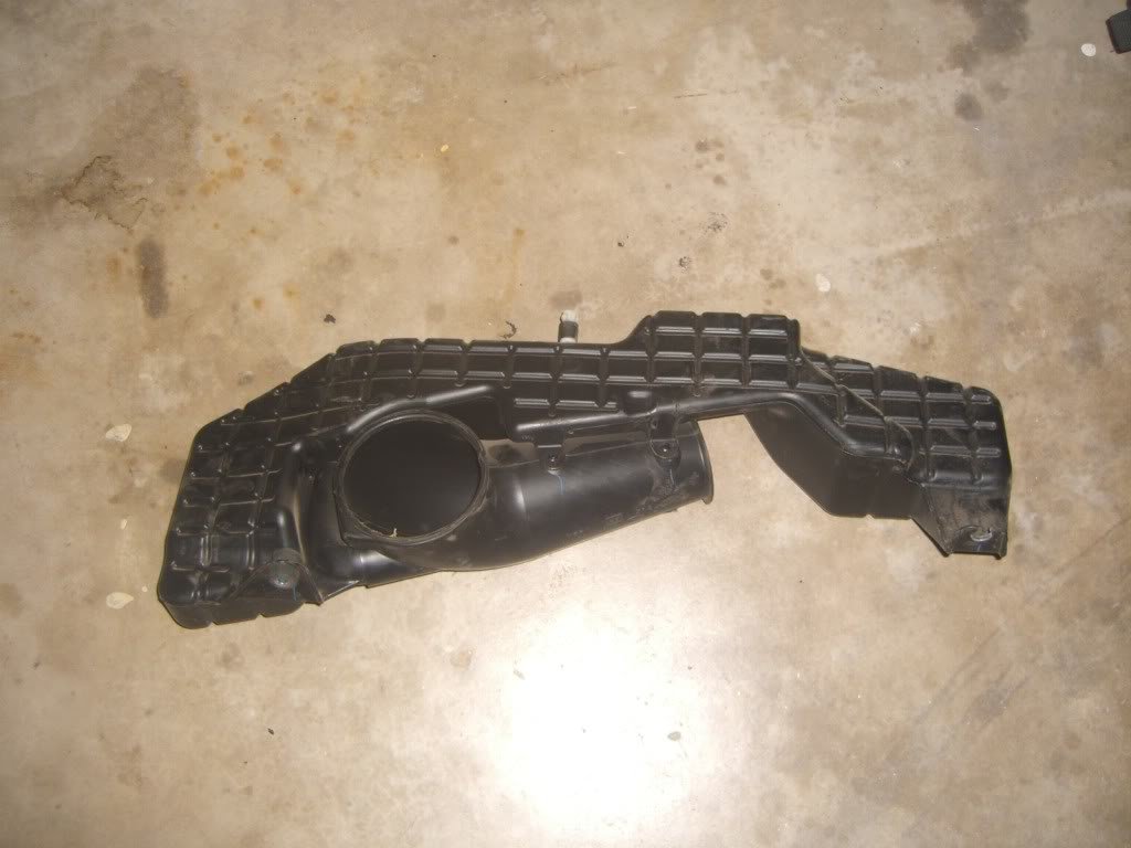

    Then i removed the huge resonator from the fender. There is no purpose to this resonator other than making the intake quieter. The size of this thing amazed me...lol

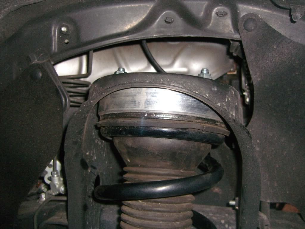

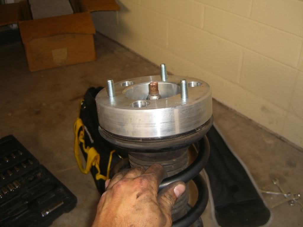

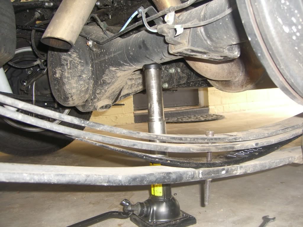

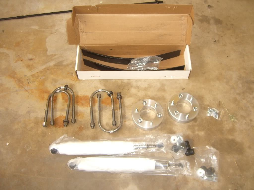

    Now was time to lift the truck. There are two lift kits available for the 5lug Taco. The ReadyLift for about $350 shipped and Fat Bob's Garage lift kit for about $250 shipped. I have chosen the Fat Bob's kit, because it is cheaper and comes with longer rear shocks.
    Fat Bob's Garage kit. the kit comes with front spacer & nuts for the front spacer, rear add-a-leaf manufactured by AllPro, rear longer shocks & longer U-Bolts with nuts. Kit is high quality and easily installed in your driveway;
    Front spacer installed on top of the front strut;
    This is how it looks installed back in the truck;

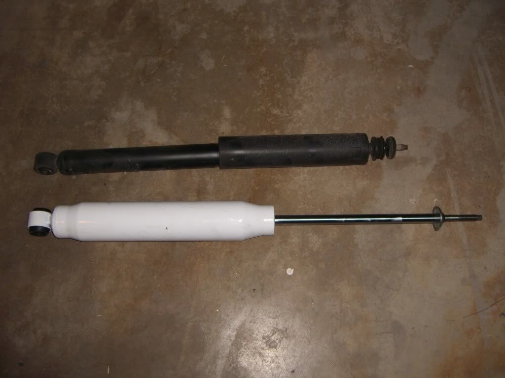

    Fat Bob's Garage rear shocks next to stock rear shock;
    Add-a-Leaf installed;

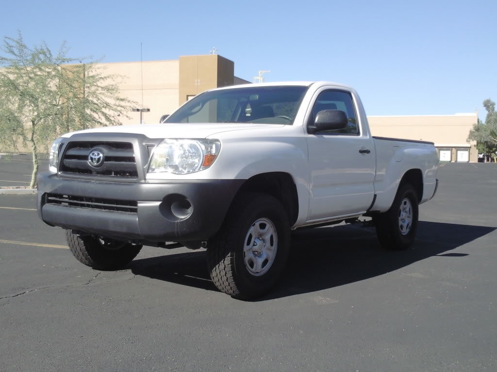

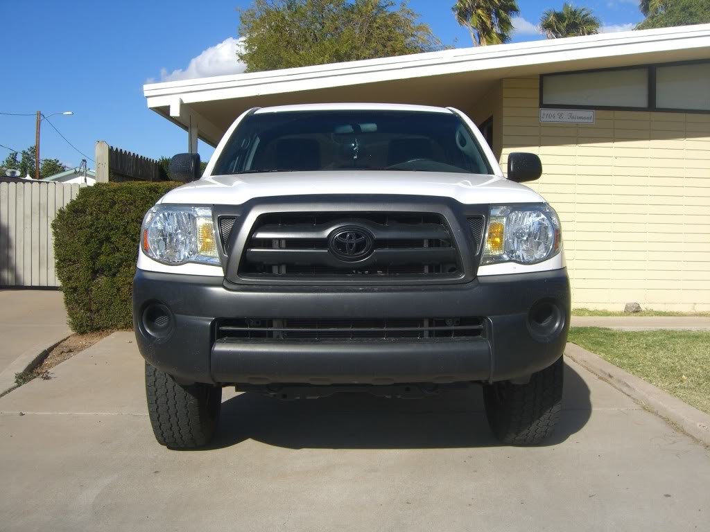

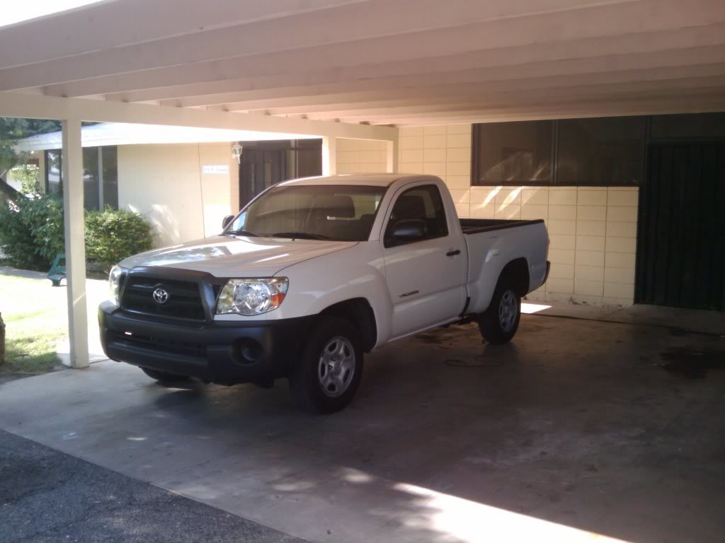

    Now the truck is lifted and the only thing it needs to complete the outside look are tires. I was planning on keeping the stock tires for a while until they are gone. That was cut short by my offroad trip, when I got back my rear tires were shredded with chunks missing out of them. My spare had a nail in it, so I broke down and bought tires. At first I wanted to get 30x9.5x15. When I was looking at the used tire yards, the only set of 30x9.5x15 were run down BfG's... Next to them I saw nice looking Bridgestone Dueler H/T in 31x10.5x15, they had what seemed to be like 60-70% thread left and the used tire yard wanted $200 for the tires, mounted & balanced, so I pulled the trigger. New tire next to the stock tiny tire;
    This is how the truck looks now... Much better than stock right?

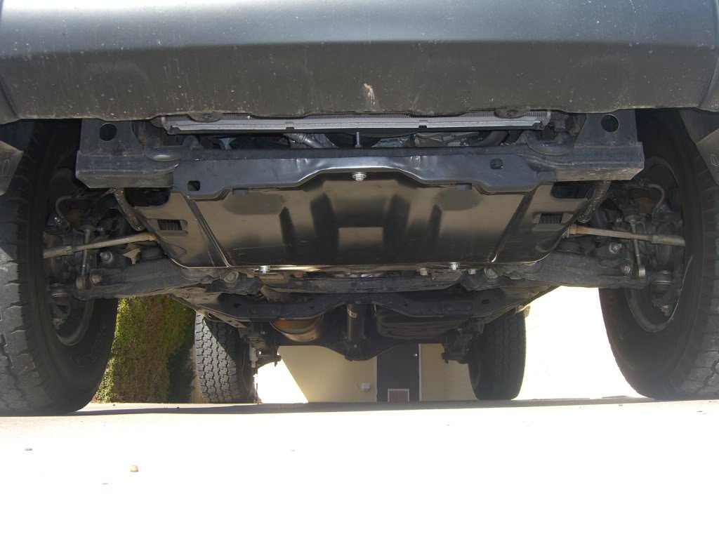

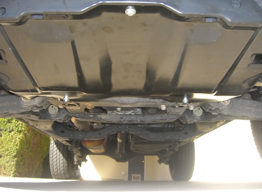

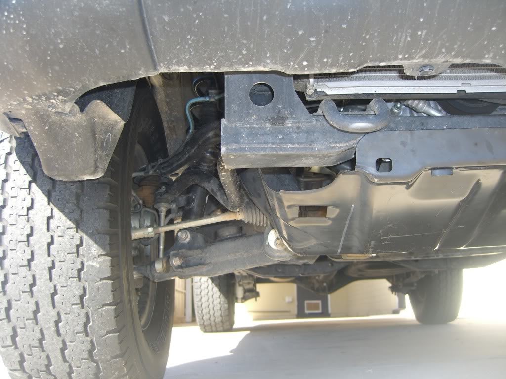

    Stock 6lug skid plate. For more info visit this thread; LINK --> http://www.tacomaworld.com/forum/5-lug/125676-stock-6lug-skid-plate-5lugger-taco.html#post2432709

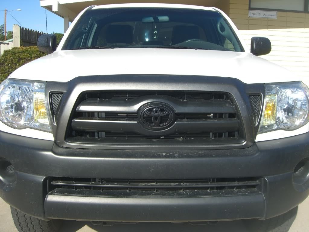

    Painted the Toyota symbol black. Last chrome thing on my truck... I HATE chrome...LOL Way easier than Satoshi grille and looks pretty good. I did 4 coats of gloss black. My intention was for the emblem to stand out a little bit, that's why I chose the gloss, instead of flat.

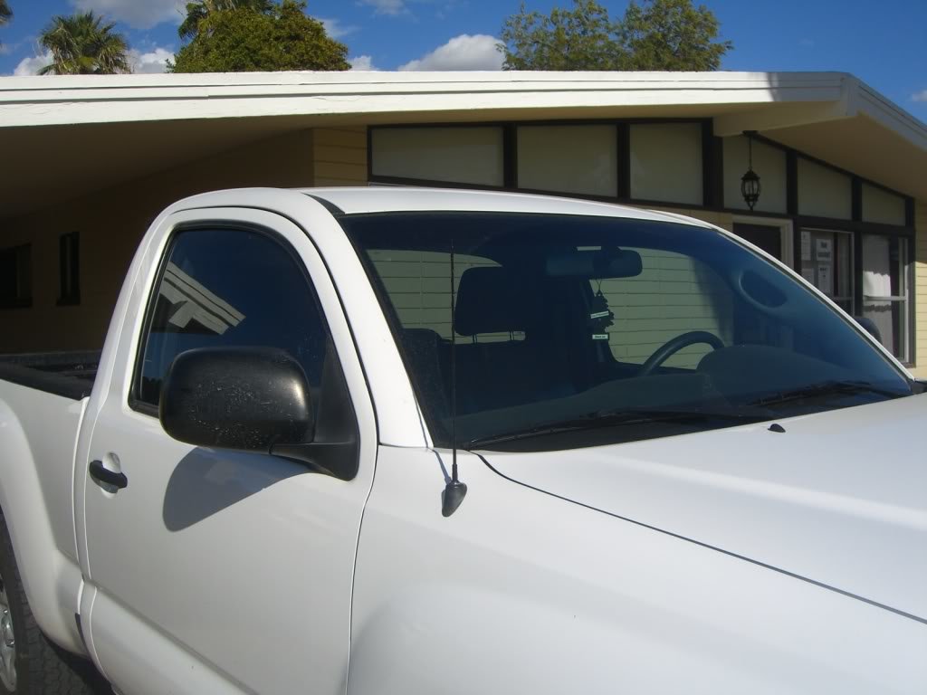

    I also got tired of the stock whip. I hit it a lot under trees, off roading, etc... I cut it and gave it few coats of gloss black to cover any exposed metal.

    Yesterday I installed Fat Bob's Garage shock boots on my rear shock. The shock boots protect the exposed piston part of the shock from dust & road debris.
    Shock boots before installation;
    Rear shock without shock boot;
    Shock boot installed;

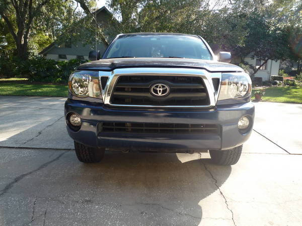

    Looks Great! I too did the Spacers in front and Rear Add-A-Leaf and put on some 30X9.5X15's and it looks great. They are on stock rims that I painted black. Let me know how the new headers are and how they affect the performance. Im looking into regearing my truck to 4.30 if I can find gears that size... 4-Wheel parts has a place to install and buy parts from near by me and all they have is 4.56. Did you install these gears yet? I know i definitely need them, my mpg's went from a normal 20 average to 18 average and the power feels like junk.
    Great looking truck! Where did you find the breather mods for the rear diff? I need to get that as I go offroading alot.
    Suggestion to complete the overall look you might want to look into some black headlights they are stock looking but with black inside. Check out my photos and see if you like them. :)
    Stock Rims Painted:
    Heres what it looks like with the lift and painted rims:

    I haven't installed gears yet and most likely won't be for a while as well as header, I am getting married in April... I wouldn't go higher than 4.10 gears.
    For the rear breather I just got the union & breather from Toyota, fuel line & clamps from ACE. The part numbers are; Breather 90930-03136, Union 90404-51026.
    I don't want to take the stock lights apart, I am afraid that I won't seal them correctly and I will have condensation issues...
    Good looking truck. Sometimes I wish I got access cab, but those are so hard to find here in AZ. Most poplar truck here is PreRunner, Double Cab automatic...
    I wouldn't think so, since it is a part which you cannot see, unless you take off the fender.
