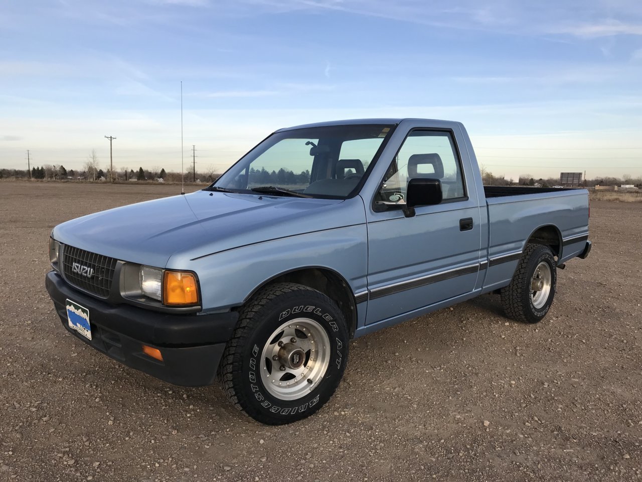

    I used to floor this stock go cart all the time so I can relate to your story!! Sold it last year though. Most fun manual I ever had.
