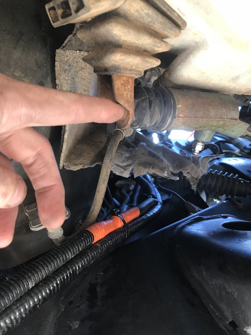

    That makes sense. Would it be this piece that i would push in on? If so, how would i go about disconnecting the clutch linkage? I dont see any way to do that and the boot wont move..

    It's not connected, just push in on it with someone holding the clutch pedal down and the bleed screw open :thumbsup:

    I just pushed in the rusty portion on the pic above and then closed the bleeder. It pushed some fluid and maybe a little air out. Should i just keep bleeding the hell outta the system?

    Get between the rusty fork and rod, the rod should go in more. There's a spring fighting back on the rod, don't let it back out until you've closed the bleeder.

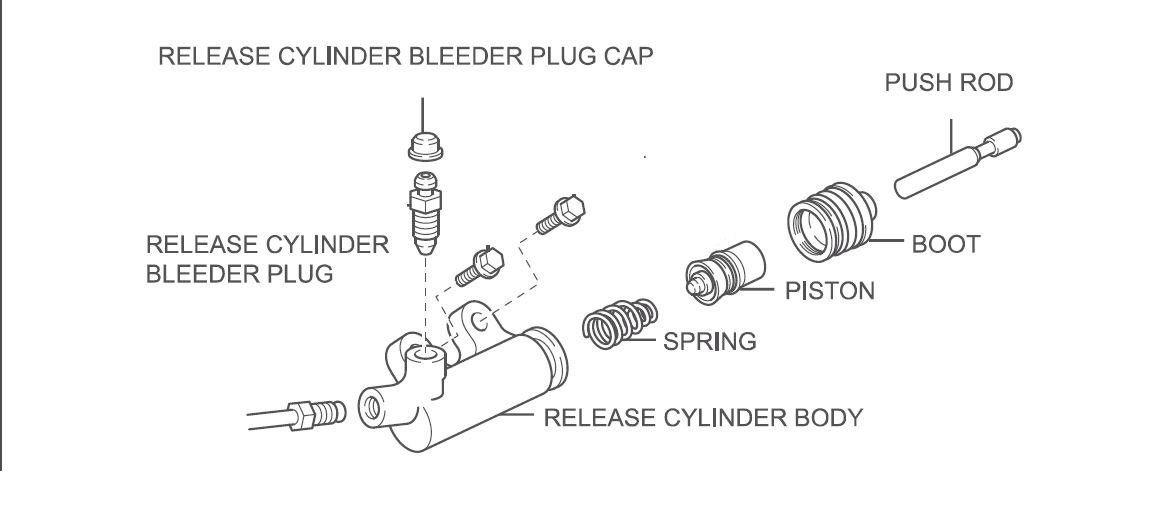

    We're referring to the push rod on the slave cylinder
