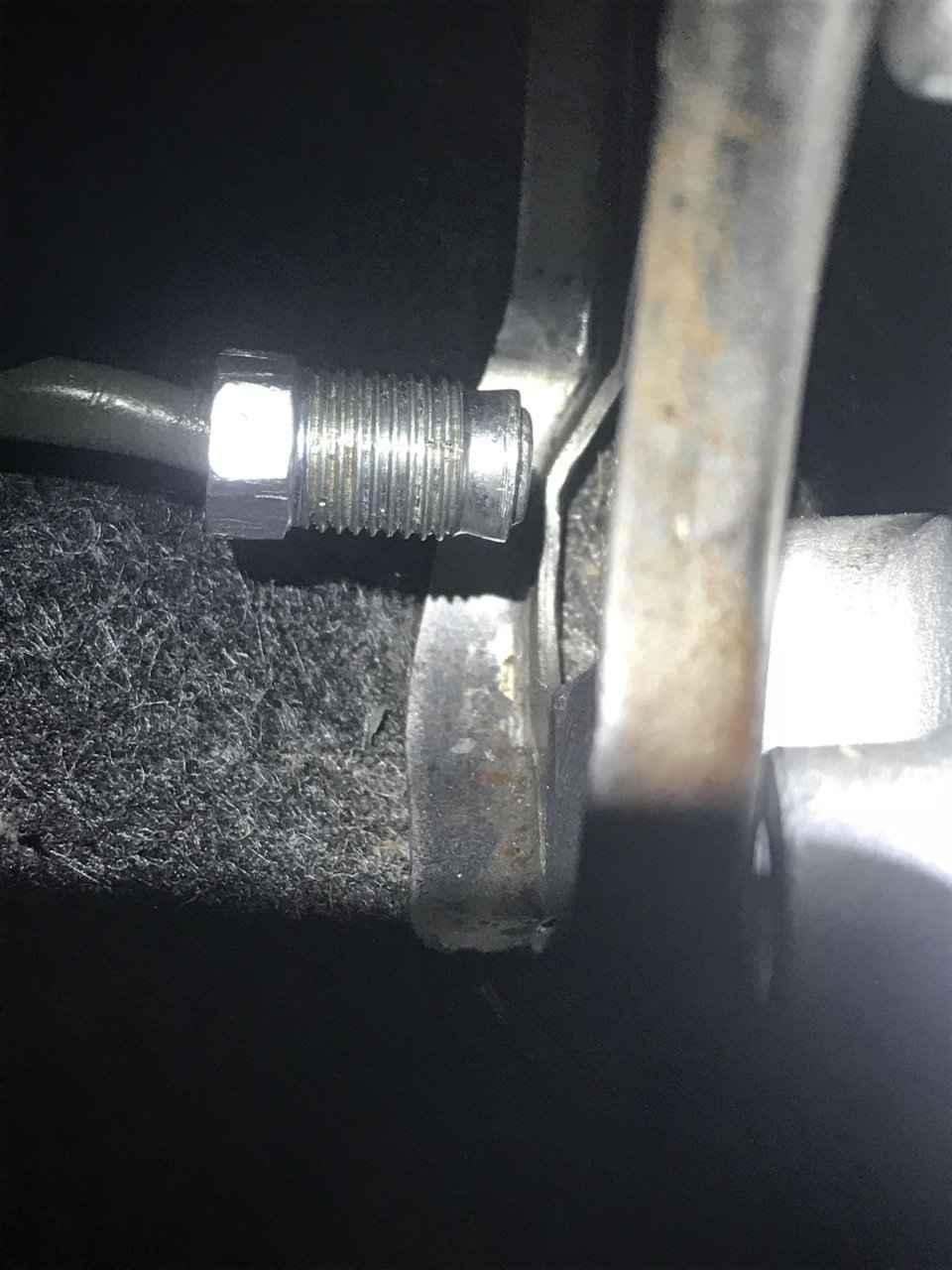

  2. Aug 13, 2018 at 3:36 PM
    #82
    b_r_o
    b_r_o Gnar doggy
    Nov 17, 2016
    #202672
    14,556
    Alex
    WA
    2015 DCLB
    That's just a (brake) line wrench, commonly referred to as a "crow's foot".
    If the brake line fittings are not over-torqued, a basic open end 10mm wrench will be fine.
    BassAckwards[OP] likes this.

  6. Oct 30, 2018 at 7:37 PM
    #86
    BassAckwards
    BassAckwards [OP] Well-Known Member
    May 3, 2016
    #186002
    27,954
    2009 Tacoma AWD Turbo 2TR-FE
    Full-time AWD & BorgWarner EFR 6258
    Can anyone here please help? I am trying to replace my clutch master and the stupid fitting on the hard line doesnt want to thread into the master. Ive fought this thing for several hours now, and have gotten no where.. any advice?
