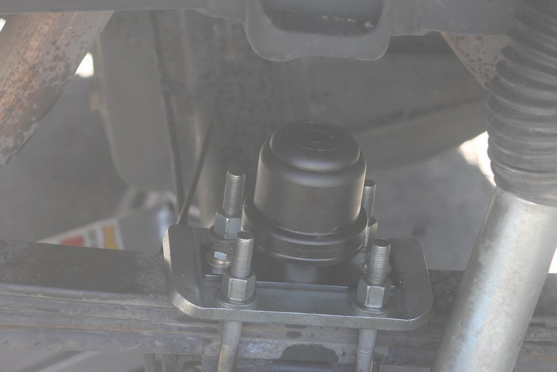

    Question: How do I add a bumpstop to my leaf pack if I am using a flip kit? Also any recommendations for extended brake lines?

    Wheelers sells their Superbumps with a bracket just for this application. Requires drilling and tapping 2 holes in ubolt plate per side. Some on here have made their own mounts.
