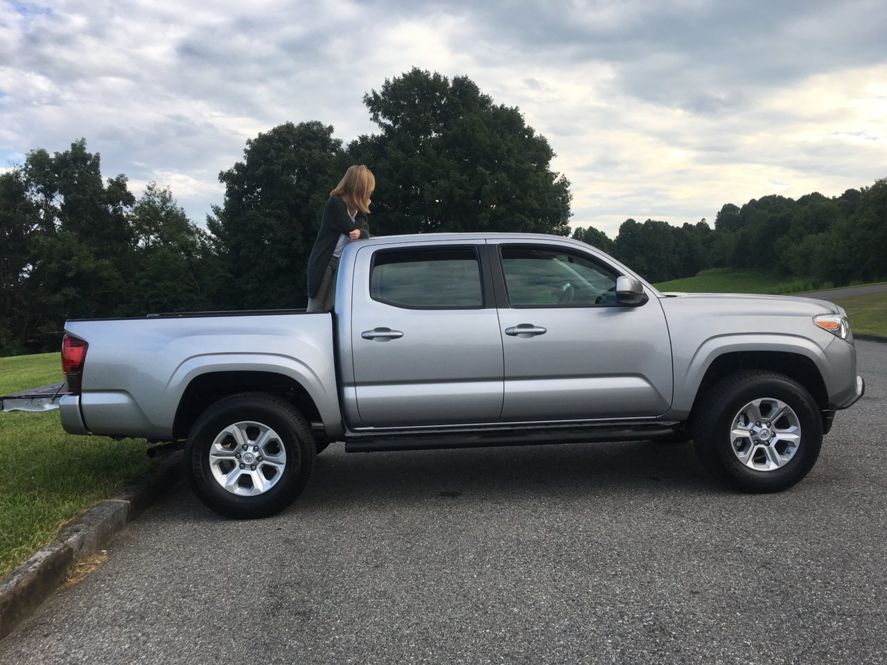

    A8D3688B-D2F5-4461-9CF9-43474DC80AE9.jpg F21485A1-9C80-40A6-BCA6-2CA10AC040F9.jpg They fit stock. I like how they look, clean or dirty. They will be my 3 season wheel. Throwing steelies back on for winter.

    Yeah they fit. Push the CL of wheel out about 3/4".20181015_190116.jpg

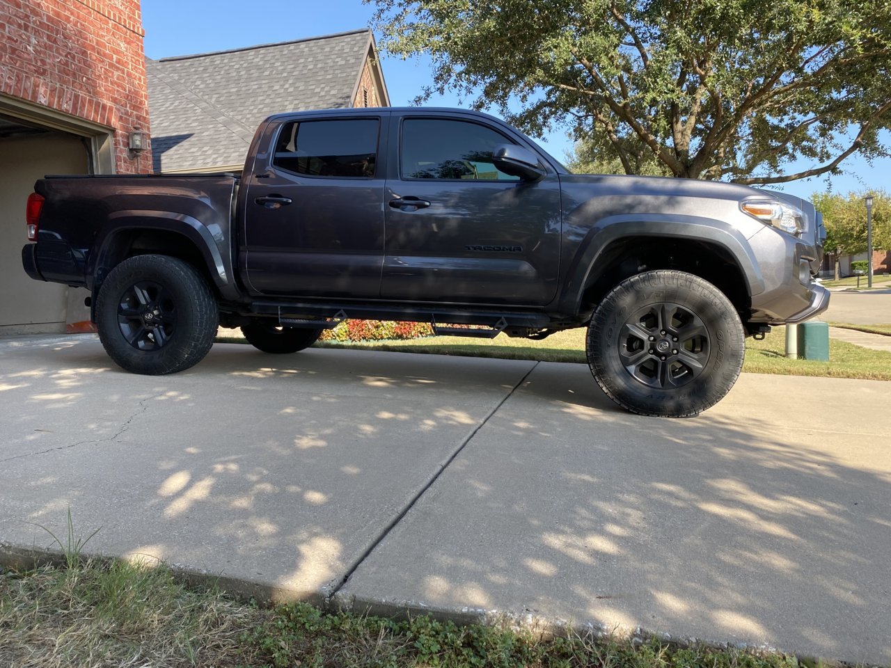

    Anyone else running these wheels on their 3G Tacoma? I'm curious what A/T tires can be run without rubbing, on stock 2021 TRD-OR suspension.

    Anything more than 265/70 will rub
    hiPSI and Taco2021LB like this.

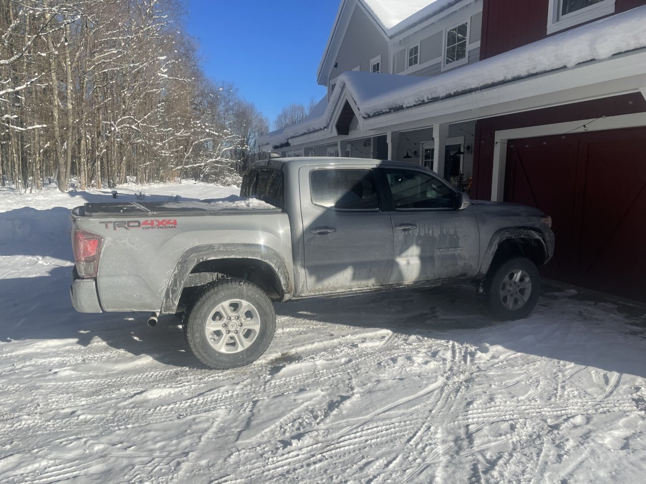

    I picked up a set of take offs brand new on eBay for 300 with free shipping. Was happy and now I used them for my 255 70 17 blizzaks. Truck has a 3 inch leveling kit. Might plasti dip them this summer.

    They look good on that color.
    Your truck doesn't look level to me.
    It may be the angle of the picture?
  14. Jan 24, 2021 at 10:31 AM
    greenmountain4x4
    greenmountain4x4 Active Member
    Nov 11, 2020
    #346472
    27
    2019 Tacoma OR
    The front sits higher I think the back may have sagged? Prob going to swap the 3 block to a 2 inch block in the front one of these days

    Mine is 2” lift in front 1” in back. 1.25” wheel spacers. No rubbing with Toyo A/T 285/70/17.
