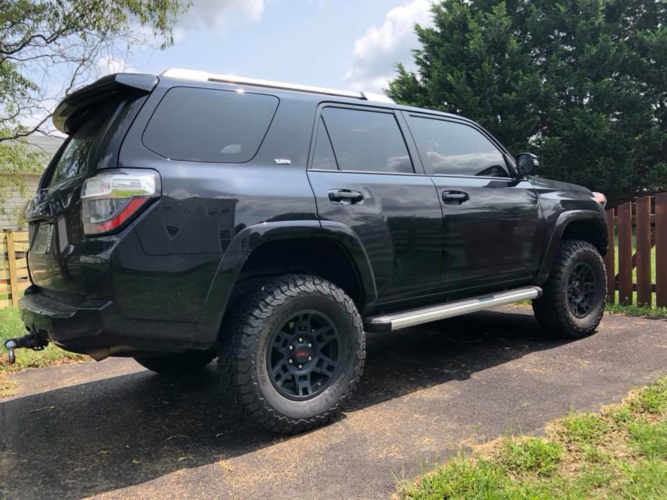

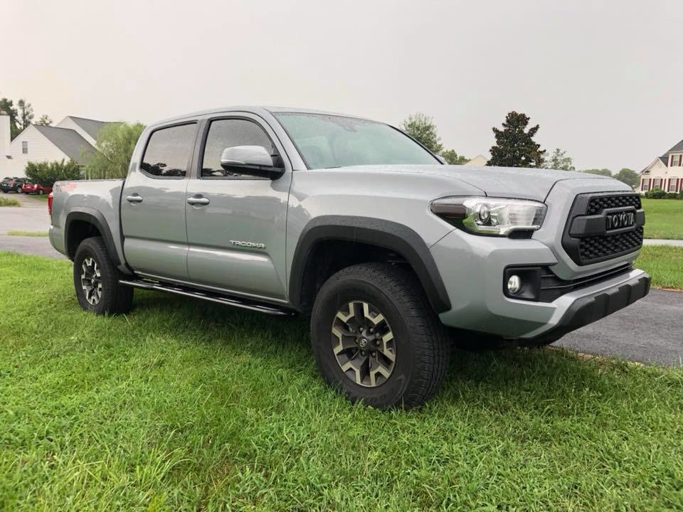

    I have a 5th Gen T4R (2016) and my Tacoma...
    wife drives the 4Runner and wants to change up the wheels and go w/ the SCS SR8s.
    My question is can I take her wheels / tires (OEM Sema TRD wheels and 285 BFG KO2s w/ OEM TPMS sensors) and put them on mine and just reset the TPMS system?
    and then use my factory sensors from my stock wheels on her new SR8s when they get mounted?
    I would like to avoid pulling the sensors out of her wheels, pulling the sensors out of my wheels, putting my sensors in her old wheels and putting her sensors in her new wheels and doing a 12 wheel shuffle.
