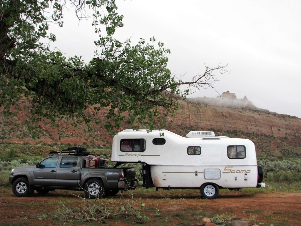

    Composite vs steel bed is not a factor and, while the Scamp isn't a true fifth wheel, the concept is the same. The two hitch towers are mounted to 6" wide by 3/8" thick flat stock plates which are fastened to the frame using the three stock bolts on each side of the bed. The Toyota dealer transferred this setup from the 05 to the 12 in the below photo when I traded without any questions being asked. FWIW, the camper goes around 3,500 lbs loaded, tows great and mpg is 12-13 running 65 +/-.
