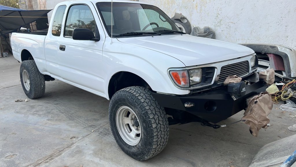

    Old guy here, this is my 96 in Cabo San Lucas just after paint last year, as small trucks go, this is the best I have ever owned, she looks like yours. Funny how they have the same pose... runway models I guess.

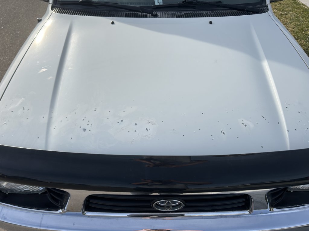

    I love it. Hoping to go over and re paint my hood/clean up some other small dings and suchIMG_2695 (1).jpg IMG_3258 (1).jpg
