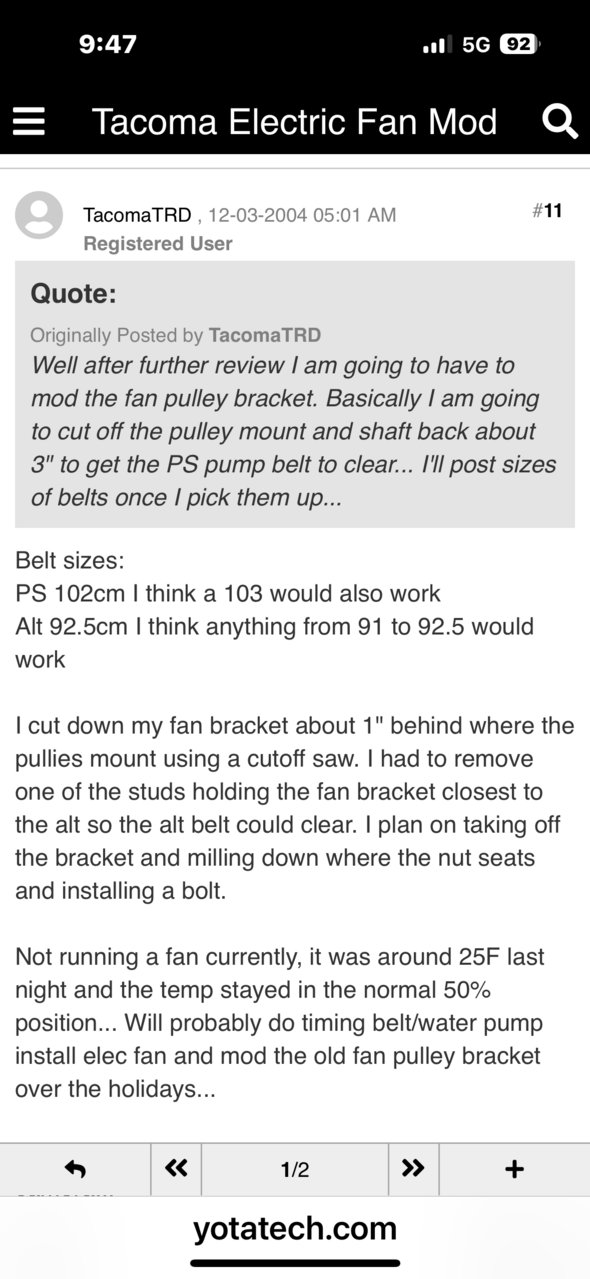

    I’m curious about the original question on simply removing the fan bracket and shorter belt. (I might use original bracket modified rather than build a cover.) Anyone done that? If so, what was the belt length or belt manufacturer & #?

    Great mod if you notice that your head gasket seals too well and you no longer want it to.

    DD1DF568-241B-438B-8B17-0C4E2C28750F.jpg Found this on YotaTech.
